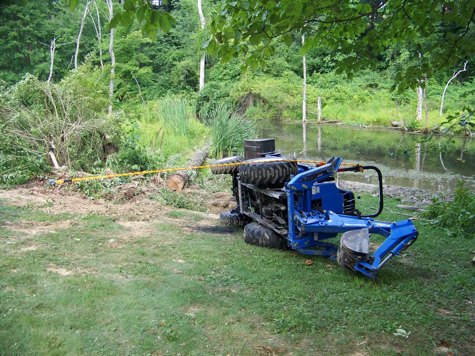

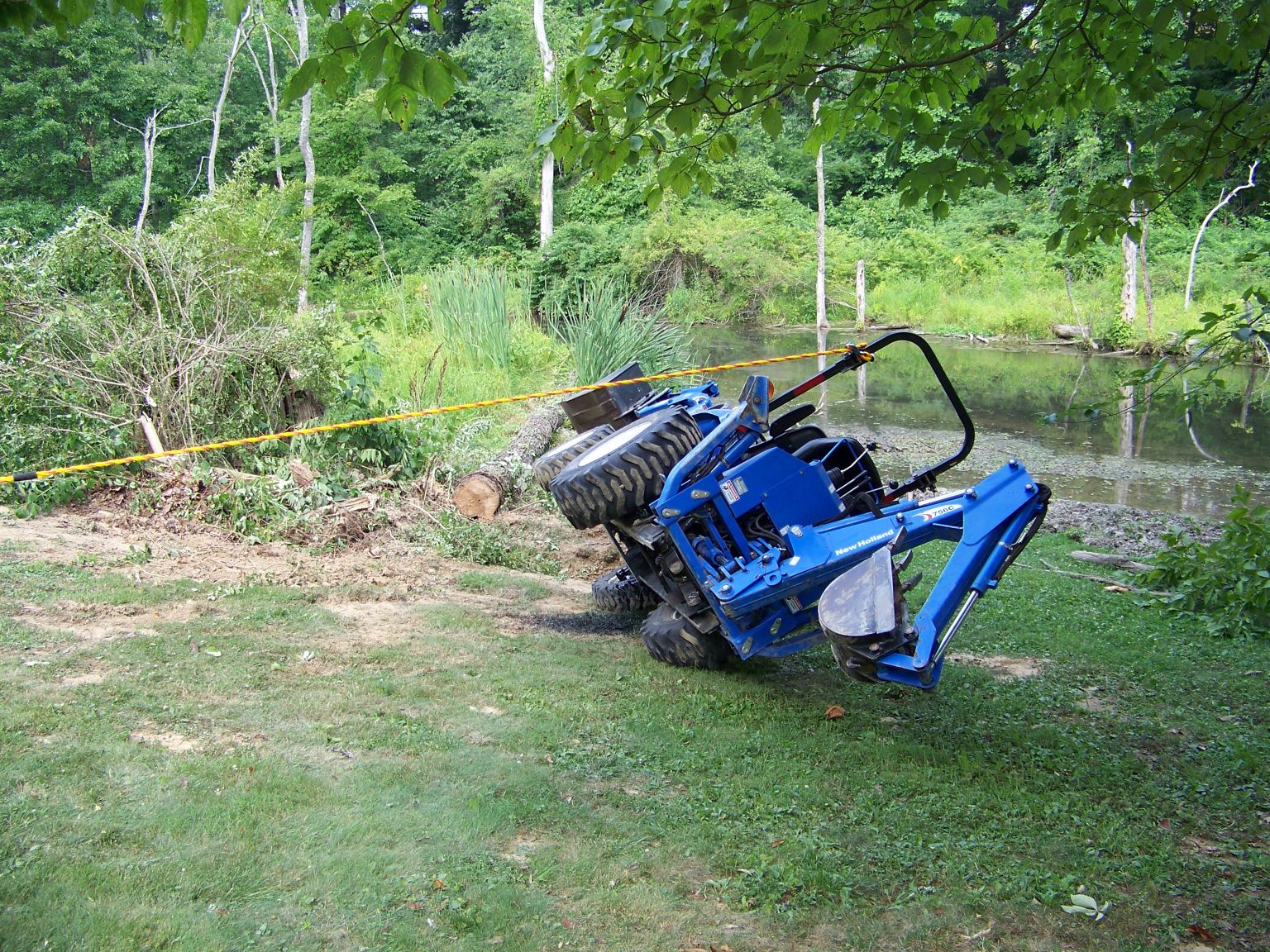

That is why you don't drag things with the FEL. The first pic shows the loader bucket about half way up. Even if the chain/cable was run under the bucket, that is still way to high. With the moment arm(point where Chain/cable applies force to the bucket) out past the front of the tractor, it takes very little bucket lift and turn angle to apply enough side force at the top of the loader arms to pull the tractor over. You could do the same thing dragging from the toplink while making a turn. Basically the top of the tractor stops, and the wheels pull the bottom of the tractor right out from under it untill the critical angle(CG past point where downhill tire is touching the ground) is reached and over she goes.
Don't feel bad, I am sure a lot of people here, myself included have had this or very nearly this happen to them. The only thing that saved me from a rollover was that I had my hand on the loader control lever and I mashed it all the way forward quickly as she started to tip. This bought me enough time to get the cluch mashed all the way to the floor and release the pull force. I was VERY lucky. Even with the backhoe in place, I can still reach the drawbar framework to hook a drag chain onto, and WON't drag anything from anyplace else.

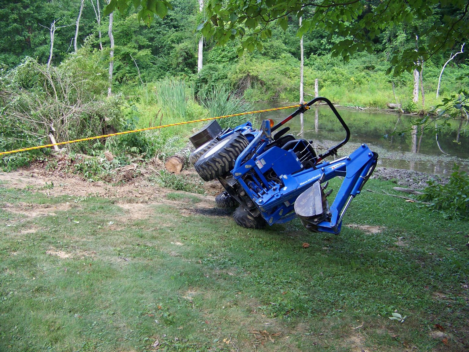

Mega Me: Sorry to see this situation, but happy to know you are OK! You must have had a firm grip on your beer to avoid a spill! I'm curious about the title, did you suspect this might happen?
Do you mind if I take a guess as to what happened? Looks like the tree you cut down, fell across the creek. (as you said). I'm guessing you chained the butt to one of your bucket hooks and started backing up.
However there is a slight rise in the ground and the tree butt kept snagging, so you simply raised the bucket as you backed up, lifting the butt a little.
Then, either you started turning on purpose, (or without noticing it) the tractor slowly got turned just enough (to put you on an angle to the pull) as you kept raising the bucket and the tree kept "lurching" ahead. The tree's final "lurch" pulled the "high" bucket (on sort of a sideways angle) and over she went!! Down with a bang! Pretty scary moment!!
Please let me know if this is a "fairly" accurate guess. Right or wrong I enjoy "trying" to figure things out from pictures. THINKING BACK, to the moment,...(as it began to tip),... do you think "dropping-the-bucket-fast" would have avoided the roll? (Dropping the bucket would have "let-go" what was pulling you over, AND set the weight back on the rear wheels and back-hoe). Providing my guess is correct?

You are a very intuiative intuitive person! This is pretty much what happened!
The good news is that myself and the tractor are all in fine shape! No damage sustained to the tractor what so ever.....not even a scratch! It did leak out a majority of the engine oil and about a gallon or so of hydro fluid. Since I had a screw up earlier in the week when I powerwashed it with the hydro fill cap gone, I needed to change the fluid and filters anyways. Fortunately I was able to get the ground cleaned up before there was an issue of oil/fuel getting into the pond.
I changed the engine and hydro oil and filters. This time I REPLACED the fill plug! :) I messed around the other night and racked up a fews hours on it and everything is fine! My leg is a bit sore still. And....just kidding about the beer but I definately had a few then a few more afterwards! Maybe if I had one or two before working this would not have had happened?

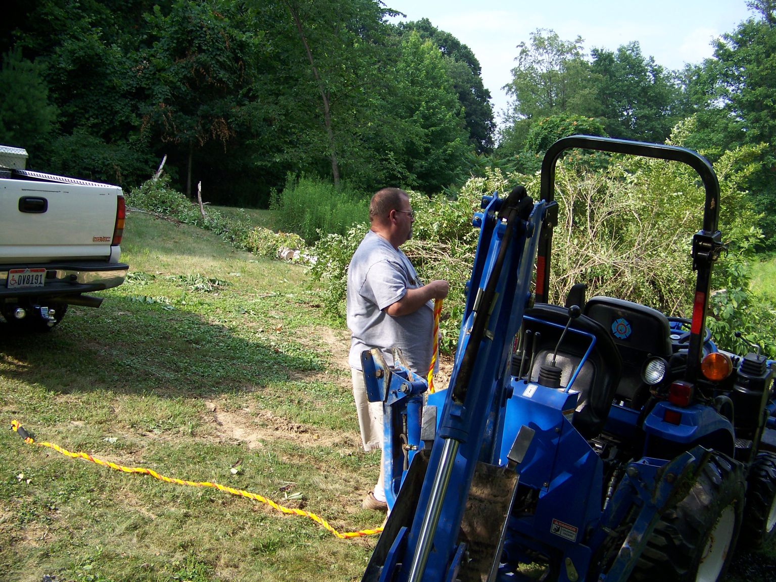

My mother happened to be mowing and witnessed the incident, which in turn she called for my step-father. Joe is a vietnam vet who was a operator of the infamous "rome plow". He was more than happy to come over the hill and help out.

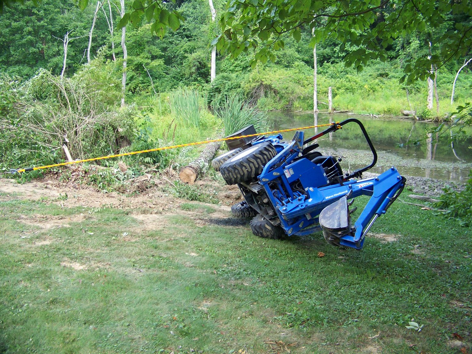

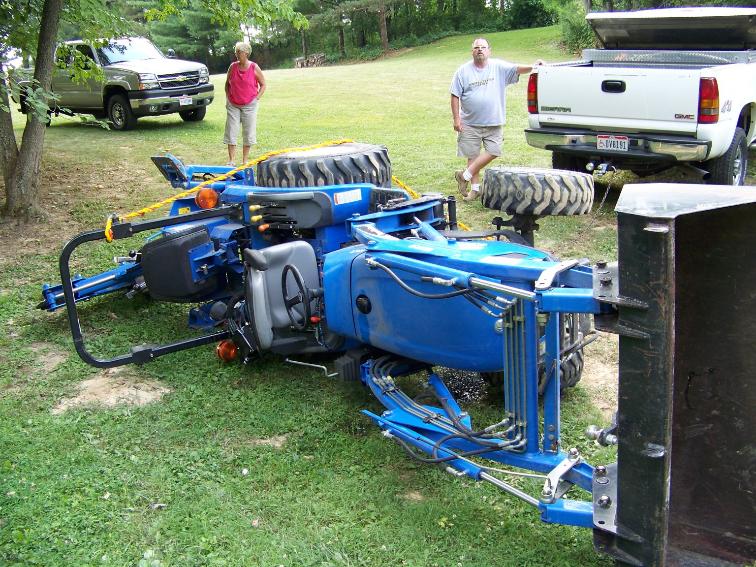

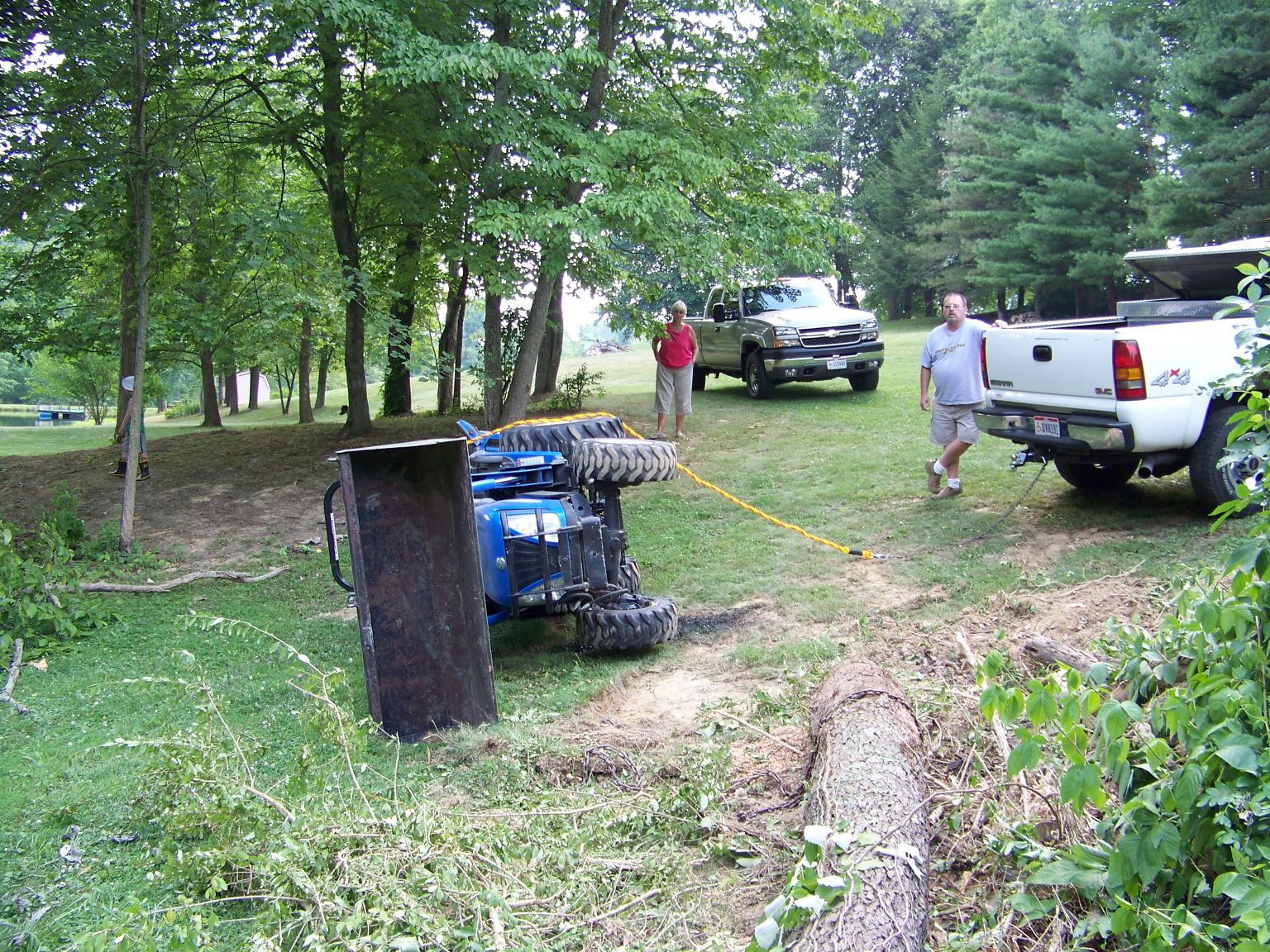

Pulling it over. We figured that if the ROPS was strong enough to hold it from rolling over, it would be strong enough to pull it back over. We were trying to avoid causing any damage that had not happened yet!

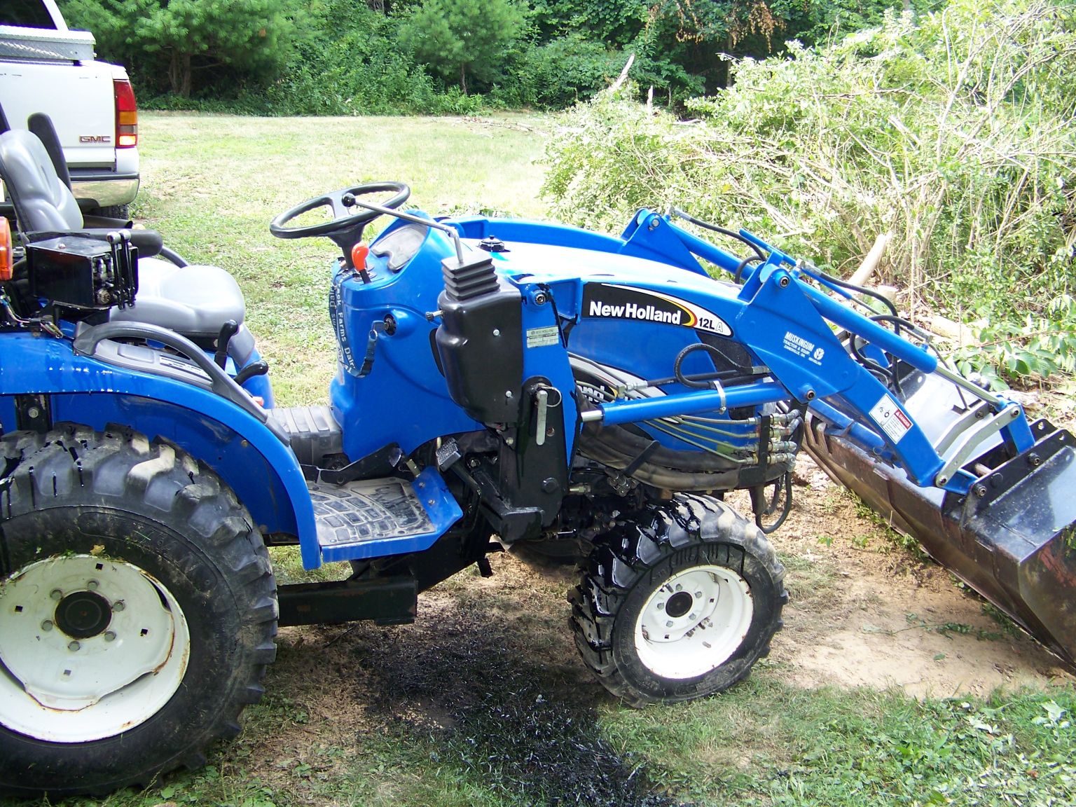

Things are getting back to normal.
