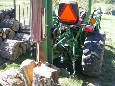

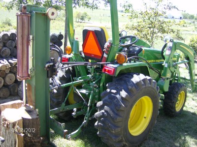

I built my own splitter several years ago to use the hydraulics on my 1958-JD 520, total cost, around $200. After selling the 520 & buying an '04-790, I added a "splitter valve" & long hoses to hook up to the loader bucket connections. Nearly doubled the total cost of the splitter! Tie off the joystick to the opposite fender & use the splitter valve.
It's not fast, but neither am I & I work alone, so it does what I need much cheaper than a stand alone unit. And, as stated earlier, very little maintenance! As for tractor usage, that's what I have it for & I won't put enough hours on it splitting wood to make any difference in the long run!
Not the system for everybody, but it works for me! ~~ grnspot
