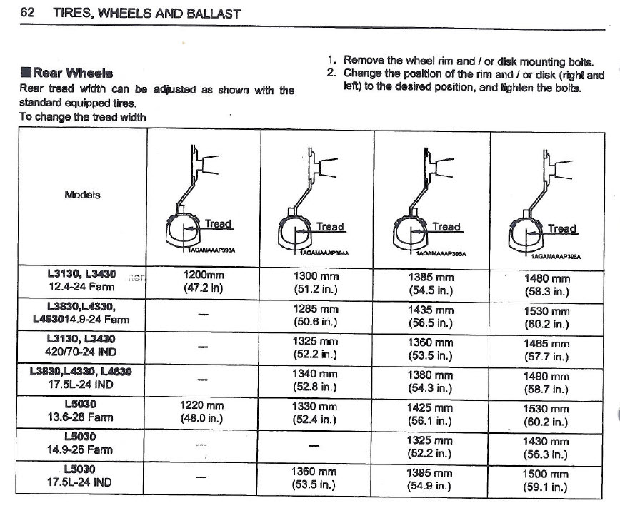

As best I can figure from looking at it and puzzling over it, that is what I will be doing. The center disc will stay put, but the rim/tire will be swapped side for side, and bolted up to the outer tabs you see in the photo.
Thanks for the help guys. Surprised the manual didn't show it any better than it does...
I took the simple approach and had my dealer put mine to the widest position prior to delivery, but I agree, the manual could be better and you really have to look at the manual then go out and look at the tractor while holding the manual. The manual then makes some sense or at least mine did; guessing they are all the same.

The only hitch I have in this is that I am not sure how well it will fit on my trailer if I set it wider than it is. I suspect it will fit, but will be very tight requiring a lot of fussing to line it up perfectly... so I may end up swapping it back in the spring...

I'd rather have a good idea of what I am doing before I start in on it.
Now you are in the 2nd setting at 51.2 inches... I wouldn't go to the last setting, (widest) unless you have a lot of clearance in gates and on trailers...
The 3rd setting should give you plenty of room for chains.. KennyV
