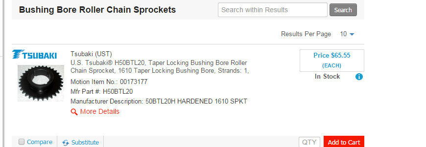

Tooth count is not so important, just something "small" for #40 or #50 roller chain.
References?
   / Source for 1-3/8 6 PTO direct mount chain sprocket #2
Yep, I couldn't find anything either.
May have to do some machining and welding on a shaft adapter.

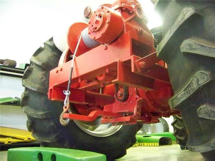

I'd think twice about running a sprocket directly off of the PTO shaft.
I'm assuming you intend to use the bearings that support the PTO stub shaft on the tractor to react the loads that the sprocket will see?
I 'm not sure those bearings weret designed to take much "overhung" reaction load like a sprocket, way out there at the end of the shaft, can deliver.
A lot of my concern depends on if your project will be pulling a lot of torque through that shaft.
If so, then consider mounting the sprocket to an independently supported shaft, as a tiller or brush hog do.
   / Source for 1-3/8 6 PTO direct mount chain sprocket #6
I have never seen a 6-spline sprocket configuration. And I have dealt with about every kind of sprocket imaginable. My concerns are the same as Baby Grands.
If you plan on direct driving off the PTO shaft, you are gonna want a frame and mounted bearing aft the sprocket to support the PTO shaft.
Better yet would be framework for whatever you are building, and drive the sprocket with a short PTO shaft.

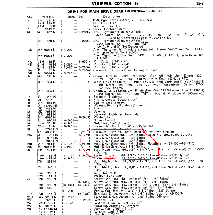

Years back JD 2 cylinder tractors had a chain driven implement lift that was powered by the tractors pto. JD cotton stripper was powered by sprocket & chain. Rd hay balers have some fairly decent loads transmitted from chains
