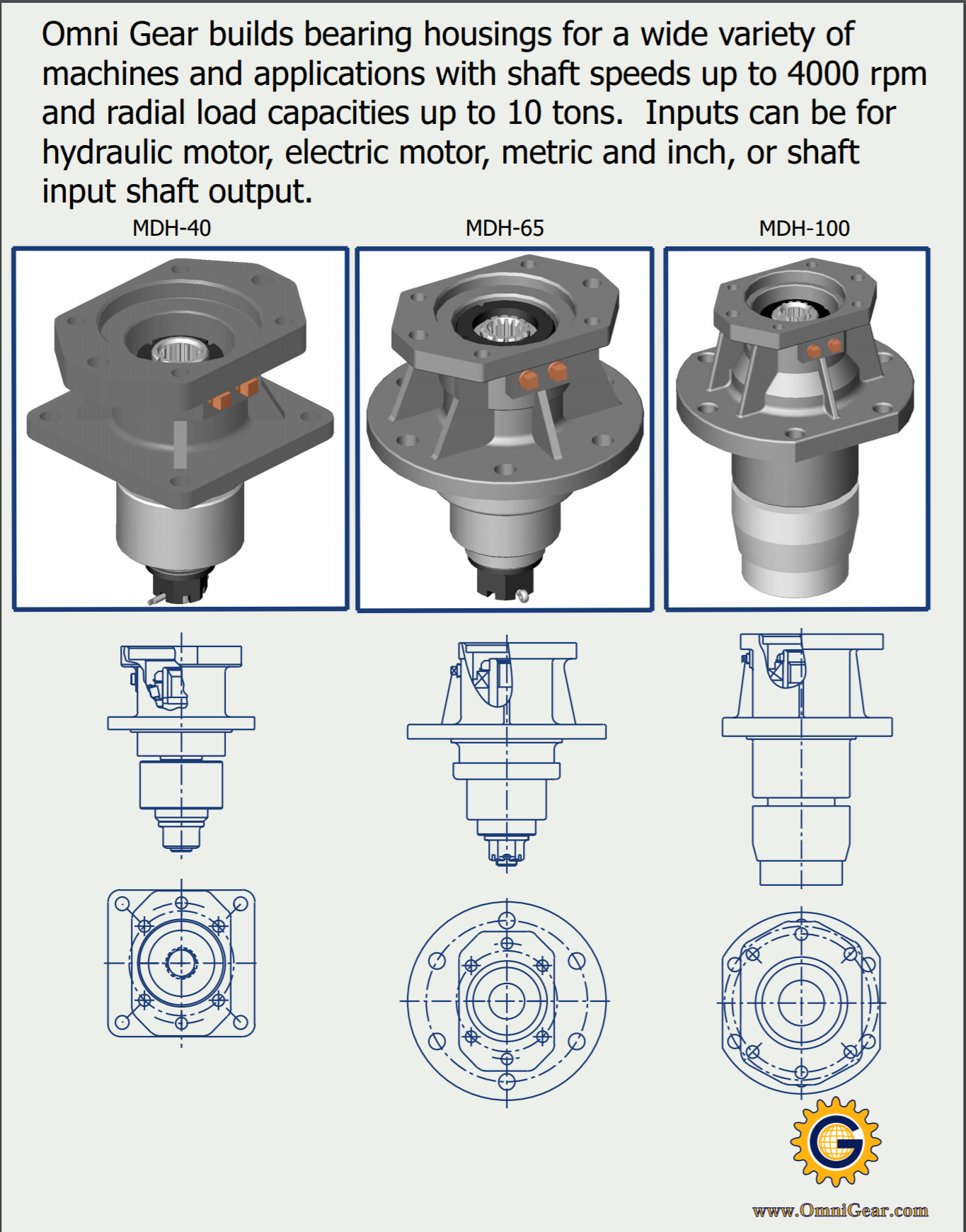

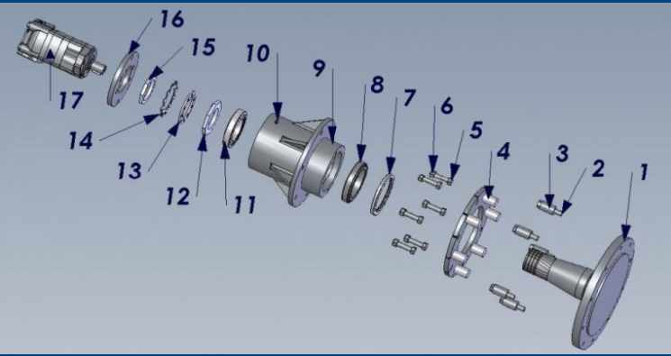

Hello -

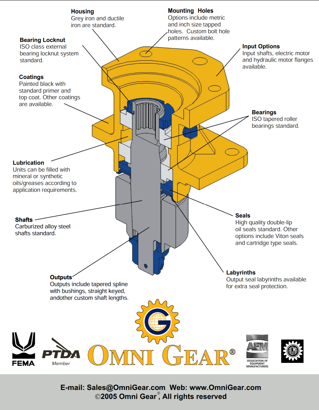

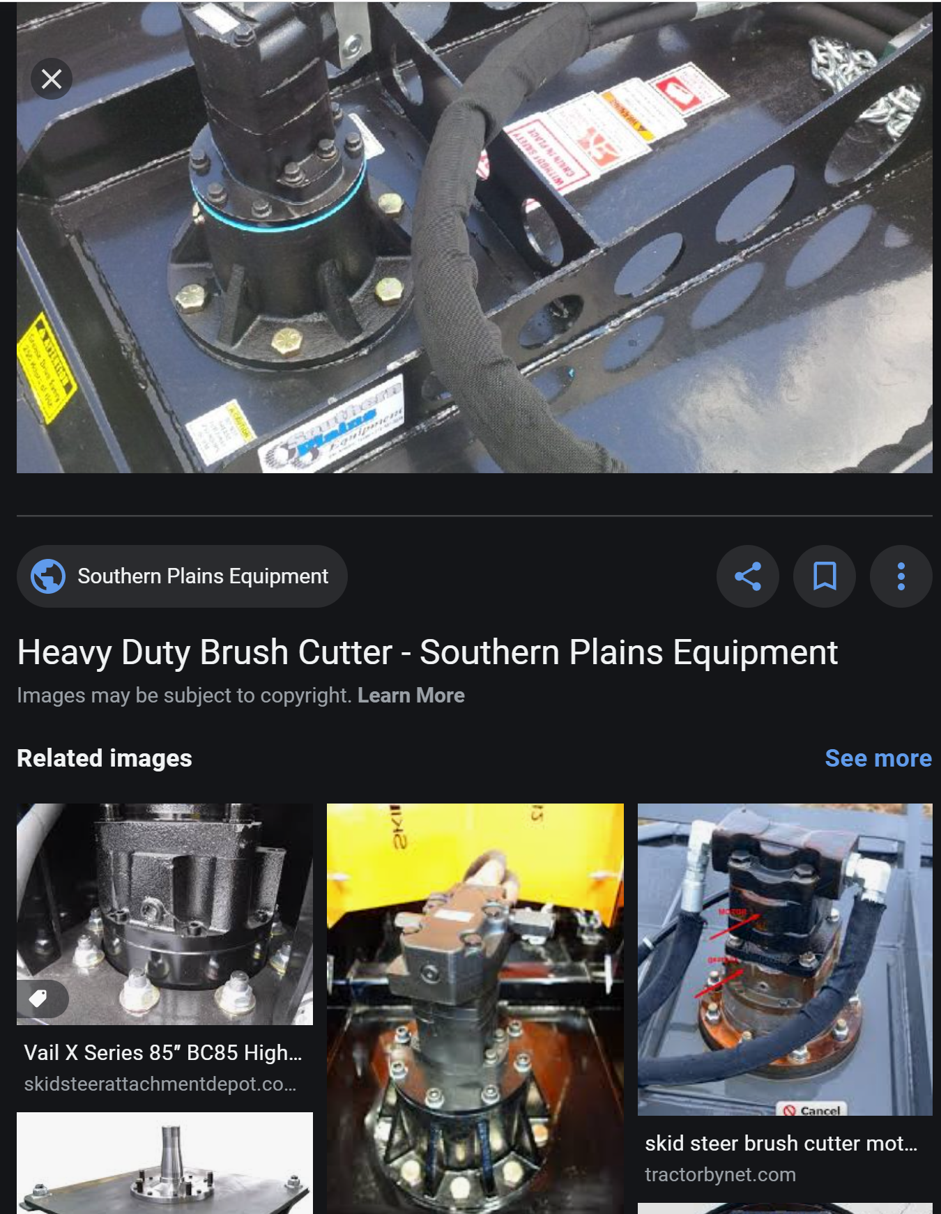

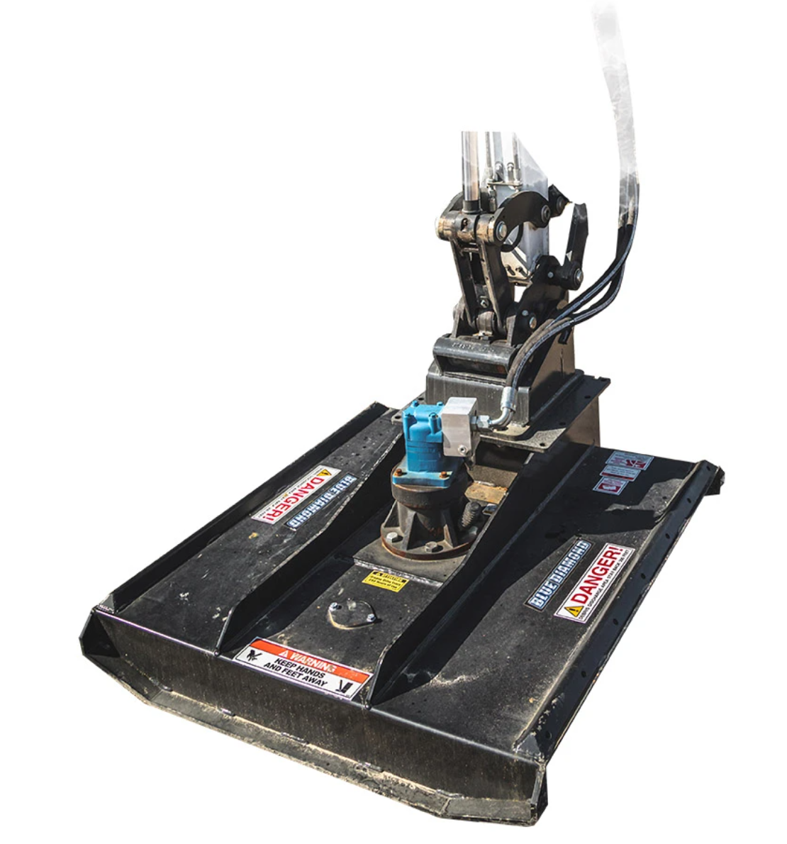

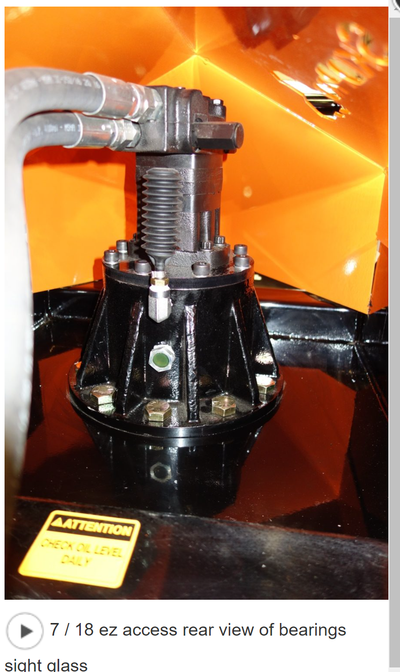

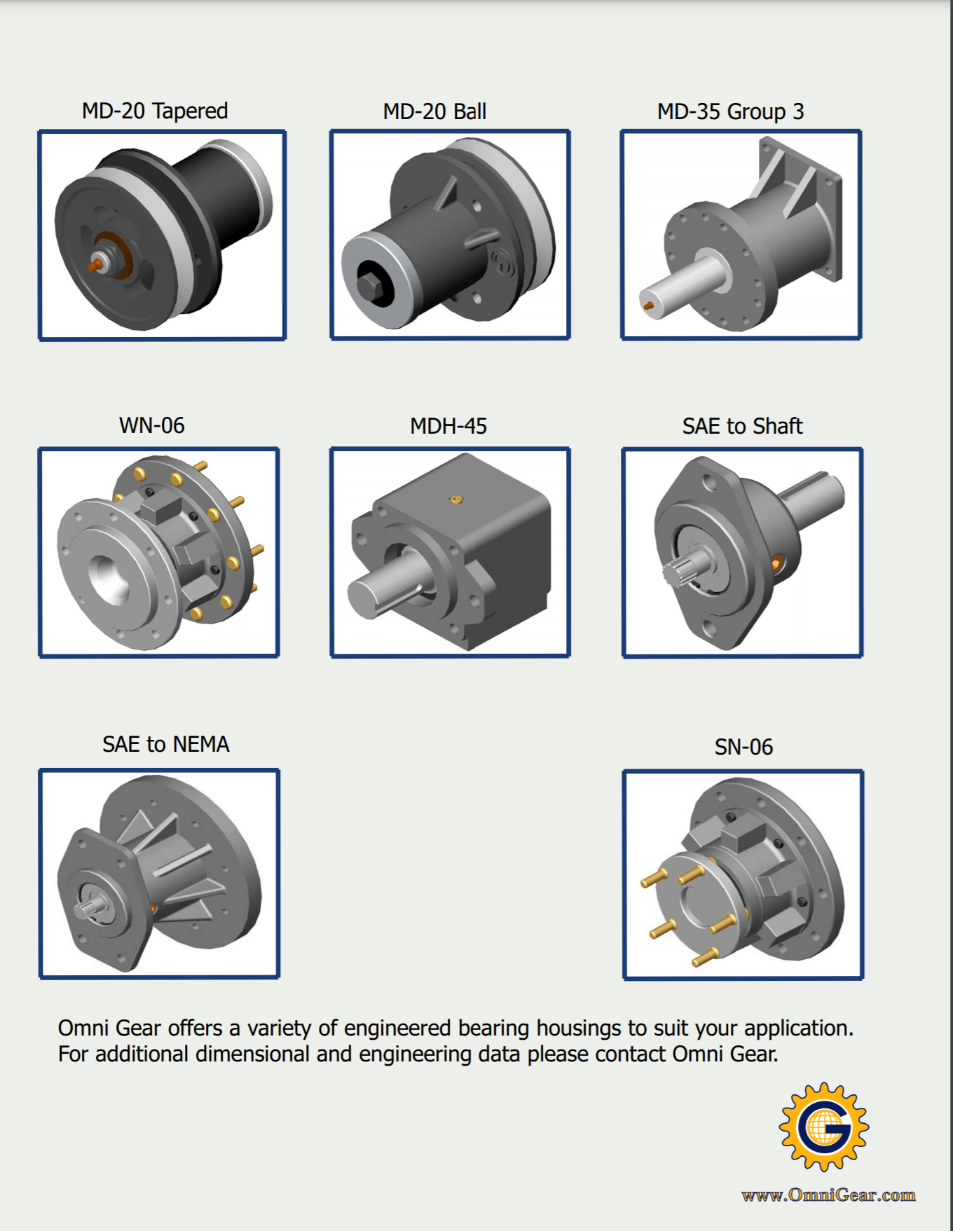

Apologies if this has already been answered (I wasn't able to find the answer using search or Google). I am trying to figure out where manufacturers of "direct drive" hydraulic motor driven skid steer/excavator brush cutters/shredders are sourcing the cast iron bearing housings for the spindle shafts/blade carriers. I attached a few screenshots of what I'm talking about. Many of the oil bath style housings I've seen look to be the same basic design, and I'm sure most are sourcing them from one of the gearbox manufacturers. Does anyone know which one? Or are they getting them from Eaton or one of the hydraulic motor manufacturers? It almost looks like it's some sort of modified trailer axle hub obviously with a custom spindle/blade carrier depending on the brand. I'm wanting to design and build a super duty mower of some sort for mowing under barbed wire fences that haven't been maintained. I've tried the Wright PTO driven fence mower and it works ok but I want to build one for a skid steer that can swing away from t-posts and run parallel to the fence so you don't have to twist around looking behind you all day. I'm kind of a DIY guy. Thanks for any information.
