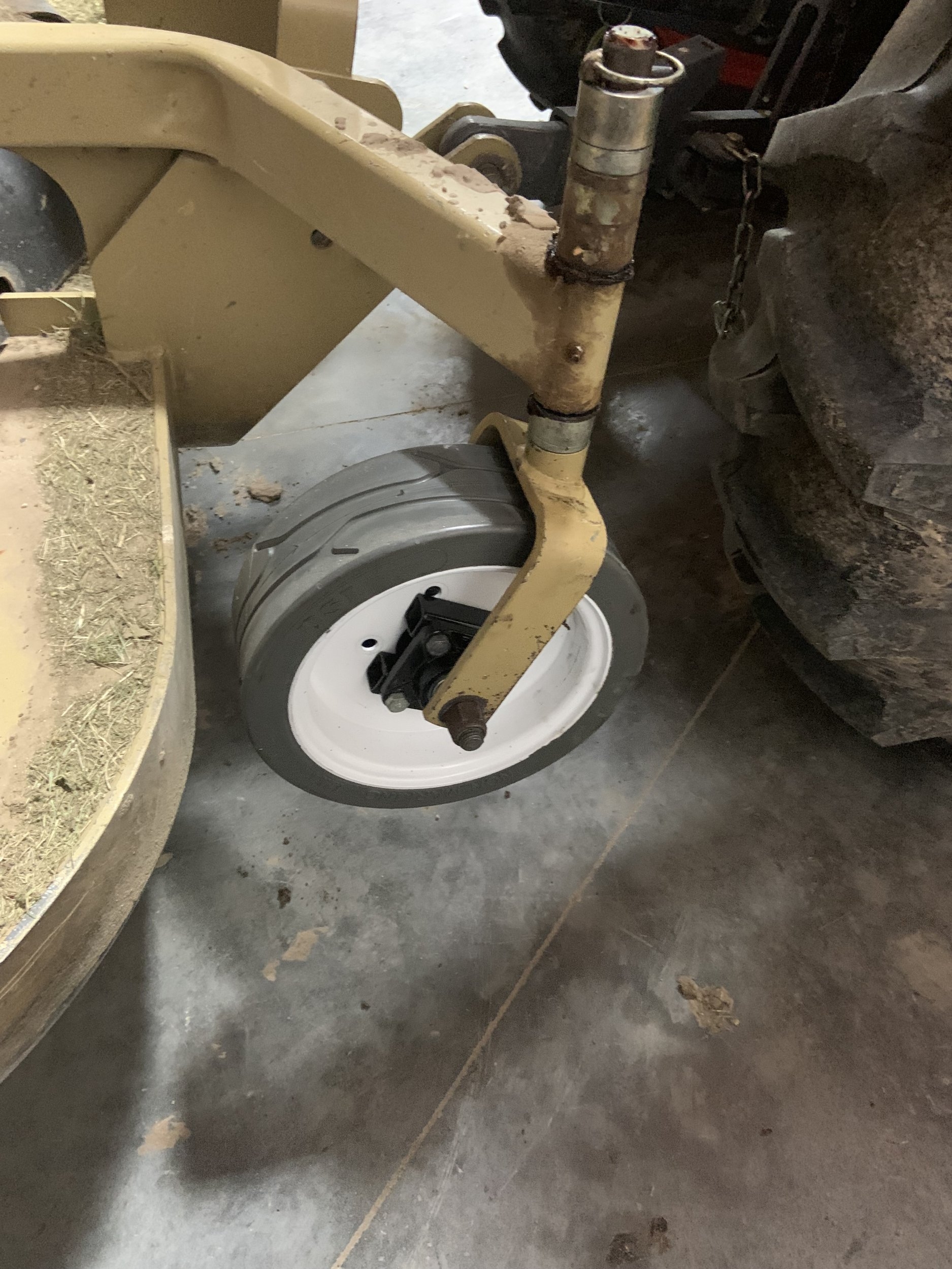

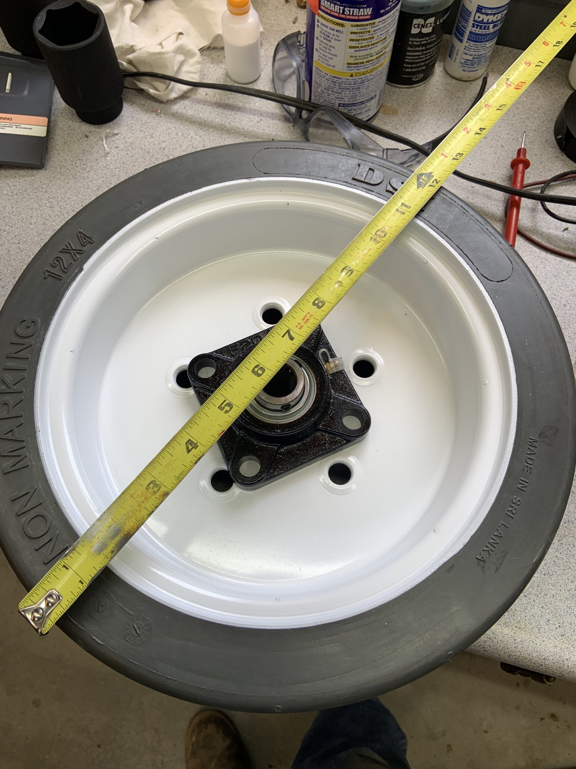

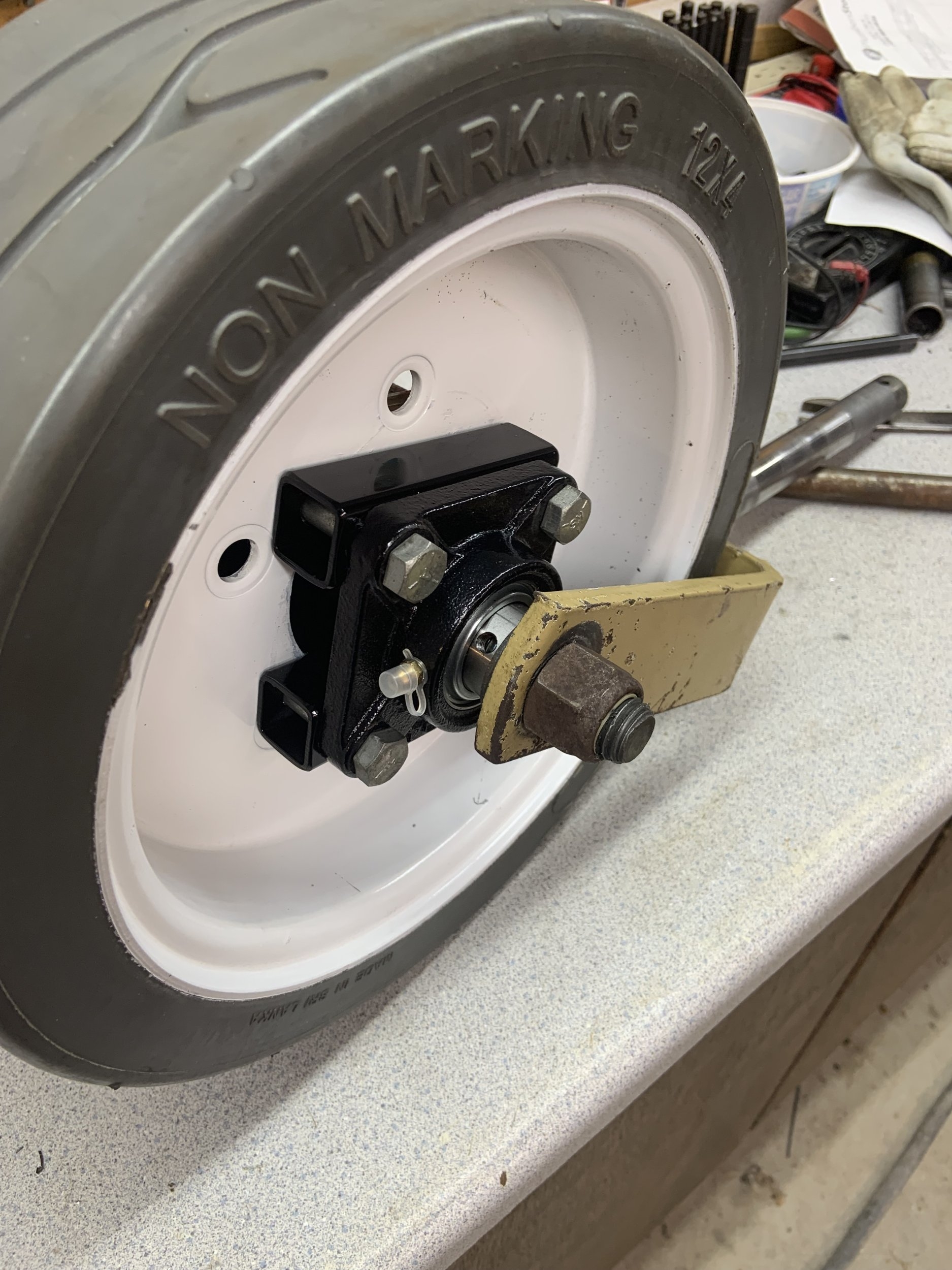

I was having the same problem on my Landpride 84” finish mower and this is what I came up with.
they are tires off of a man lift I bought them on eBay.
working good so far.
