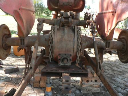

A couple of weeks ago a friend told me about a very sad old MF 35 in a farmers shed, Ive been looking for an affordable tractor for ages, so after a bit of scraping, and making sure it was a model with available spares I brought it home on Monday.
The engine had seized, but apparently the back end, gear box and hydraulics are OK, It has the 3 cylinder Perkins, single clutch, serial No 298833, so looks like its a 62 model.
There are quite a lot of issues to work on, Im going to get it up to a good running condition, not necessarily show room, as it has to work for a living.

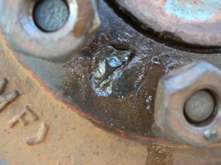

Problem No 1, getting the brake drums off, someone got angry.
The engine was in pieces, and kept in a box, the crank shaft is quite badly scored, pistons and sleeves arent great, but the rest looks Ok. Ive sent it in to a good engineering co to get a quote on a rebuild.
Today Im going to fight with the brake drum, There is an oil leak out of the right rear axle. Is it possible to weld a nut onto the screw?

Hi Zimbo,
Yes it is possible to weld a nut to that damaged screw. I would clean it up good and then set an undersized nut, that is a nut with a smaller diameter than the screw head, on top of the screw. Make sure the nut is centered on the screw and carefully weld the inside of the nut to the screw as you might for a plug weld. The idea of using an undersized nut is that you don't want to inadvertently weld the screw to the tractor. Since the screw head is thin at the edges you'll have to be careful not to penetrate too deep. Also, soak the screw with penetrating oil for a few days before trying this to give yourself the best shot at success. You might have to repeat the process several times and don't give up if you break the nut off, just get a new nut and try again, you'll get it. The welding heats the screw and the repeated heat and oil soaks will eventually work. I think there are videos of this method on youtube. HTH!
