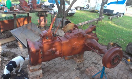

Just a few pics,
the hanging tree
Engine should be going on tomorrow. Ive found the best way to see where everything goes is to look at a running one, and figure out what Im missing!
Next project is the oil lines outside the block, I didn't know they were there until this afternoon, and every tractor I look at has them going into different places!

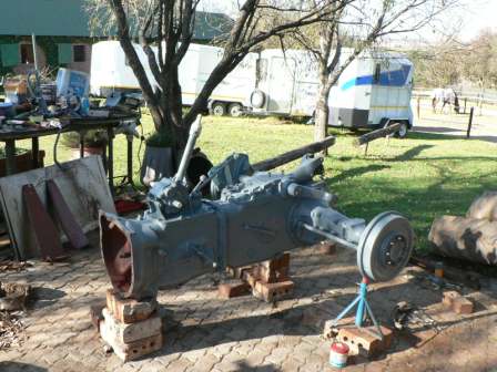

#14
engine went back on yesterday, My only complaint is the engineering shop painted it, and went a bit wild with the spray gun! now I have grey everywhere, and I was hoping to keep some bits as their original colour - like the alternator, fuel pipes, fan blade etc. Oh well, no use complaining!
It will be time to add some red bits soon!
