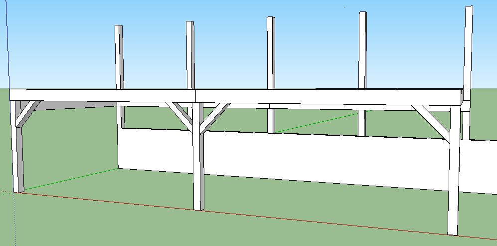

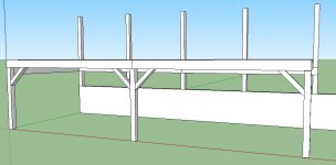

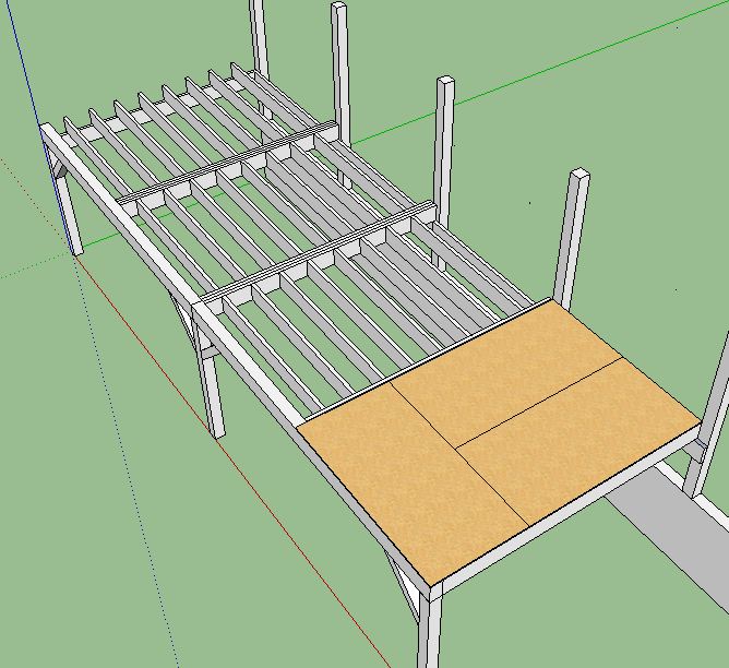

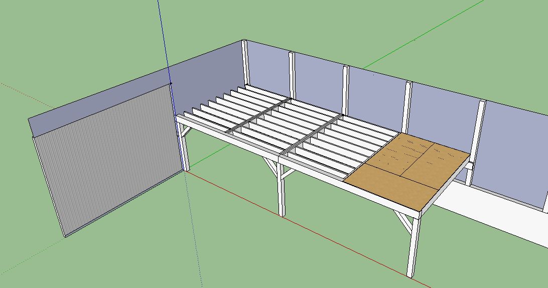

Here's a Sketchup design I drew up tonight for the proposed loft. The long beams with 45 degree braces are double 3x10x16. The beams that run perpendicular are triple 2x10x12 #1 graded pine. The joists are 2x10x8 #2 on 16" centers. Support posts are 6x6 PT.
Normally the joists would just tie into the main beam perpendicularly, but I'm trying to make use of lumber that's left over from other projects. The triple 2x10 beams and 8' joists are free, versus buying 2-2x12's and a bunch of 2x8x12's for example.
From my calculations and various span tables, everything is stronger than required except the 3x10 members, which are right on the line. It will probably have a 3/4 plywood strip laminated between the two beams to add to the safety factor, along with the 45 degree braces.
There's a 10'x54' loft on the opposite side of the barn that was built with triple 2x10 beams spanning 12', with 2x8 joists placed on top of the beam and ledger boards, rather hung off the beam and secured with hangers. Joist on top is cheaper and easier, but it makes a thick floor and my ancient forklift can barely reach the top. Plus it will give me about 7" more headroom upstairs.
The new loft is mainly for storing body parts, bulky boxed items, a Triumph TR3 in pieces :) and won't see large point loads like engines or pallet racking.

Good drawings, that makes it a lot more clear. So the joists are holding the floor, the 12' beams are supporting the joists, the side poles and the 16' beams are holding the 12' beams, and the two new posts and one existing posts are holding the 16' beams.
The rule is when a beam is supported at two ends you assume each end takes half the load. So the three 12' beams in the middle are each holding up 1/4 of the floor and the two at the ends each have 1/8. The wall poles that support one end of the 12' beams will each take half of the load, so 1/16 for the end poles and 1/8 for the middle. For the 16' beams, only the load from the middle 12' beams is carried -- the rest goes directly onto the poles. So the load on the 16' beams is 1/8 of the floor. The middle new pole carries 1/4 of the floor and the end poles carry 1/8 each.
The total floor is 12 sheets of plywood or 384 SF. At 40 lbs/SF (pretty sturdy) that's 15,360 lbs for the whole thing. The load on each component is:
Middle 12' beams (1/4): 3840
End 12' beams (1/8):1920
Middle wall poles(1/8):1920
End wall poles(1/16): 960
16' beams(1/8):1920
Middle new pole(1/4): 3840
End new pole(1/8): 1920
That all looks pretty reasonable. I think you'll need some sort of footing for the new poles.
