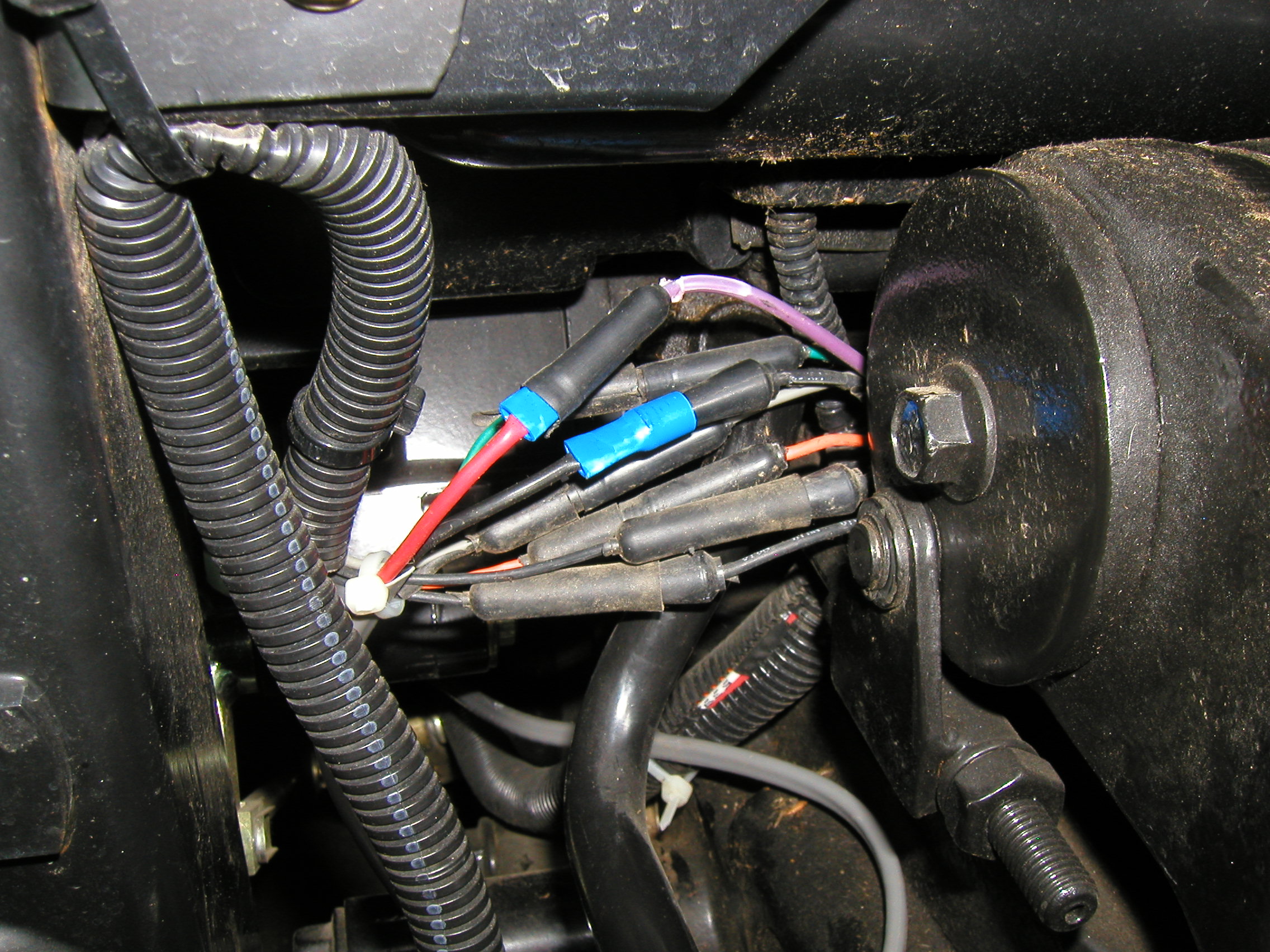

Fuse f5 protects 562c red wire. Should be a 20a fuse left side 2nd one down. The purple and black on the right side are for the right work light. You should be able to connect with bullet connectors and mount. The light switch should control it

From reviewing the thread I linked to, I believe I found out that plug on the back is for a back-up alarm.
Thanks, do you know what that red wire is for? and what else is on that f5 circuit?

I think deere put it there for a easy way to get 12v, because it shows nothing hooked to it on diagram. As for fuse f5. It would take lots of time to track all possible connections. Yes there is something on the circuit besides the lead. The circuit 562 red starts at 562a red and changes at each connection as it goes down the alphabet. I found connection all the way down to 562p red. It seems to be a major feed of 12v to the switches. I am not sure if all go back to f5 fuse. I would guess it does.

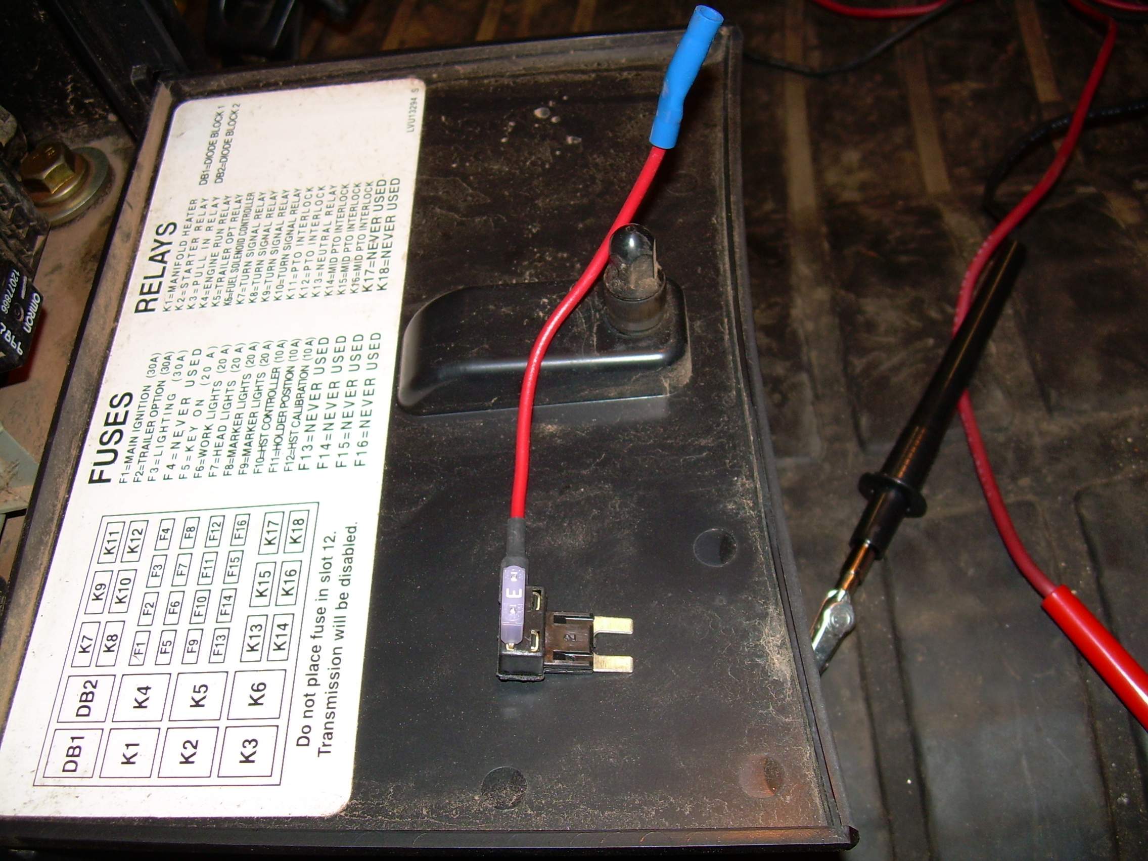

OK thanks, if there's other things on that circuit I'd be reluctant to run a dc outlet off that wire.
I ran mine off a light circuit, forget which one but it uses a piggyback fuse thingamajig where it doesn't over load the existing fuse but splits the socket through 2 fuses.
JB.

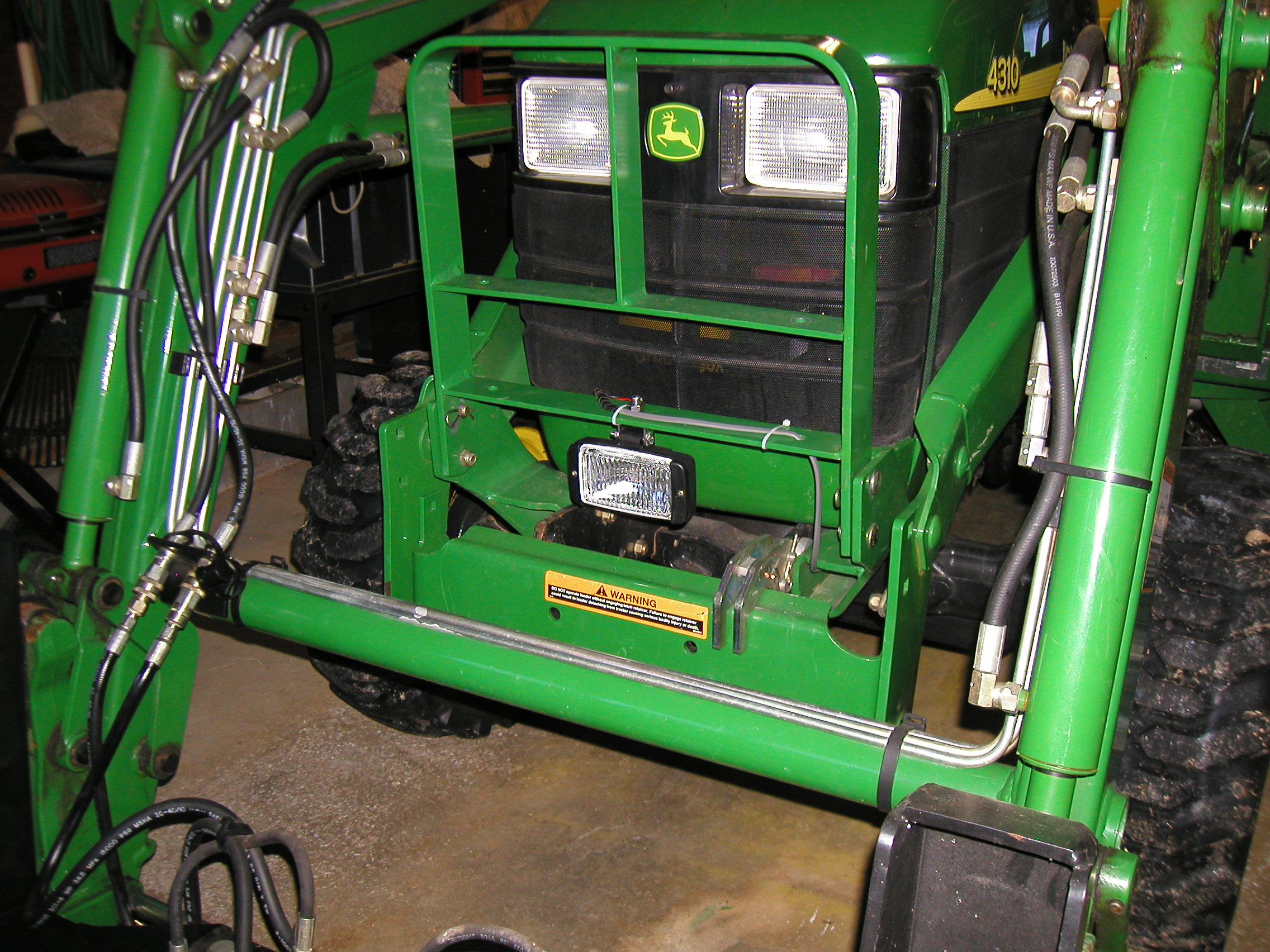

Here's what I ended up doing.
Added a rectangular Peterson's Mfg. light to the brush/grill guard.
It took about 10' of cable to reach the rear spare terminals. Wire tied cable to existing wiring harness.
Covers the area ahead when plow is up.
Light comes on third position on switch on the 4310.
This was too easy. Still thinking about what to hook up to the hot lead by the clutch pedal.

Looks good, I wonder if that red wire may of been for hydros like mine with brakes on that side, to be used for optional brake lights.
It's kinda odd, an always hot wire being out of the harness like that.
