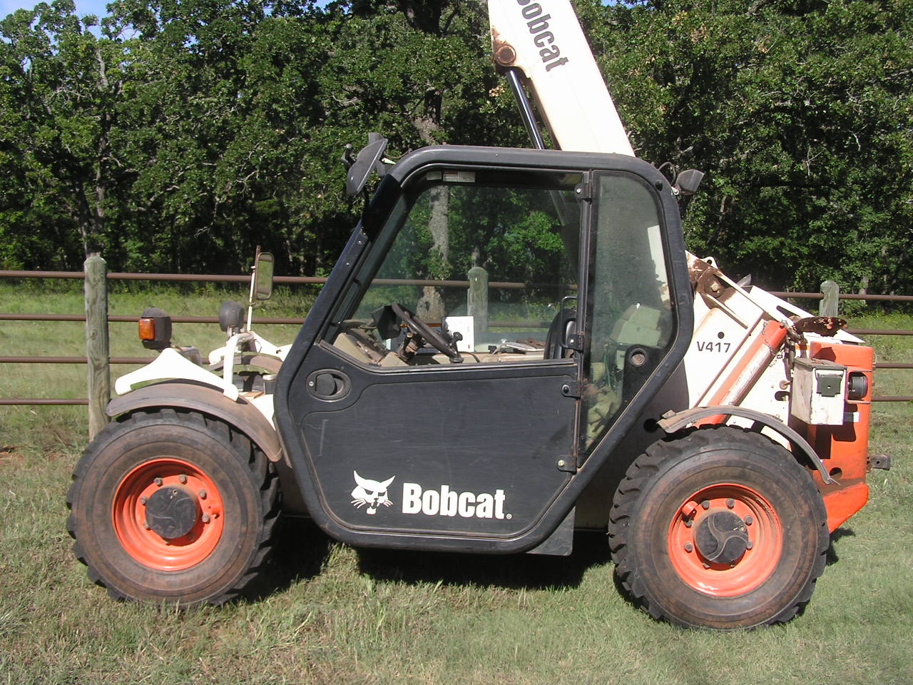

Key related question: Is there just one key for the ignition and cab doors? I can't get my right door to unlock (it opens from the inside but not outside).

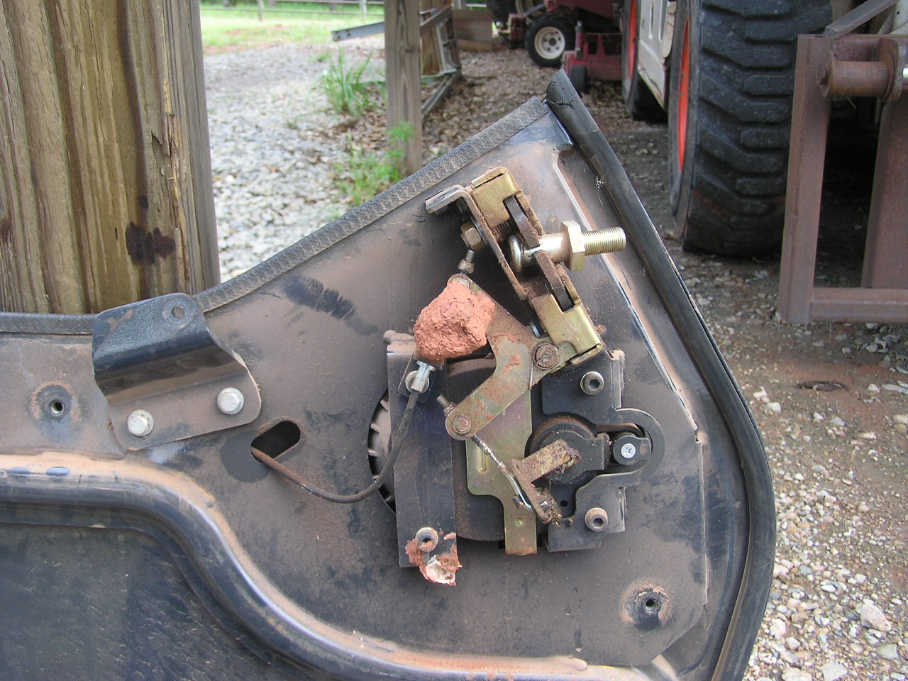

Probably not your problem, because I could not even open the door on my Versahandler. Luckily the top half of the door had been removed several years ago, was able to reach in and unscrew the nut holding the striker pin.
Removed the door and the inside cover. Found a large dirt dauber nest was preventing the the latch from working. :eek:
