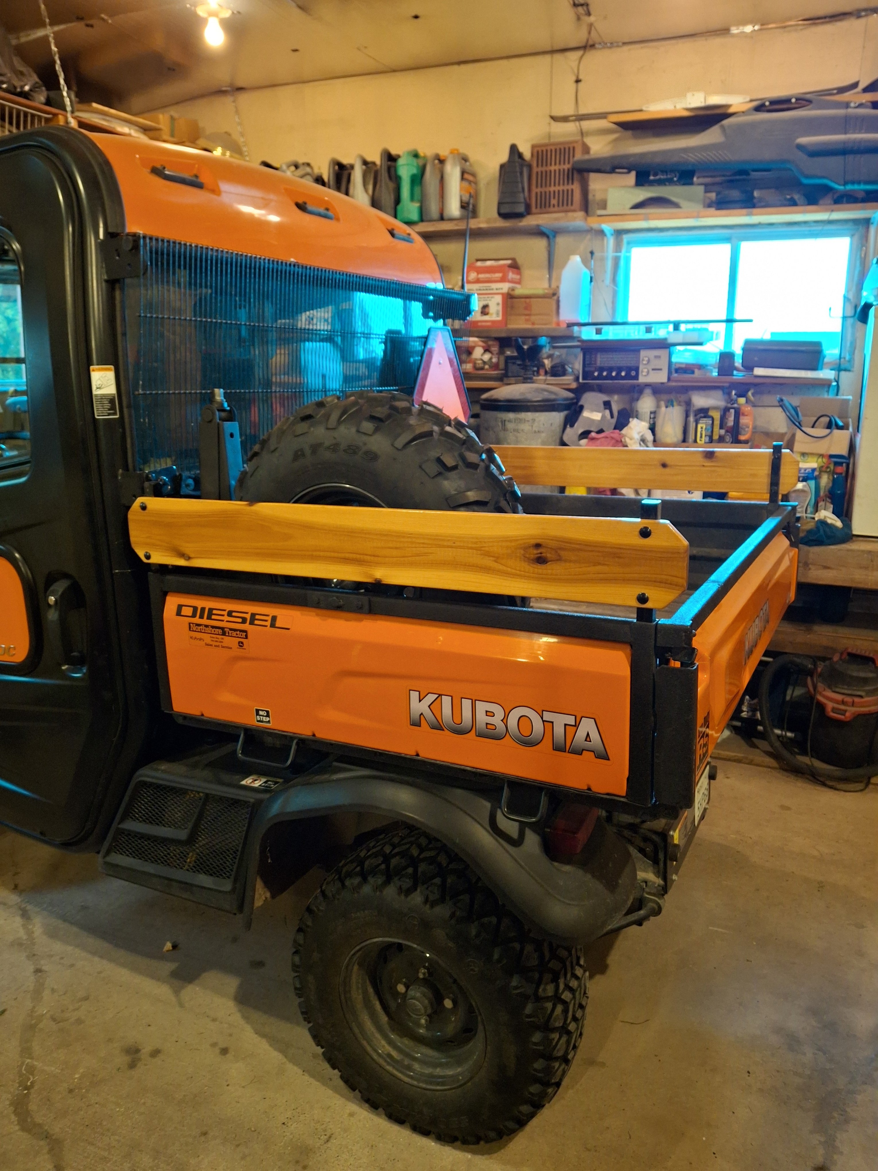

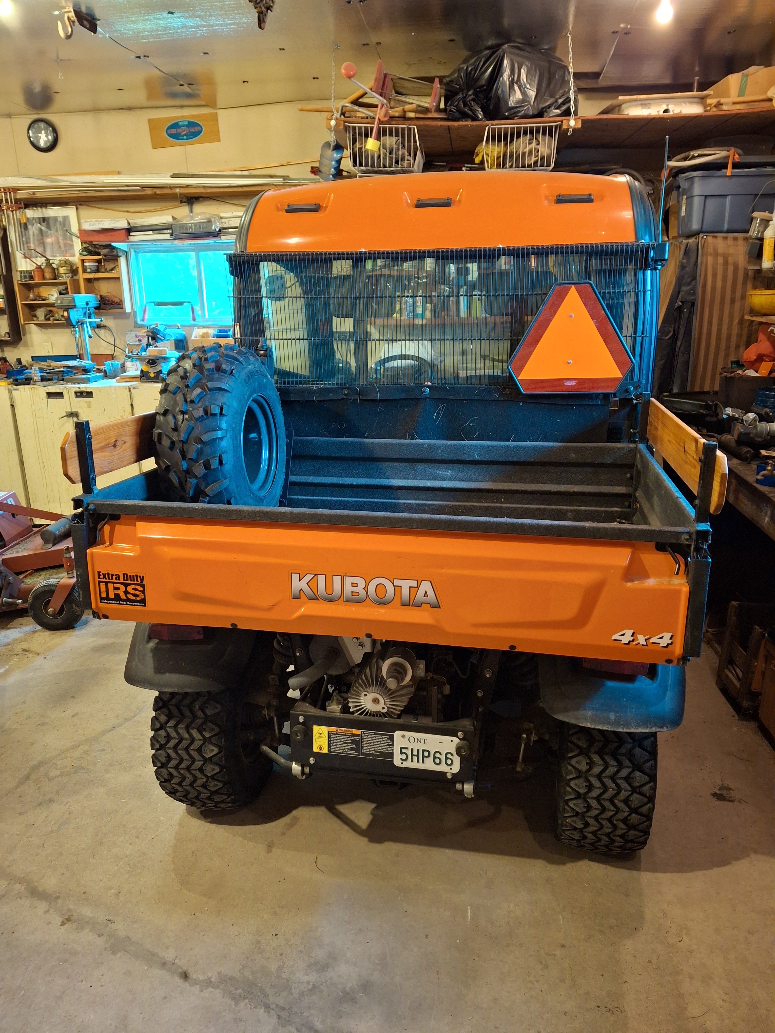

So this fall for bird hunting season we annually ussually go 20 or 30 miles deep into bush in Northern Ontario with relatives and our side by sides.. ( no cell coverage either) I was worried about a side wall flat tire occuring on sharp rocks we traverse across often. So I located a spare Kubota RTV rim from dealer and bought a tire from Princess Auto , and I had a extra scissor jack from my Shasta camper. So by using a reinforcement steel plate
1 " x 6 " 1/4 " drilled and bolted thru side of box, and rim held by one 6 inch long bolt, and also mounted scissor jack with a few wing nut bolts ( after grand daughter helped spray paint black) .....worked out great. If I don't say so myself ;)

I like your sideboards Wawajake! Those look nice!
Well my RTV is no longer going to be a trail riding machine. I just ordered the K-Connect and snow blower for it and dealer is buying my Boss vee plow off it.
   / Spare tire mount for my RTV . #6
I echo @Paystar comment. Those are fabulous sideboards gonna make me some. Did you fabricate the steel or did you find the tube stock for the RTV? I find it harder to find accessories for my RTVX 1100 c than for my polarises. currently looking for new aggressive tires with rims
Thanks.....Sorry did not reply right away, ( wife passed away end of Nov , so missed post) .....the rtv side boards are cedar fence boards, sanded and varathaned, the uprights are maple wood cut to size to fit tight in Rtv sq stock that is part of box, painted flat black to match.
