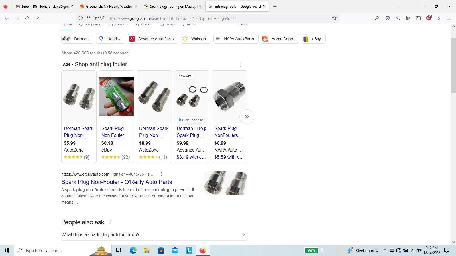

If all else fails;
   / Spark plugs fouling on Massey Ferguson MF 35 petrol gasoline 87mm Standard engine #12
