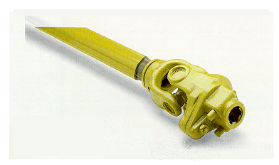

There is a driveline protection commonly called an inline shear bolt. Most inline and slip clutch drivelines are splined on both ends. If your inline shaft has the shear bolt at the tractor end, it needs to be reversed. The point of driveline protection is not to protect from the forces coming from the tractor, it is to protect the driveline from forces coming from the implement. In the case of a rotary cutter, the sudden shock of hitting something unexpected and bringing all that rotating mass to a sudden stop. Placing the driveline protection at the tractor end normally results in twisted PTO's.
John, I'll try to find the picture of an inline shear bolt and attach it.
   / speaking of a slip clutch, #19
Found it. The picture shows the driveline without the shiedling in place. Of course, they are supplied with shielding installed and it should always be used.
This device prevents overloading by means of a shear bolt of specified size. When the bolt shears off, the hub and yoke assembly is kept together by a ball bearing ring which allows the two parts to rotate independent of each other. It is mounted on the implement side.
Advantages are that it is much easier to inspect and change out when it shears. Disadvantage is the cost is approximately $10 more. Don't look for this in price sensitive applications such as light duty cutters.

Thanks Jim for the pix... I've seen the ones Bondioli has made but for higher horsepower units and <font color="blue"> "It is mounted on the implement side... </font> as we've both already stated... (probably used more in Europe than the U.S. I imagine...)
