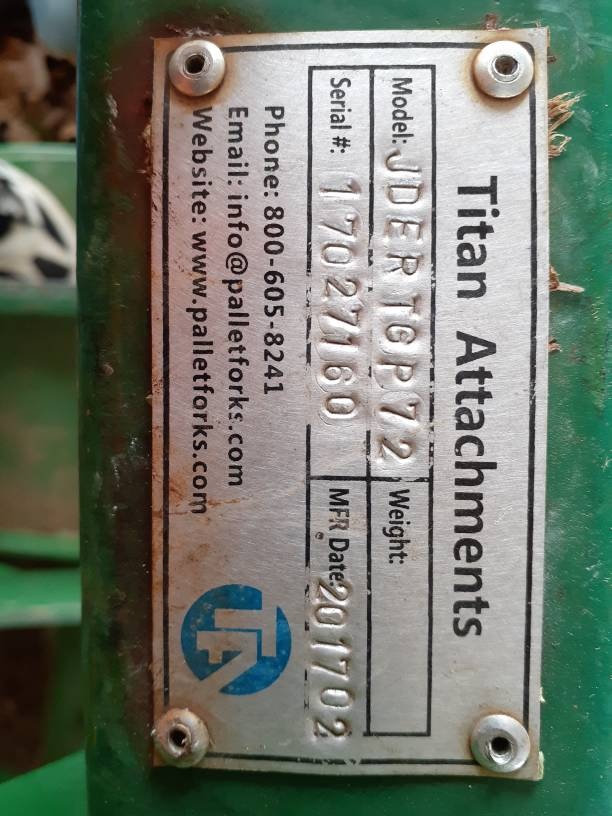

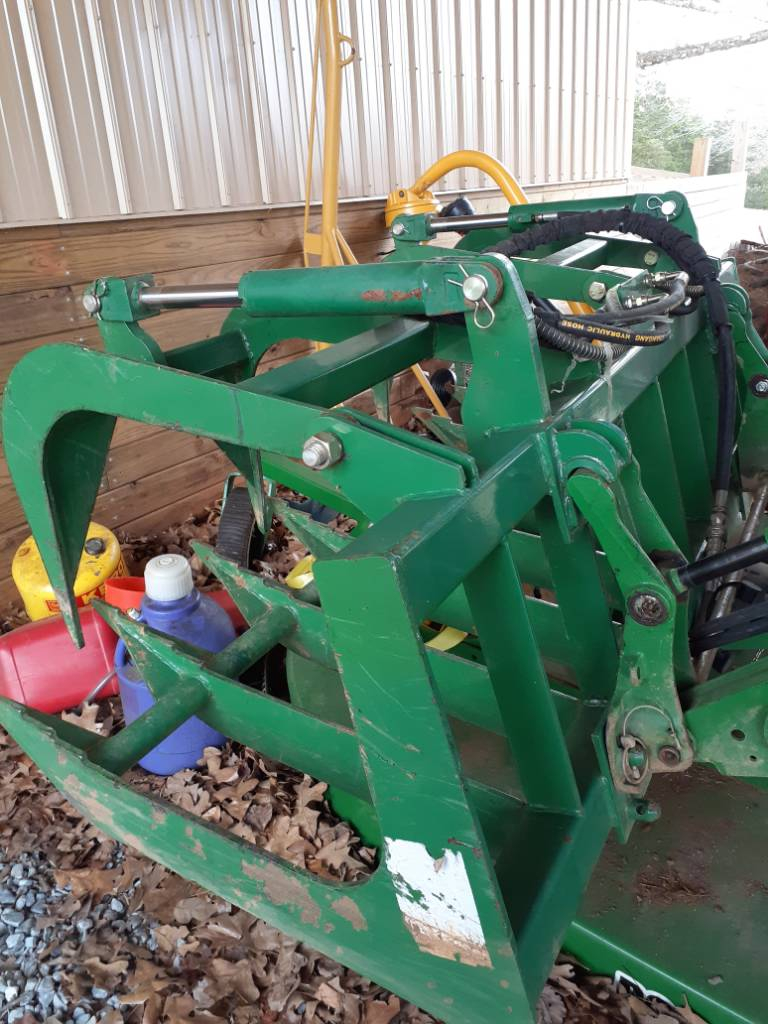

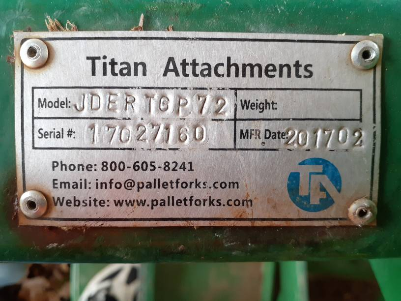

It is Titan. I used it hours today and it worked OK. I'll just remove pins, oil & use cotter pins.
   / Speaking of grapples...????? Pins... #13
I had a green machine thumb bucket grapple once that had the pins like that on the closing lid.
Didn't have any grease fittings, and Never had an issue with pins coming out
   / Speaking of grapples...????? Pins... #14
If you have the room....drill the pin holes out to 1/4" and use a bolt and a nyloc
#15
I'm betting cotter pins I won't have anymore problems. I never liked hitch pins anyway except A few things I remove often and can't snag anything.
I have a box of Zerks and taps. I may drill & tap install a grease fitting which is easy. I use carb cleaner & rag washing burrs out first.
