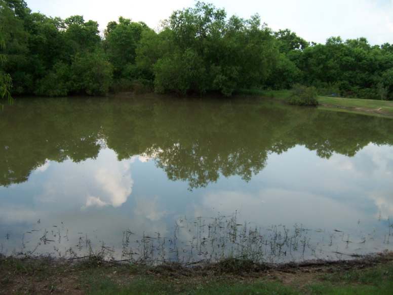

Here's my pond, it's a about 6 feet deep in the middle, I used some of the dirt for levys on the side's so when it's full it adds another 3 feet of depth for a total of 9 feet. It's pretty easy to keep full with all the rain we get down here.
