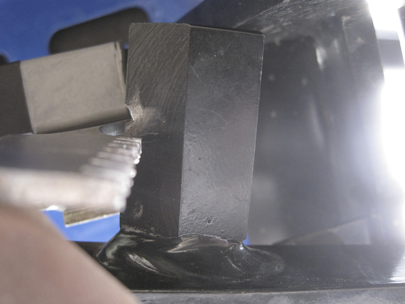

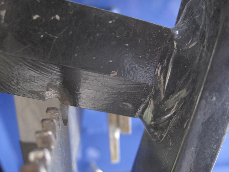

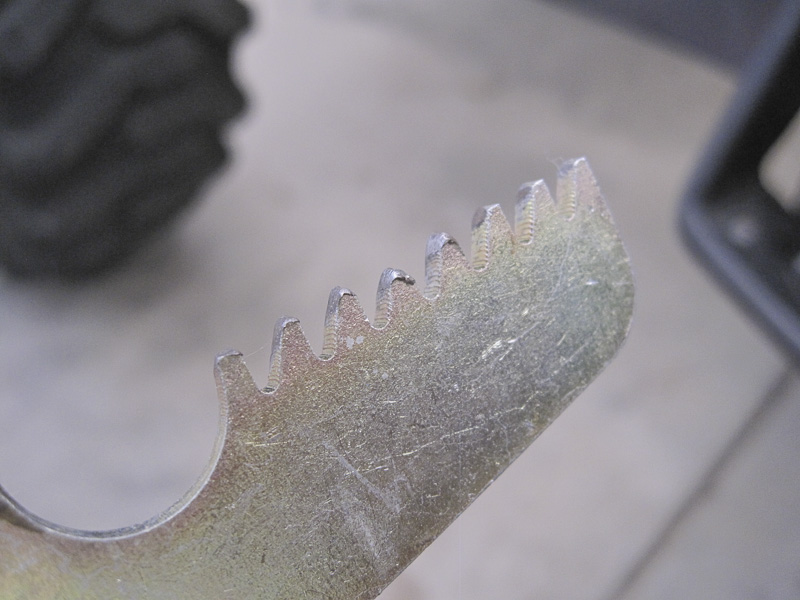

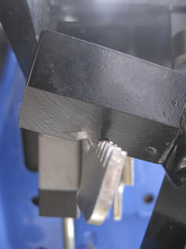

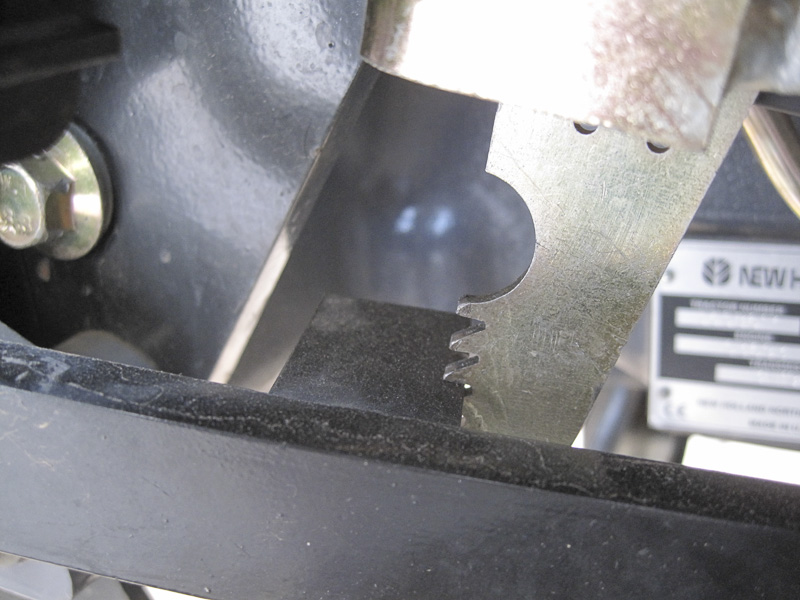

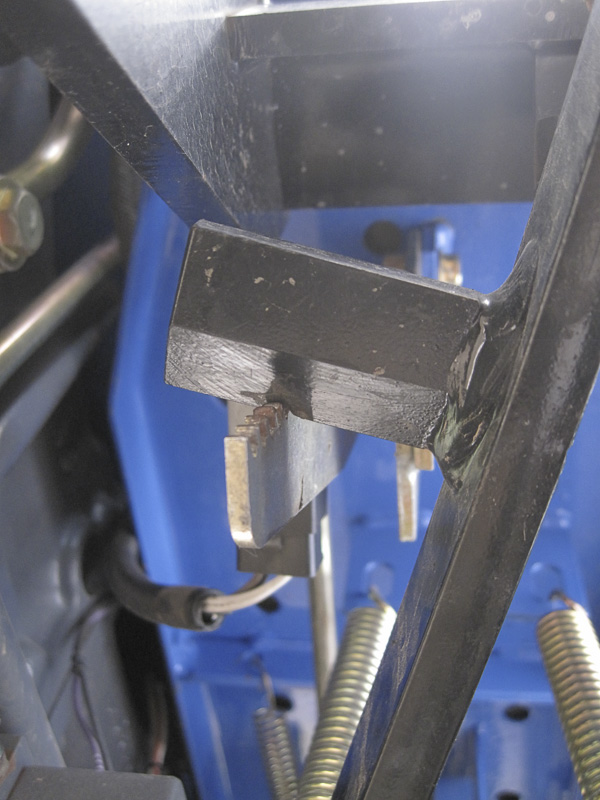

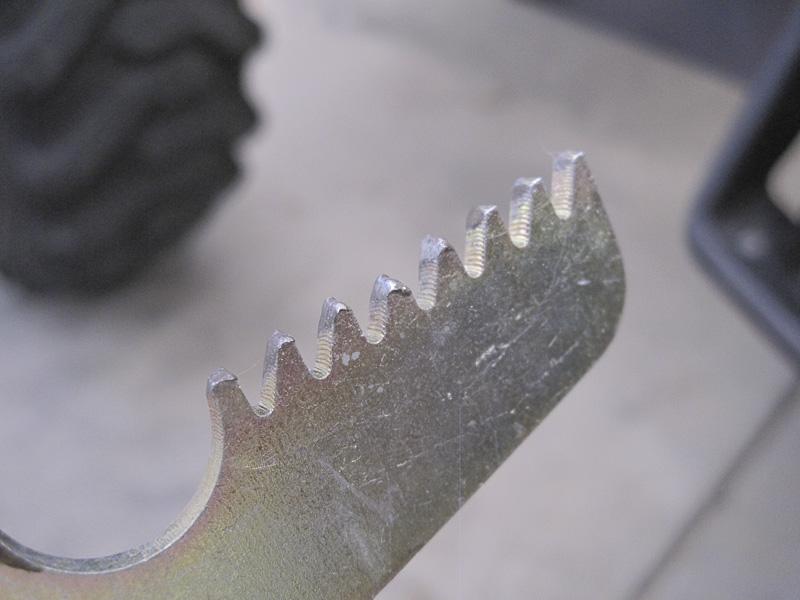

Here is what I found when I investigated my ebrake assembly. 3-Way-2.jpg 3-Way-1.jpg 3-Way-3.jpg These pics are taken looking from the ground up and show that the teeth on the ratchet pawl had created a void at their contact with the metal bar attached to the brake pedal. The alignment of the ratchet pawl was not and never was square/perpendicular with the engagement of the brake pedal. This off center contact had worn an area that finally failed/warn causing the disengagement of the ebrake when I stepped off the left side platform.

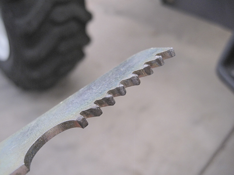

After removing the ratchet pawl you can see the rounded edges of the teeth in these views
   / Specific Cure for Parking Brake Problem? #74

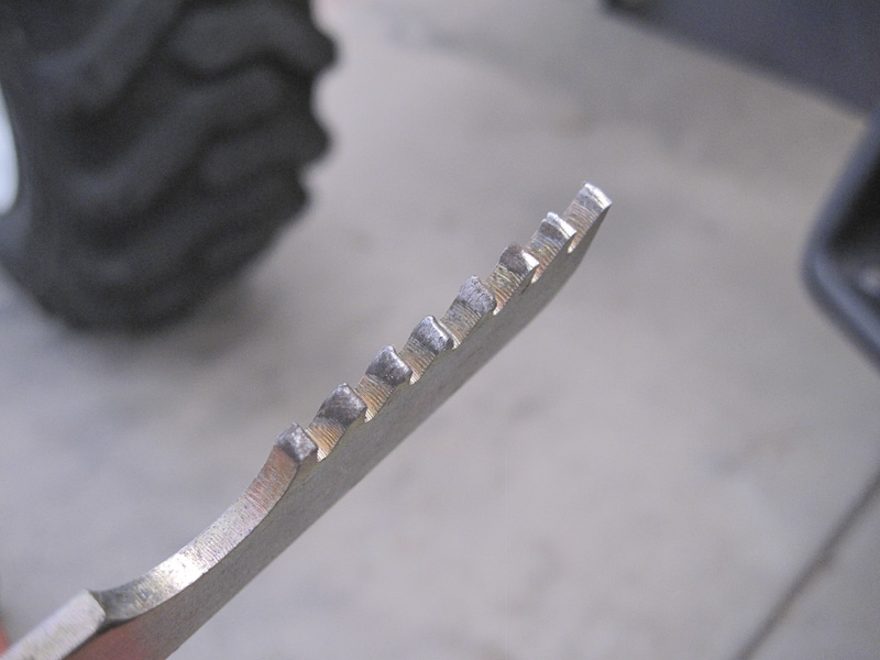

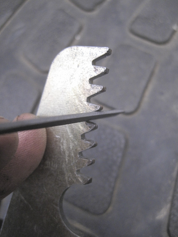

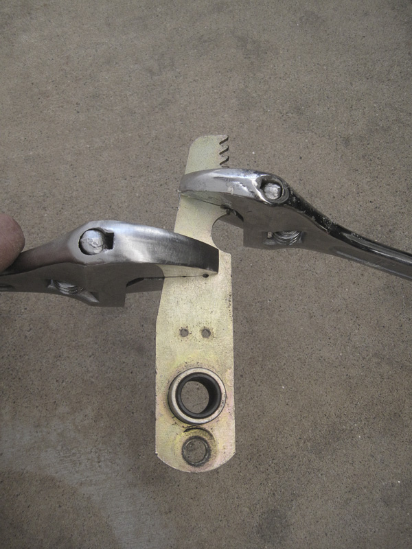

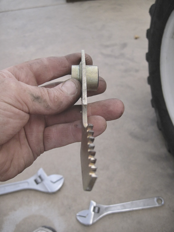

To temporarily fix the problem I have repaired the ratchet teeth using a jewelers file to reshape without creating any rounded edges 3-Way-15.jpg

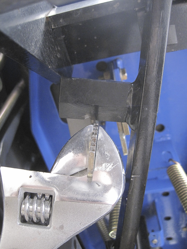

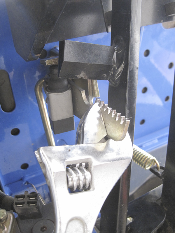

Then to create a better alignment with the brake wedge block I used a couple crescent wrenches to twist area of the ratchet teeth to correct the misalignment. What I was surprised about was how easily this twisted! I made sure to bend the area above the ratchet teeth so as to maintain all the teeth inline... if you attempt this do not bend in a way that the teeth are not inline and parallel with each other! This metal bracket is quite weak and definitely not heat treated or hardened. 3-Way-13.jpg 3-Way-14.jpg
When I reinstalled I was still a little out of alignment. So I adjusted further to get better engagement. Note the wrench is above the teeth maintaining them all inline... again do not bend so the teeth are not parallel to each other! 3-Way-16.jpg 3-Way-24.jpg

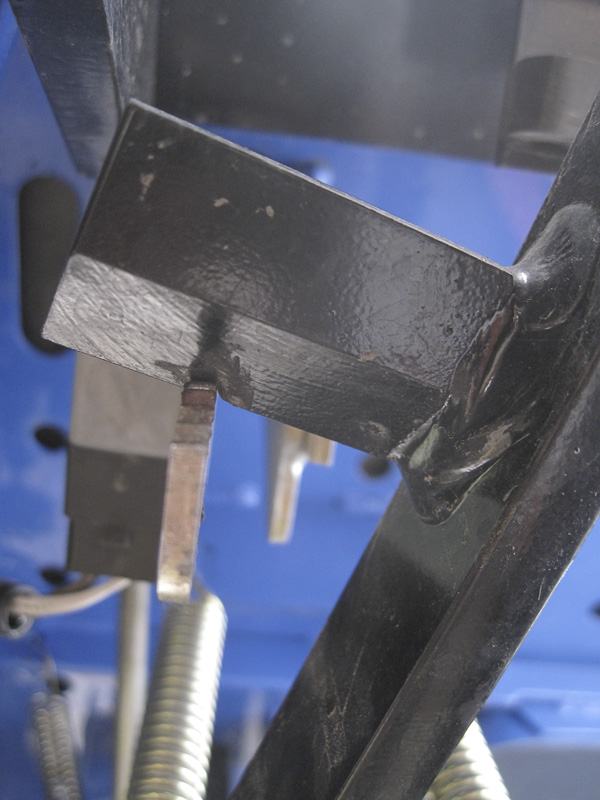

The realignment placed the teeth in a new contact area of the pedal wedge block so I did not need to repair the worn area. 3-Way-20.jpg 3-Way-22.jpg 3-Way-18.jpg
In the 2nd to last pic you can see where the teeth had originally engaged
with the fixed pedal wedge block (worn away area where teeth had eroded the metal). This also shows how much I twisted the Ratchet pawl to achieve best mechanical contact.
   / Specific Cure for Parking Brake Problem? #75

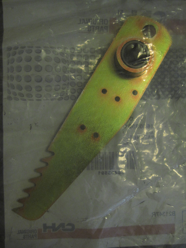

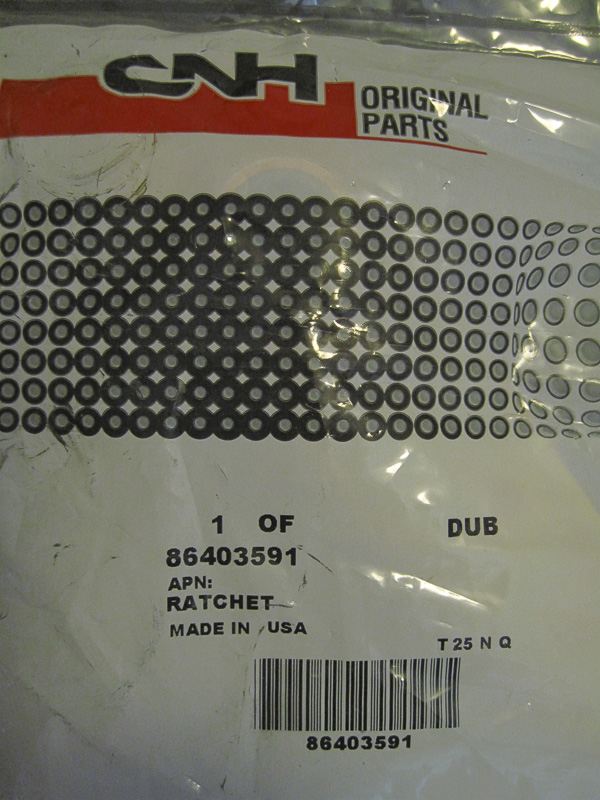

I have used the ebrake without issue, but I do not trust the ratchet pawl. So here is what I am doing to correct it... I ordered a replacement from Messick's At $63.55 + shipping.
The replacement part is a bit different than the stock one with only 6 teeth that appear to be slightly deeper. The new unit is missing the half-moon cutout just above the teeth which will make it more difficult if it is necessary to straighten alignment with the pedal wedge block. I do not have the tractor handy with me so I will need to attempt the repair in NM when I return there in a couple weeks.

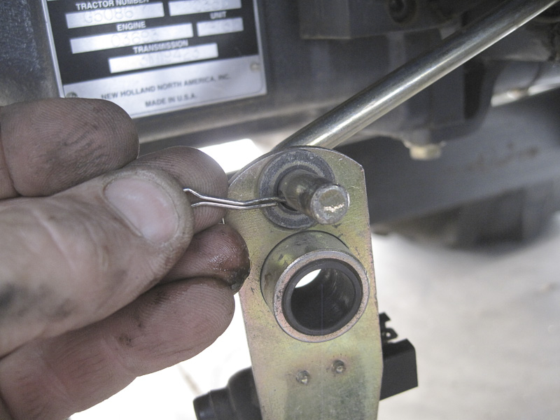

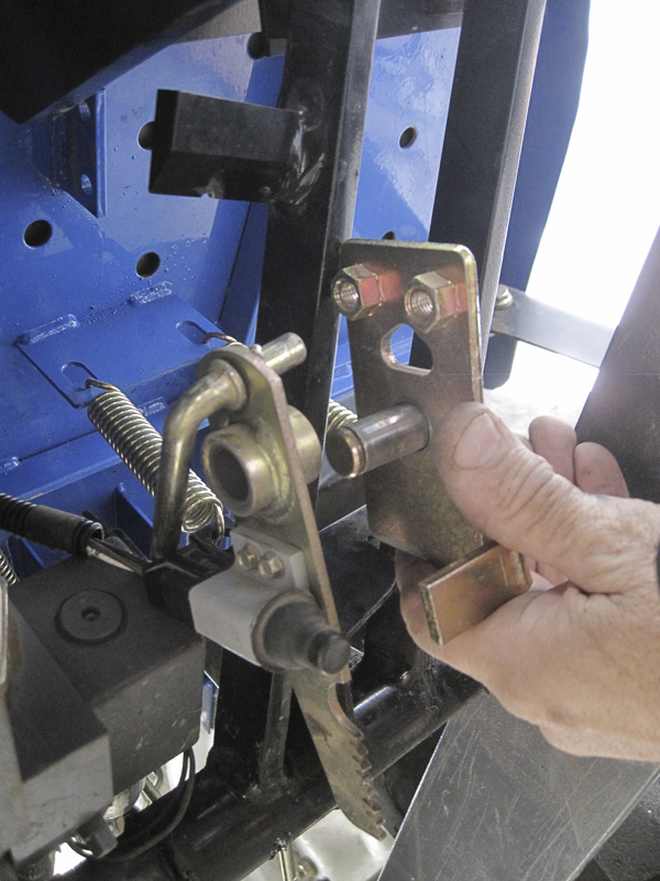

For those attempting replacement or repair... the process is pretty straight forward. Although I did not take notes, I did take some pics, so as I remember it. SAFETY should be your first concern. Make sure you are on level ground, tractor is in gear, block the wheels, etc.

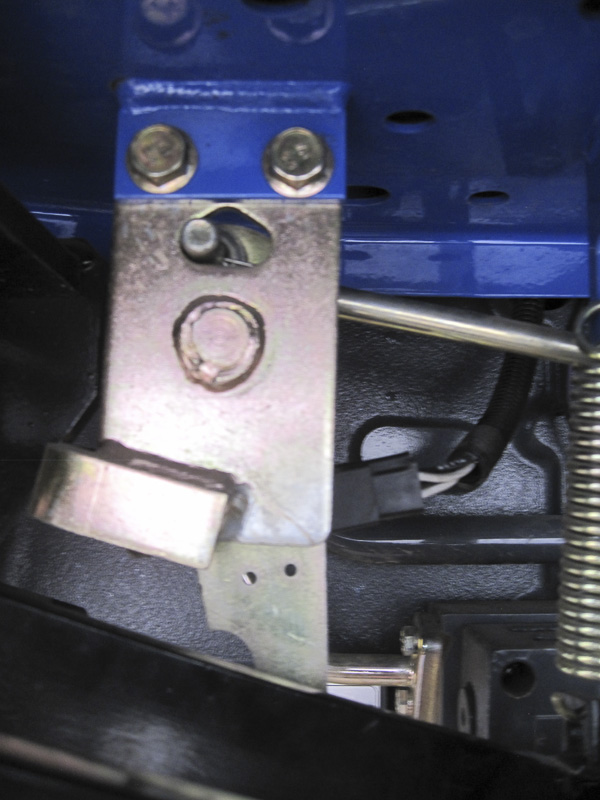

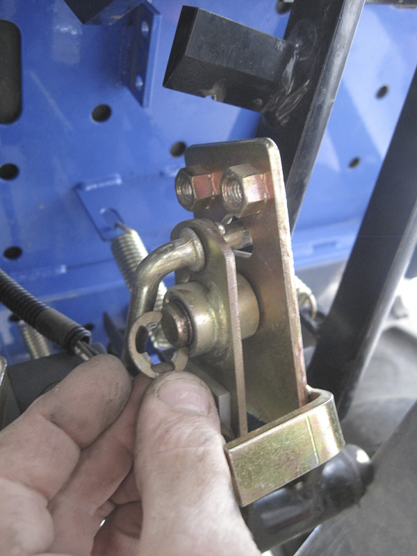

Step 1 - remove the ratchet pawl pivot bracket which is held on by 2 hex head bolts (seen here at the top of the pic) 3-Way-4.jpg

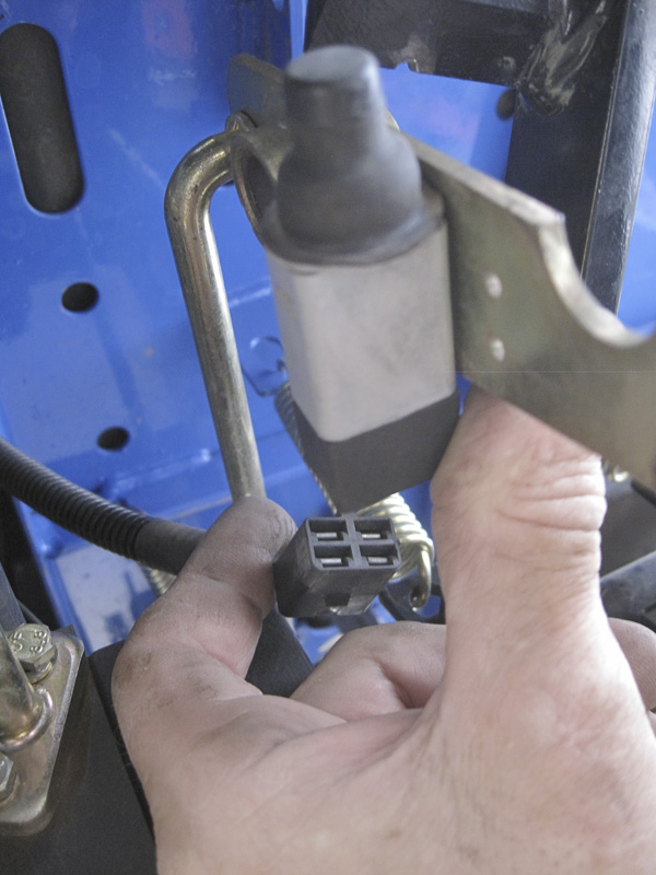

Step 4 - remove the electrical connector from the ebrake safety switch 3-Way-7.jpg
Step 6 - if replacing remove the safety switch
Assembly is in reverse.
