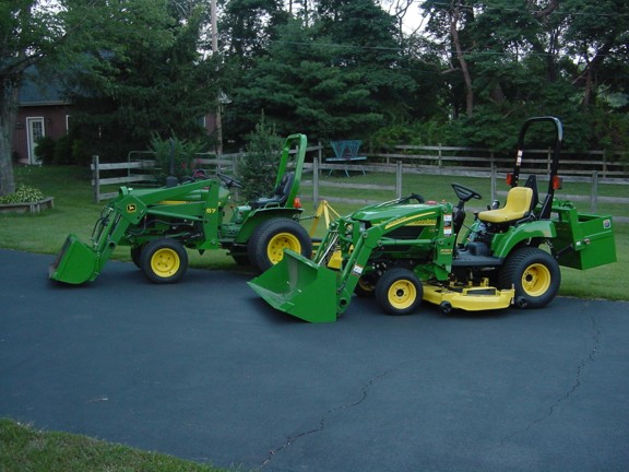

Did a little research on how much the 200cx loader sticks out in front to the 210 fel. My father in law has a 2210 with 210 loader. If the 200cx is longer I couldn't see much difference, it's sure not 12". If anything a couple inches, if that. Here's a photo of my 200cx loader. You 210 loader guys tell me if you see a difference.

Lobo,
What are you comparing in this pic? What is that other tractor behind the 2210? /forums/images/graemlins/confused.gif

Not comparing the 650 & 2210 in the photo. This was the only pic I had on hand of my 2210 with the 200cx loader attached. Is your 210 loader closer to the front then the 200cx in the pic? Like I said when I looked at my father in laws 210 loader, I couldn't see much difference in distance.
