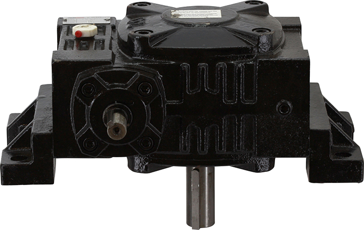

So this reducer
This is the manual for it.
What does the vent direction info mean??
Install the vent plug according to the following::
1 Vent plug to be installed at the uppermost position.
2 For all mounting positions where the vent plug is located in a horizontal plane , the vent plug must pointed upwards.
3 For all mounting positions where the vented hole is located in a vertical plane. the vent plug must be pointed toward the center .
Questions?
What is the vert and *** plane mean and where is pointing toward the center of the housing?????.
   / Speed reducer
#15
After reading the manual the output and input shafts can be removed to the other side so it appears the the output shaft should be able to be moved from th8494072.jpge bottom to the top of this one. I did order one of these today.

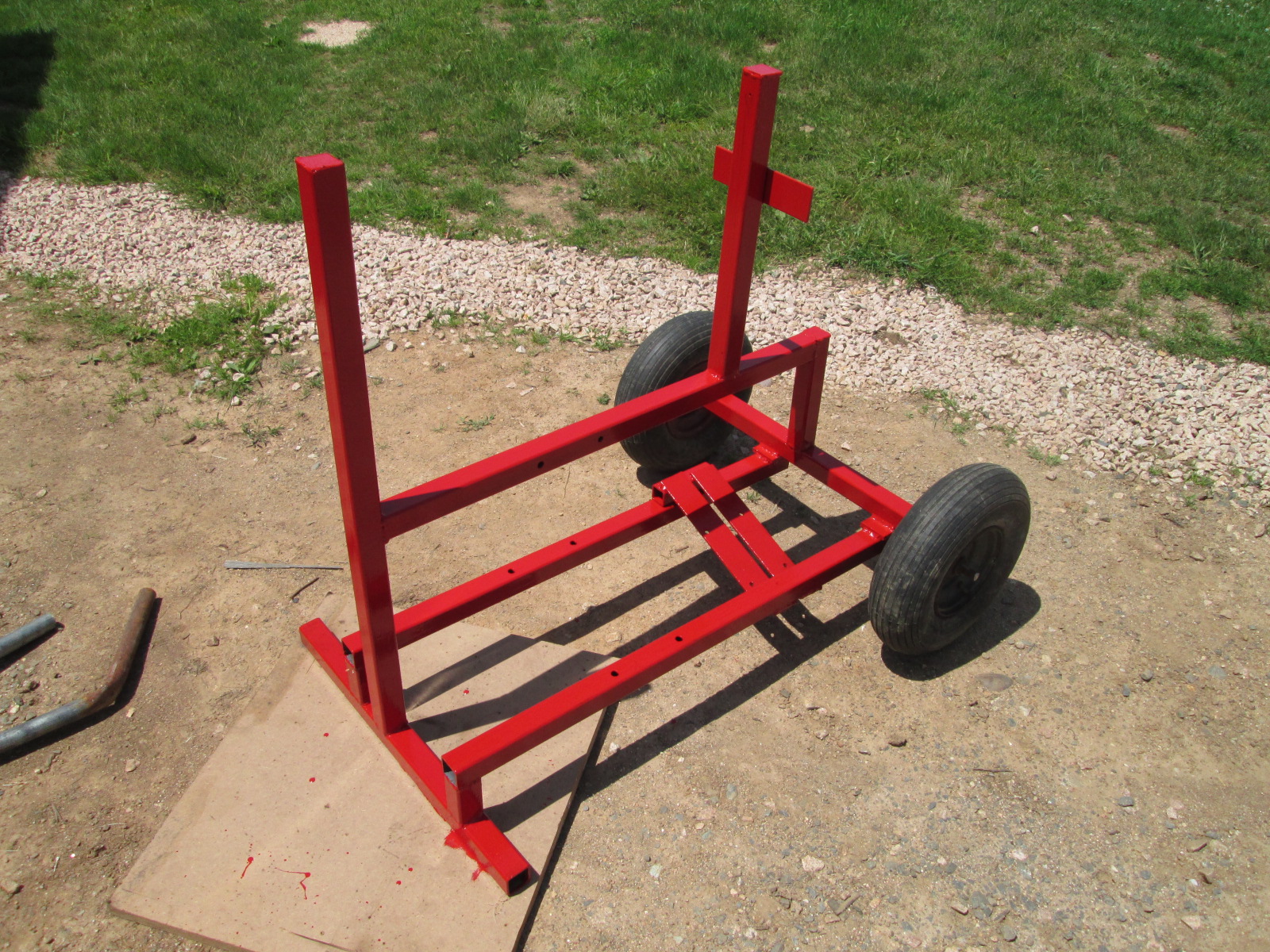

Plucker nearly all built. Just have the spindle out to a machine shop to make a key way slot for the flex coupler.
