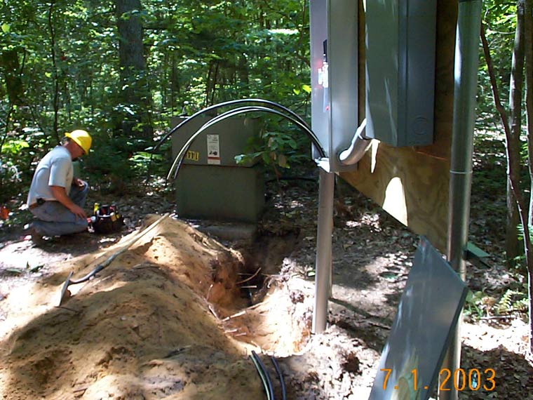

Update on power.
The electrical inspector came out a few weeks ago and looked over my work. He said I did a nice job and that all I needed to do was to add two ground rods, tying them together with at least #6 copper wire. I knew I was going to need a ground rod but was unsure on exactly what to do so it was a good thing I waited because I surely wouldn't have put in two. He said I needed two because the soil around here was so sandy. He said if I could get 25 ohms with just one rod then go ahead but I want do everything better than needed. I used two 5/8" diameter 8' long galvanized rods spaced 6' apart and tied them together with #4 bare copper wire and then went right up to the load center with that same piece of copper wire.
I think I mentioned earlier that I really wanted to tie my house into this same meter so I wouldn't have two separate meters on the property. After talking to the electrical inspector (he liked the idea too) I decided to try once again to talk the power company into letting me do this. The inspector approved what I had already done and put his sticker on the meter box. He said he would hold off calling in the approval for the power company to come out and hook up the meter until I told him wether or not I was going to be able to change things around and hook the house up to this meter. I took a whole week to get another denial from the power company so I tried calling the electrical inspector to have him go ahead and call in the approval. His answering machine said that he was on vacation until 6/30 so I went down to the township offices to see if he left the paperwork there and see if maybe they could call in the approval. As soon as I mentioned the inspectors name to the two ladies in the office one of them started to cry. While the inspector was down in Florida with his whole family on vacation he passed away. Aparantly he was a well liked man and I can see why. I only met him the one time but it was a pleasant experience. I told him what my plans were and asked him a few questions and he gave me some tips, not once did he try to make me feel inferior because I was just a homeowner and not a real electrician. I've said a few prayers for him and his family.
The township did call in the approval and the power company is out there as I am typing. They needed to dig aproximately 5' from their transformer to the new meter panel and then feed it with 350mcm aluminum wire. I am fortunate that I got charged only 85 dollars for them to do this work. There is a "hand digging charge" of like 15 dollars a foot and some other misc. stuff on the bill.
I went out there and took a few photos of them working. Here is the first photo showing the trench they dug from their transformer over to the meter panel.

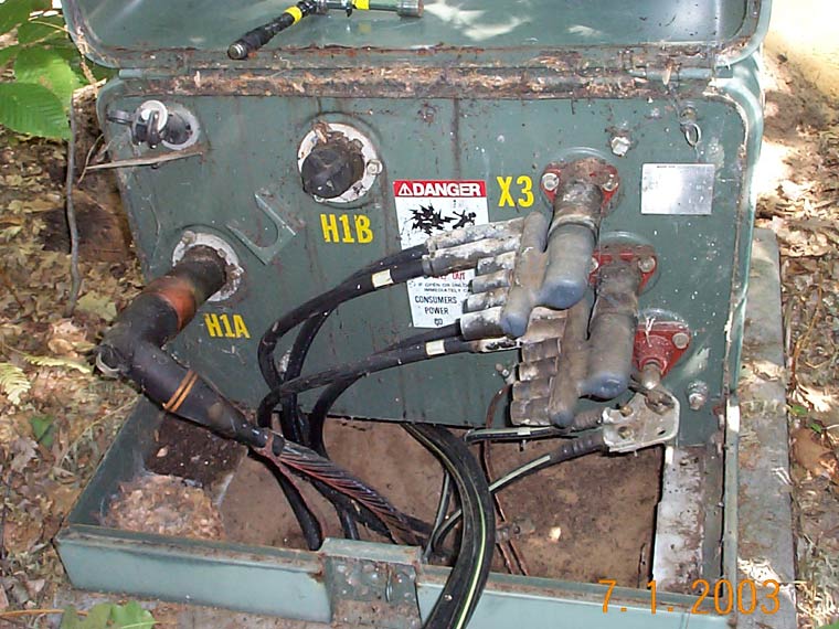

Here is a picture of the inside of that transformer. Maybe Inspector507 or somebody can tell us what we are looking at.

Spencer,
The inspector was correct in saying if you got 25 ohms or less on your grounding electrode, you could forgo installing a secondary electrode. Most people find it easier to install the second one instead of trying to loacte a ground reference tester.
What you are seeing in the transformer is.....on the left hand side in the middle labeled H1A, is the "high voltage" primarycable coming in and terminating. Above that, in the top left corner is a fuse protecting the transformer. Most times depending on the load, they are a 15 Amp fuse.
On the right hand side are the secondaries where your new meter will connect to. The lowest terminals on the right hand side are the neutrals or grounded conductor terminations. Notice they are not insulated and not a shock hazard for the most part. I can see that 2 buildings or structures are already connected to that transformer.
These transformers are usually oil filled to aid in cooling of the windings inside.

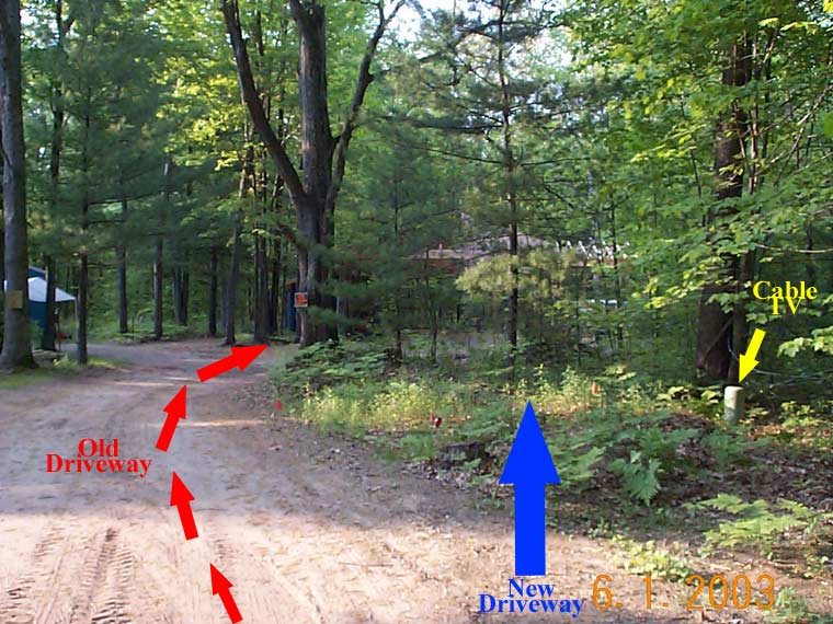

As you can see in this picture, my current driveway didn't give me a straight shot into the pole barn. I wanted to correct this now before I trenched in the power lines that will feed the pole barn. I had to be careful around the cable tv pedestal that you see in the picture. This is on my property but it only feeds my neighbors house. I convinced the cable company to move it over into the joint easement area and get if off my property. They came out last week and did the directional boring to run the new cable but have yet to move the pedestal. So I had to be very careful working around the pedestal and the buried cable.
