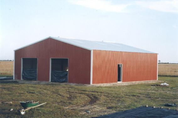

Anyway, I've attached a picture of our new barn - 40 x 50. It will have slab, plumbing, shop, and bath facilities so I'm really looking forward to final completion. I decided to pay to have a barn company install it, then I subcontract the slab. Barn construction took 4 days. All the plumbing and prep for slab was done by me - I found that to be a good balance between what I could reasonably do and still not feel too overburdened by what needed to get done. I understand that it's really a huge accomplishment for what you've done - building a large structure is WORK!
On the roof, if you attach 30 lb felt (rather than standard 15 lb) with the large disc washers and/or wood strips, you would be surprised at how long it would hold up. Wind is your biggest challenge.
Great job you've done - please continue to post pics as time (and weather) permits!
