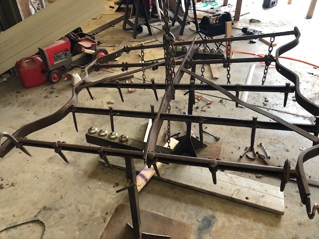

Hi Everyone,
first time posting and I'm in need of some help. I recently got a spike tooth drag and its in OK shape. But last night I was looking it over and there is no adjustment on it. No lever to move the spikes from aggressive to less aggressive. Is this something i could fabricate myself? Does anyone have one they could take a picture of, or any ideas to make this easy?? Any suggestions???? I am using for our property and would really like to use it soon for some deep thatching and some seed prep. Thoughts ?

The boom pole is a good idea. but I have attached a picture of my spike drag, it looks like it should be adjustable
THis is picture from the front
Jack

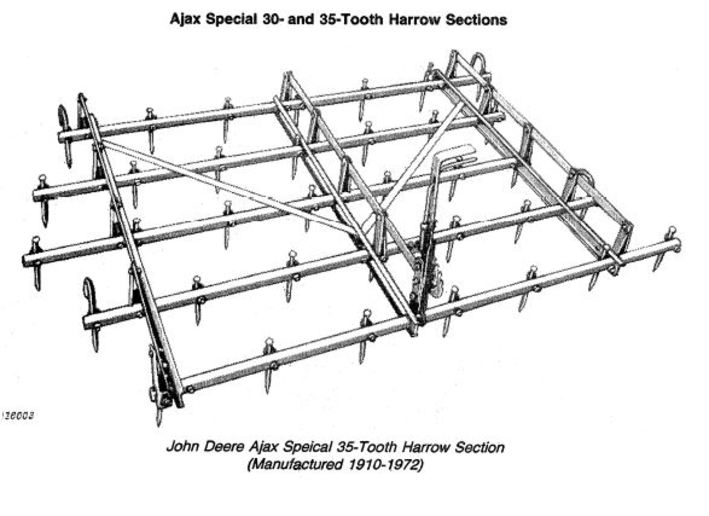

Looks like a common style with all the adjusters removed.
This drawing better shows adjustment system.
Bruce

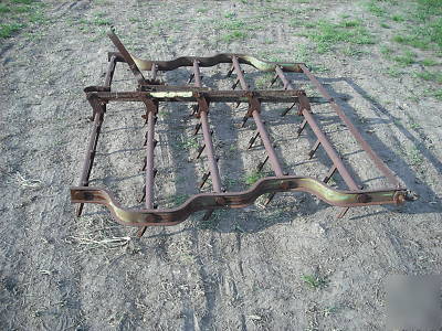

Just to be sure,you do know that teeth point to the rear when pulling. Most smaller harrows, the teeth are not adjustable. I seen big harrows such as 12 ft. up that were adjustable.
Bruce
That's what it is and it's a light duty one. It would really only work in already worked and flattened soil. It's light and would just ride over cultivated ground. Around here, people use them to smooth horse arenas. Better off to just buy something else if that's what you want. I would consider these an item to sell to a horse person for their arena.

Agree. While each of those cross shafts was originally free to rotate in the outer, wavy, rails, to allow adjustment, it appears the shafts are now welded solid to the outer rails and also welded to that new center stiffener. You can't un-weld all that!
Run it as-is. Or clean it, paint it, sell it, start with something else. It's not restorable.
