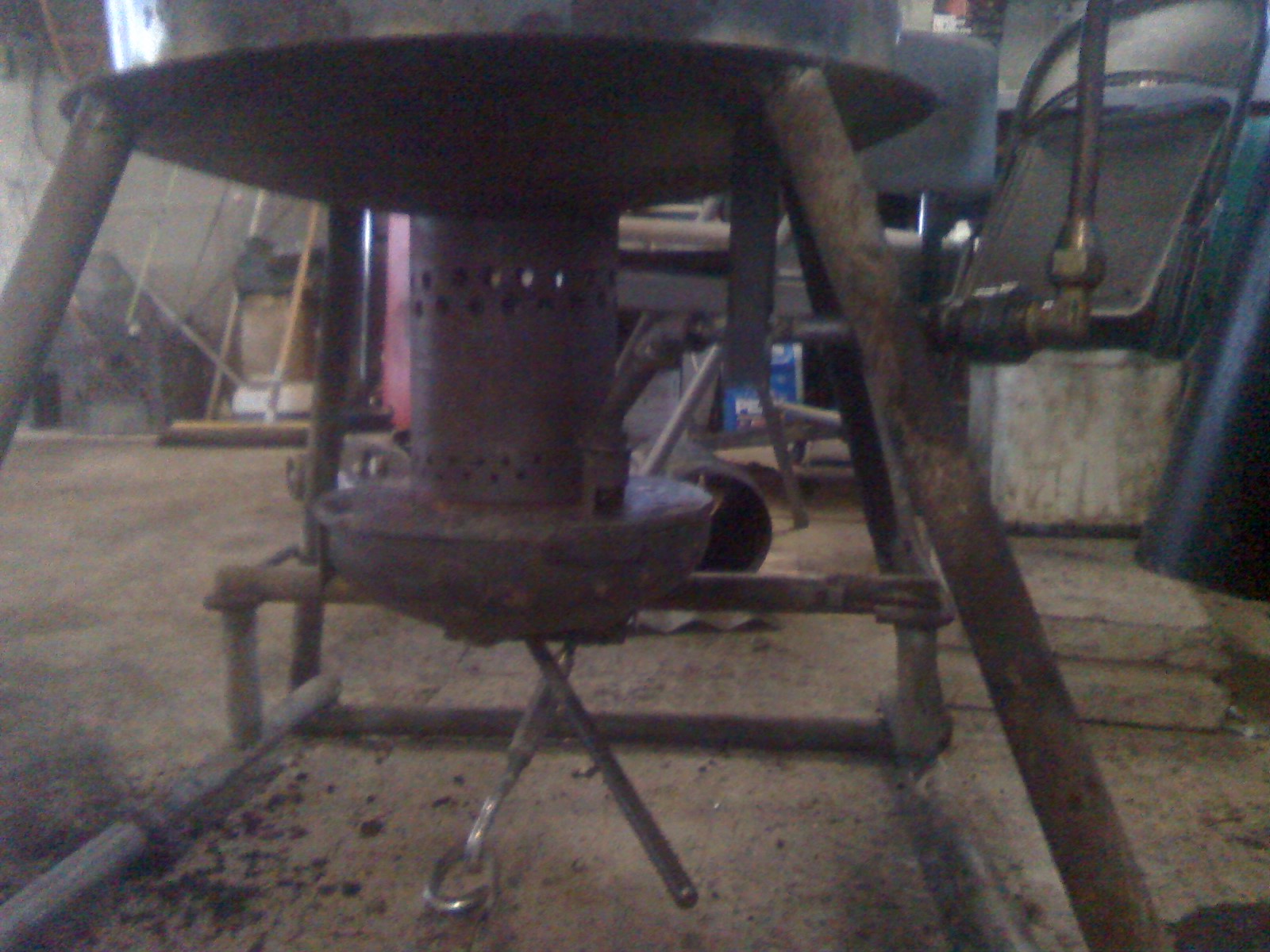

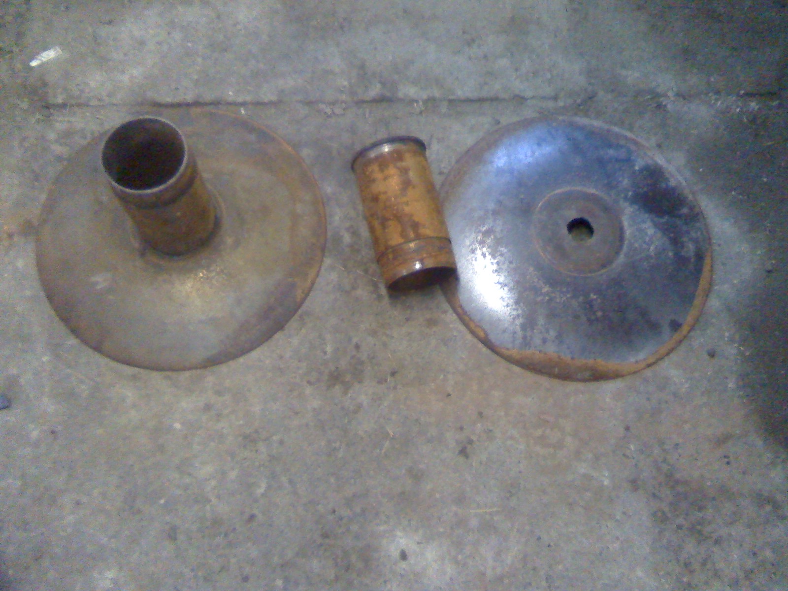

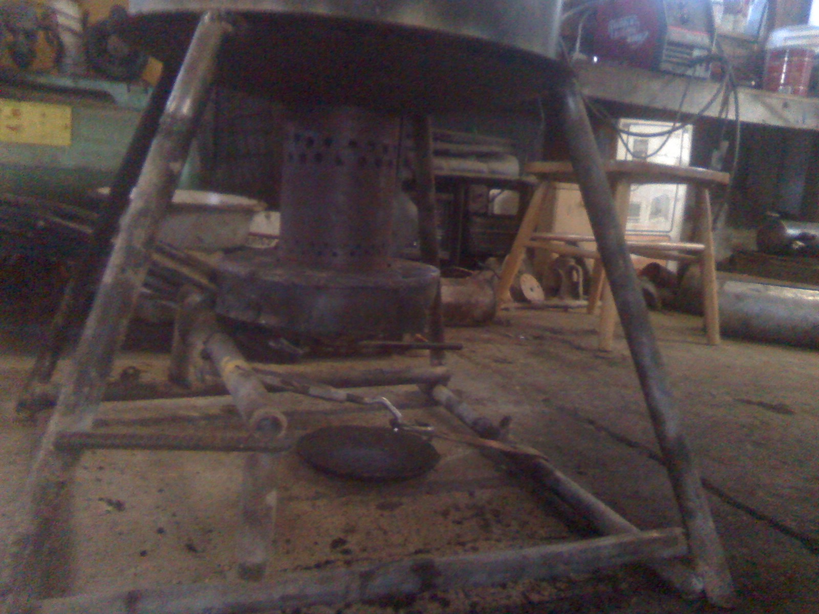

Had some days off so I hit this project with full throttle. Got so caught up in the project a camra was last thing on my mind. Missed a few points in-between, here it is. Of course these things are always a work in progress so its not all the way done.
The only thing special is the baffle inside right above the secondary burner. It incorporates the first cylinder liner that I messed up with that sort of makes a third burn chamber by suspending it above the secondary like a church bell with inch plate steel.
My burn pot is the bottom of a freon canister and my lid cut from an old coulter wheel, A baler pick-up sping tooth holds pot-lid to the liner, a disk from a jd mulch tiller, An old water heater tank instead of break drums, 1/2 inch iron pipe frame and legs and various sizes of re-bar used.
The results have been outstanding, massive heat with little smoke and clean burning after warmed up.
My design incorporates many different ideas from gathering info from many other places.....more info out there now with better designs compared to five years ago.
Seem to have lost the picture of the complete heater, I'll post it soon as I can:D

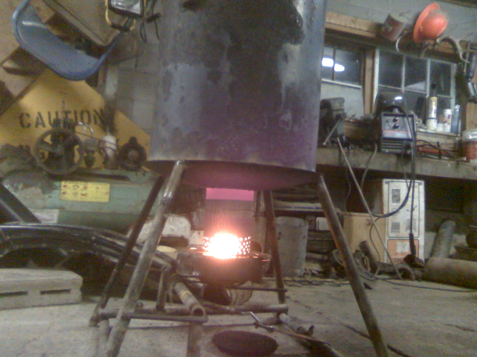

Full throttle... I added more 1/4" holes, around 55 or 60 now, at the bottom and covered the big ones 3/8 inch size at the top of the liner, Hotter and cleaner was the result. Going to add possibly few more rows of smaller holes of 3/16 inch or so...
My pan or lid did not glow like the rest of it at peak temp. I did open up three holes to around and inch with the neighbors plasma cutter that helped the choppy sucking air sound that had the same resonance of an idling v-8 with an open exhaust system, to loud for my liking for the shop/garage.
Been more involved than planed, started with some "plans" but its by the seat of my sooty pants now. Its free heat, and so far I am out nothing monetarily, just time. Which the wife has reminded me:D
