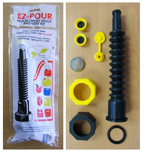

Maybe it's just me but I have spilled more fuel using the new spill proof nozzles than I ever did before with the plain old pouring spouts. A definite case of over engineering gone rampant. On one type of fuel spout I have to push a safety on the nozzle and a lever at the same time. What's next? Maybe closing my right eye and while at the same time holding my left hing leg lifted 24" in the air?

The new system SUCKS!!!! So take the new system and make some adjustments and they work fine.:2cents:
   / Spill proof fuel containers #5
i did the tire Valve mod and can report it works great and makes the can work like old ones...even a little better
Drill a hole, add tire valve, remove core done

As the old military saying goes these cans are a CF. The idea was to limit pollution, but it has increased it. The new cans leak, don't pour with a darn and general are worthless! I have a few 6 gallon cans I bought for diesel fuel a few years ago and they were great, but I can't buy the original replacement spouts now and the new ones are terrible. The tire valve vent works although I use a piece of rubber fuel line and an off/on valve which also works fine.
