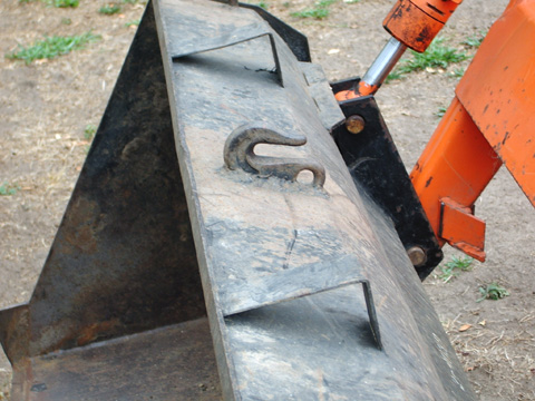

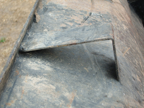

I welded 2" x 1/8" L brackets on the top of each side of the bucket where I could see them from the seat. The long side of the L was flat side up and parallel to the bottom of the bucket.

I've tried to visulize what you did but I can't see much benefit to any of the configurations I've come up with. Would you mind taking a digital picture of it and post it?

angelugs,
Hopefully a picture is attached.

   / Spirit FEL(s) #17
Another picture attached.

Thanks for the picture. That's one configuration I hadn't visualized. After seeing it I noticed the top of the box on my loader is flat and parallel with the bottom. So I've already got a gauge similar to yours and hadn't realized it.
