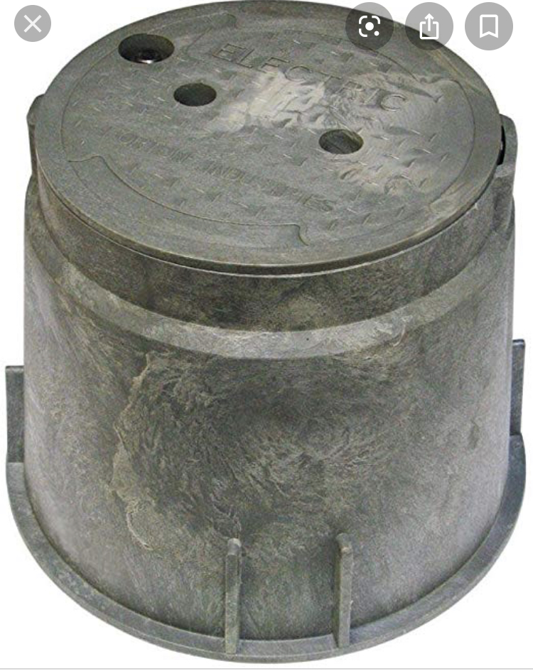

Found myself thinking that way, too, but if you brought to the surface, wouldn’t the wire be too short?
The wire doesn’t have to come to the surface.....just the lid of the box. And they make box extensions if you don’t want to make something to be below the box.
/ Splicing underground wire #22
If the appropriate slice is used, no worries. Make sure to have some slack (don't stretch the cable tight) so if there is any contraction or expansion it is not pulling the slice apart. It is done all the time, both with underground wires and wires down in water wells. The splice connecting the pump to the feed wires has both movement and water and they work well..

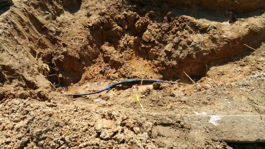

I have to somehow splice three pieces of 12 2 direct burial.does anyone know the least expensive way to do this?it will be buried about 2 foot in dirt and won't be live all the time.thanks
Thanks for the ideas. I have plenty of wire to work with on this. But there would be three wires all coming together so it would be difficult to use some of the less expensive ways.
This is where more information is better than less. Nowhere does it mention if this is a break/damage/repair or new installation. Nor does it mention is any of these three line are already in the ground and maybe one is being added.
The posts mentioning wires being 'too short' are thinking this is a break in or addition to existing lines. At first I thought it was about using three pieces of wire to make a new run, splicing them together end to end instead of a single longer piece. Now we see the bit about three lines coming together at a single point ('T' or 'Y' configuration). If that's the case, I would definitely use an underground rated box that I could open up later if necessary.
I prefer conduit whenever possible and practical for added protection from critters and tools. I don't see how it's possible to affect capacity ratings of any cable by using PVC conduit. Steel conduit ... maybe.
He also mentions it will be two feet deep, so a box extension won't accomplish much if he doesn't extend all three lines to the surface.

There was a small shack that is being moved. So im left with two lines and plenty of extra to comment. I plan to add another line ,so there would be three lines of wire coming together.I have seen some pictures of people who have just used a special wire nut with silicone .But im not to thrilled with that. I found the sleeved connectors as I posted from Home Depot So I think I will use those and also shrink wrap the wires inside. My one concern is that the one end that will have to have two strands come out of it will not seal around the 'o' ring. If I had a shrink wrap that would fit over the who assembly I would use that also. But Ill just use rubberized tape as a secondary precaution.

I thought that code called for all splices, connections, be accessible and not hidden or buried as well as to be in a 'box'.
Now perhaps than is only in buildings and not buried lines.

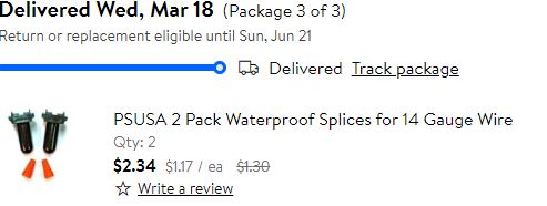

Thanks for all the info and suggestions. I ended up using these.
They have silcone inside that gooshes over the wire nuts.but I also wrapped it all with rubber tape.
