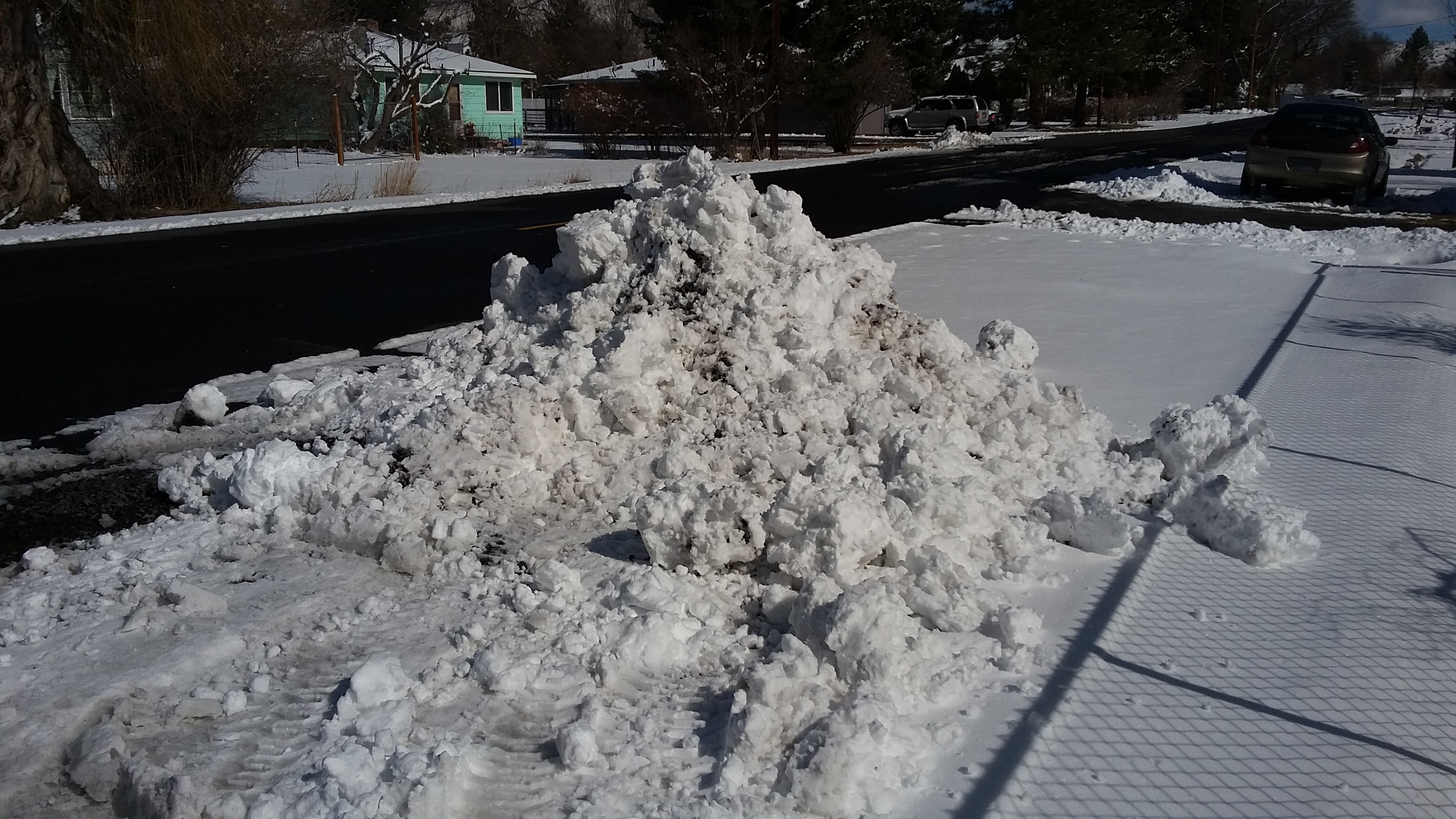

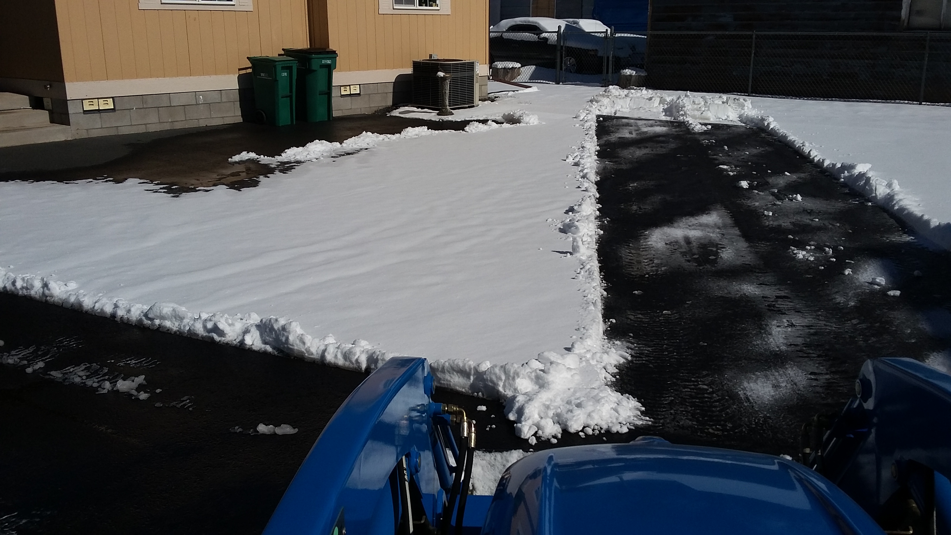

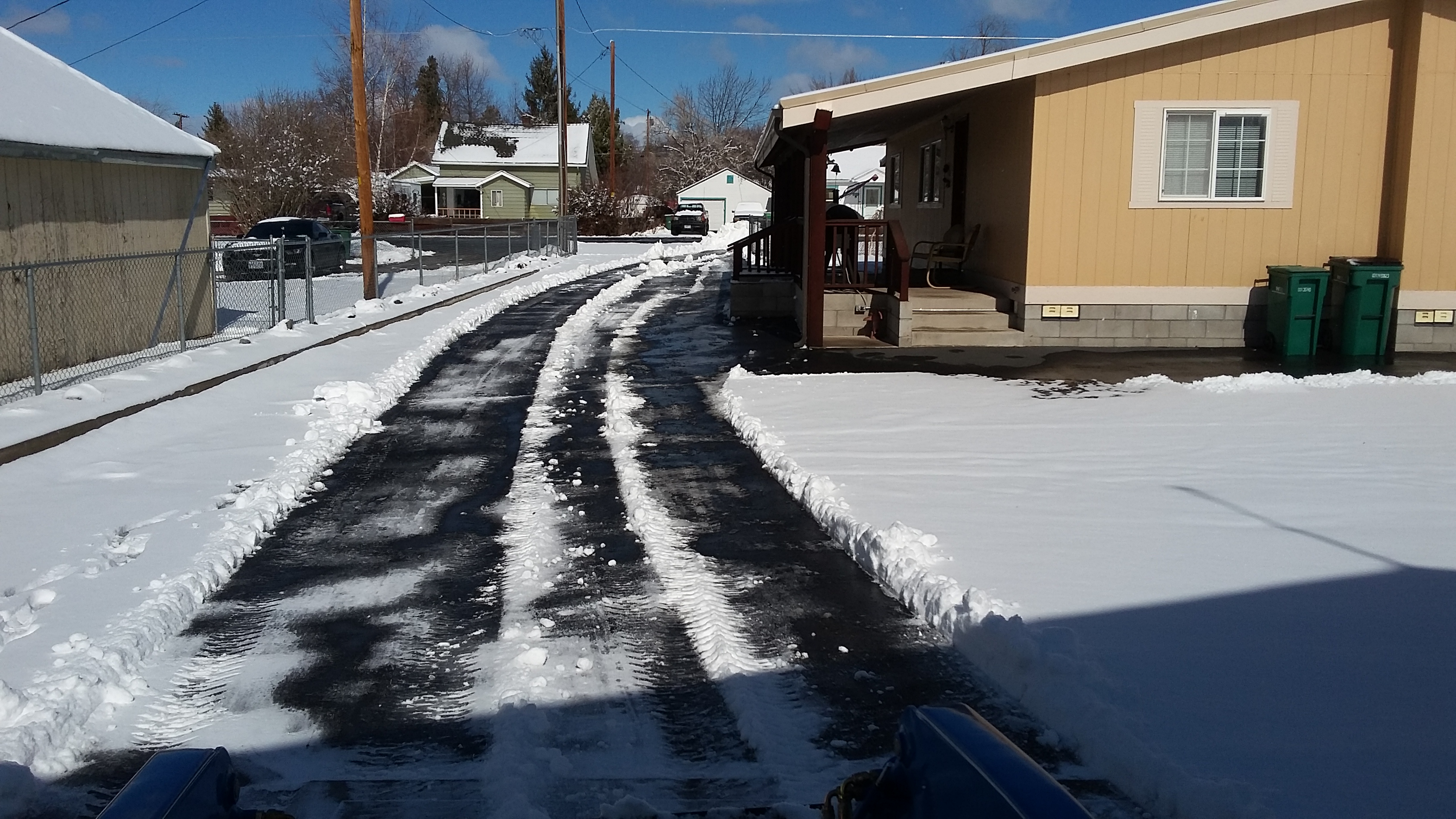

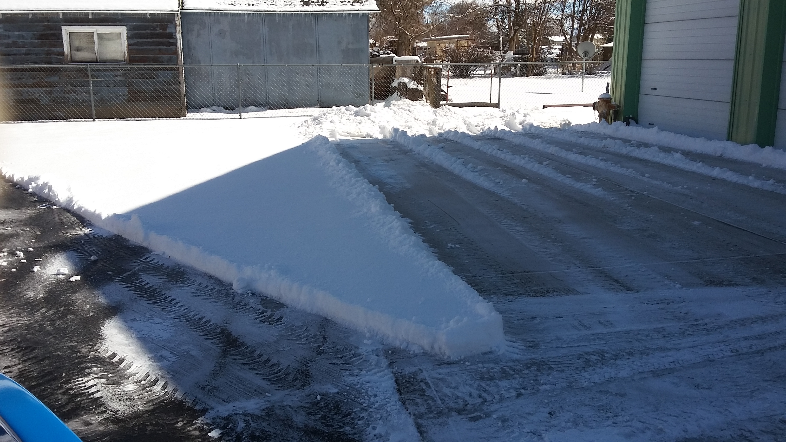

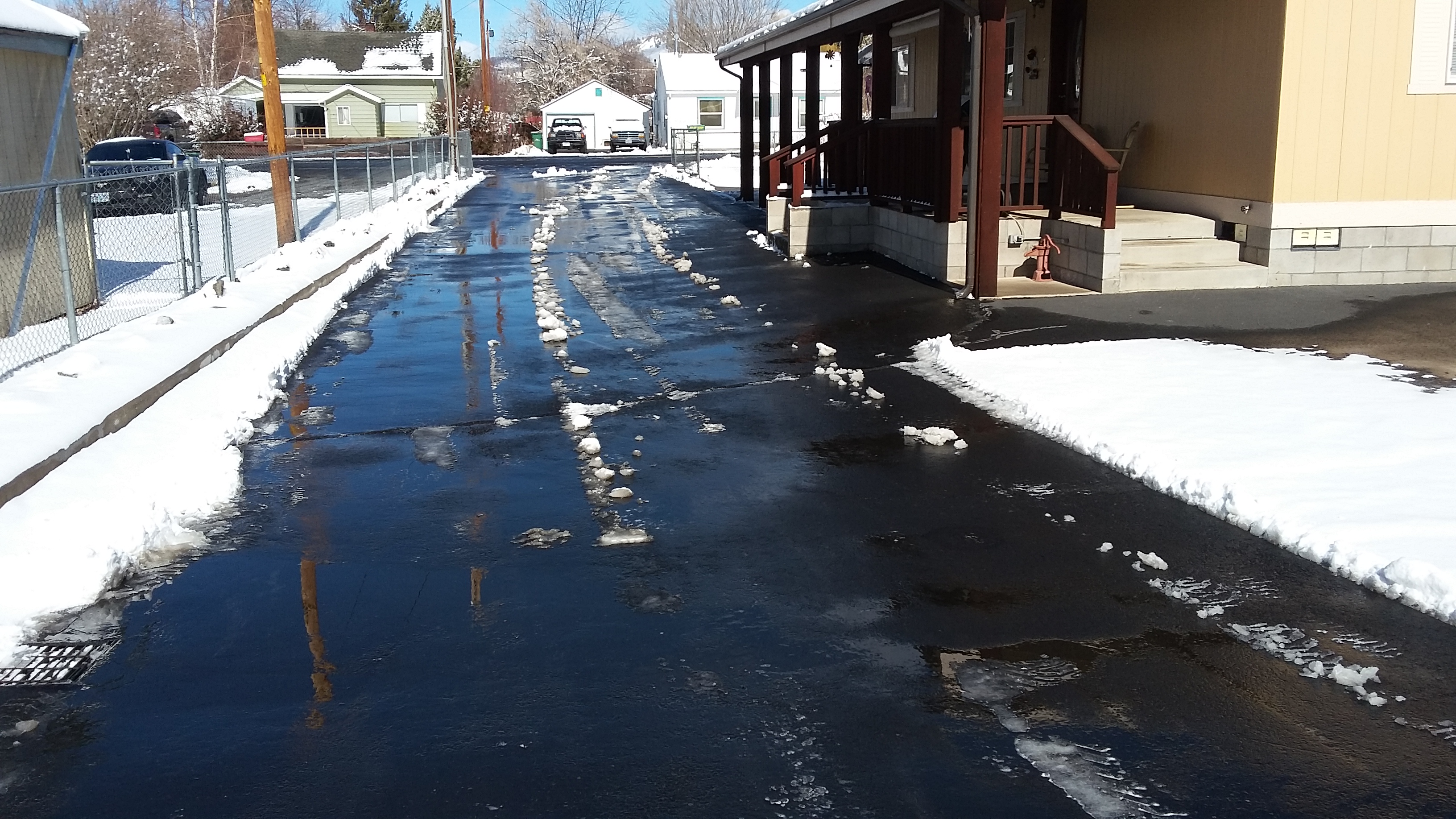

Well first I have to announce that today was the very first time I can say I have actually done real work with my MT-125 and I had a ball. I've owned this tractor now for 4 months waiting for some snow or work to do and today was my day. So I'm thrilled. :cool2:
The tractor has been sitting for about 8 weeks now with the new "Split Pipe" cutting edge on the bucket. Well last night we got about 3" of snow and I said today is the day to try it. To say it was a success is an understatement. I had the backhoe off so the tractor was more evenly weighted and I could steer it and had not traction issues. It rolled up big buckets of snow that I could lift into a pile and I was so pleased. No my entire driveway is asphalt or concrete so I would take a "cut" with a level bucket in the "float" position and off I'd go. Where I was putting the snow was in a pile in front of my home and there was a transition from the asphault to thick gravel. Well I didn't raise the bucket quick enough and while it didn't dig deep it did push a sizeable amount of gravel into the snow pile. Now it's been mentioned that the best way for this pipe cutting edge with gravel driveways is to get a layer of ice to work on and I would agree that would be the very best situation for the pipe cuttine edge but I'm here to say it worked flawlessy through all the transitions from concrete to asphalt and back again. It cleaned the snow and ice off in one pass and didn't snag on anything. When I was shoving the snow off the asphalt onto the gravel pad and into the pile I took it off float and just raised it a touch. This way I did not dig the gravel or when I was pushing the snow off the asphalt onto my lawn I didn't dig the grass at all this way. But I was very pleased as it left the driveway clean and clear of ice and snow.
Now after I put the tractor away I raised the bucket up so I could see how much of this pipe I wore away. I used a piece of 1 1/4" black iron gas or water pipe. Nothing fancy. I don't know how thick that pipe is but would "we" say 3/16" thick? Well this one hour of work I would estimate wore 1/3 of that thickness away. So if I could get this to last for 3 or 4 uses without it splitting and wearing away I would be lucky. But time will tell. I may see if I can buy thicker pipe or a harder steel pipe in the 1 1/4" to 1 1/2" diameter that may wear better. But on the positive note this would leave a perfectly clean path behind it and that is what I was looking for. If you remember when I started this thread I mentioned I bought a set of "Edge Tamers" and they worked perfectly as advertised except they raised the cutting edge maybe 5/8" of an inch and I would leave that much snow behind. This was not what I wanted to do as I wanted my passes to be clean. I am very please with the pipe and I have a total of $18 in it so it's well worth the money. It would last a lot longer if it was working on an ice coated gravel driveweay for sure. But here is my feed back on how this worked and I am pleased. Now if I can figure out how to make it wear less it would be perfect.
Pictures attached too.
Thanks for the help, feedback and advice.
Lisa
