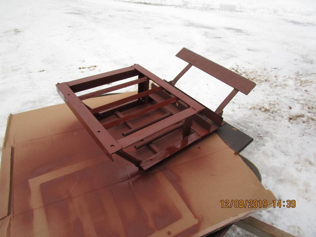

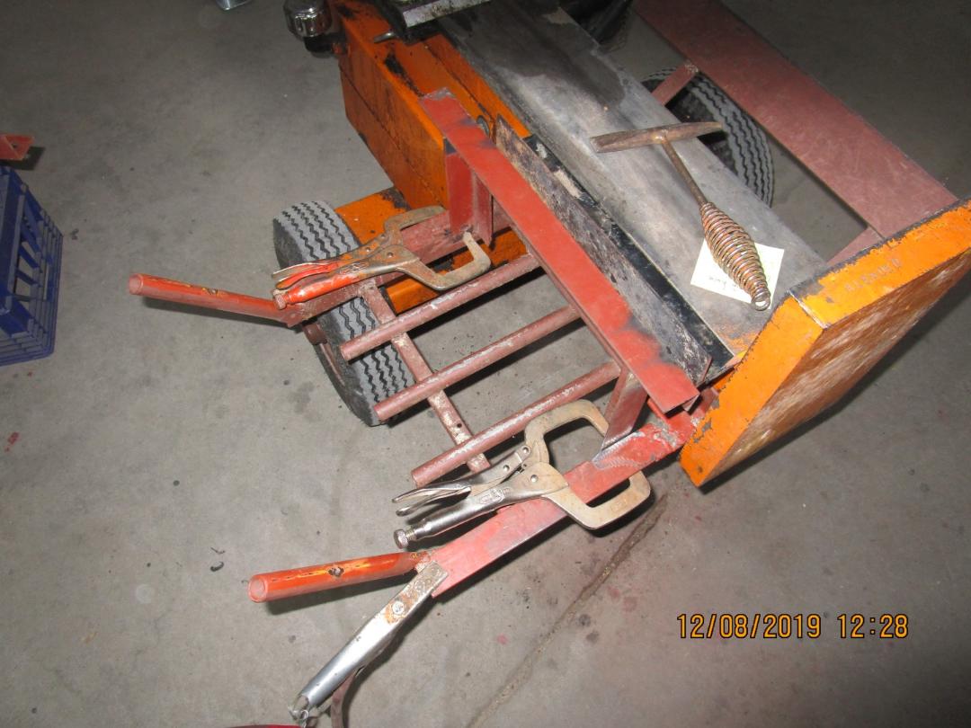

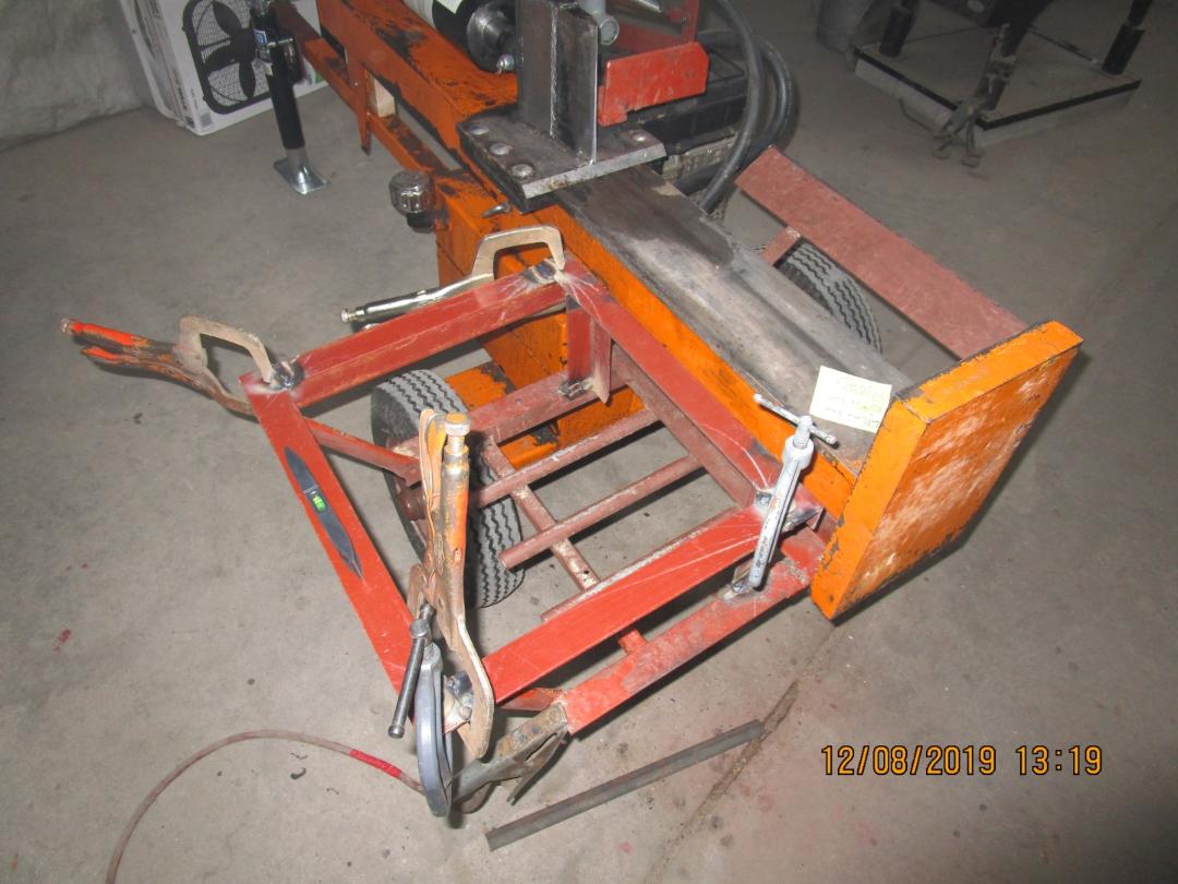

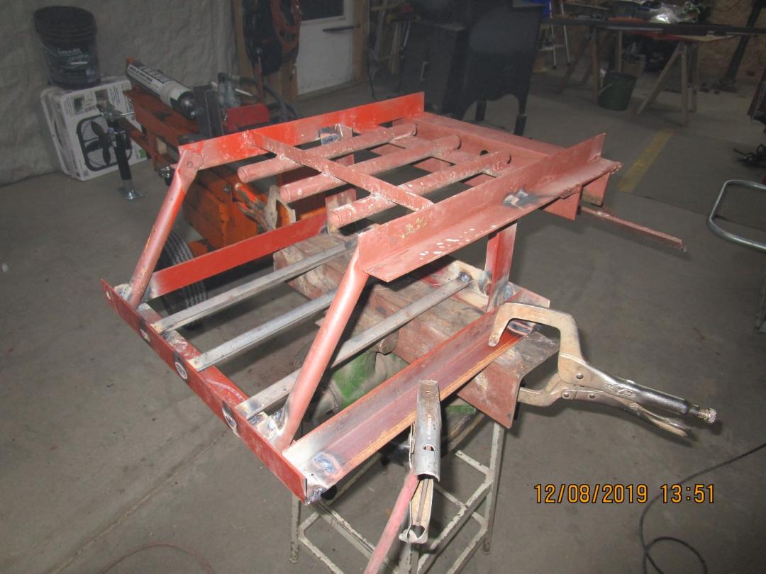

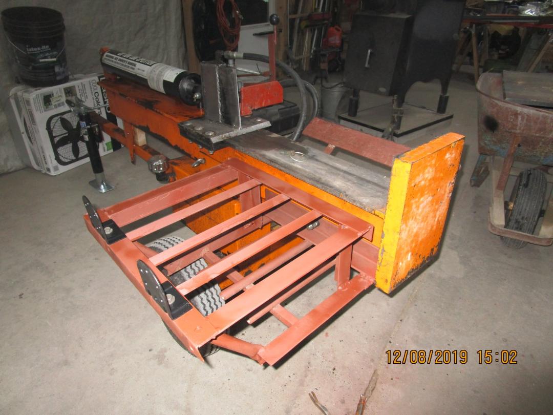

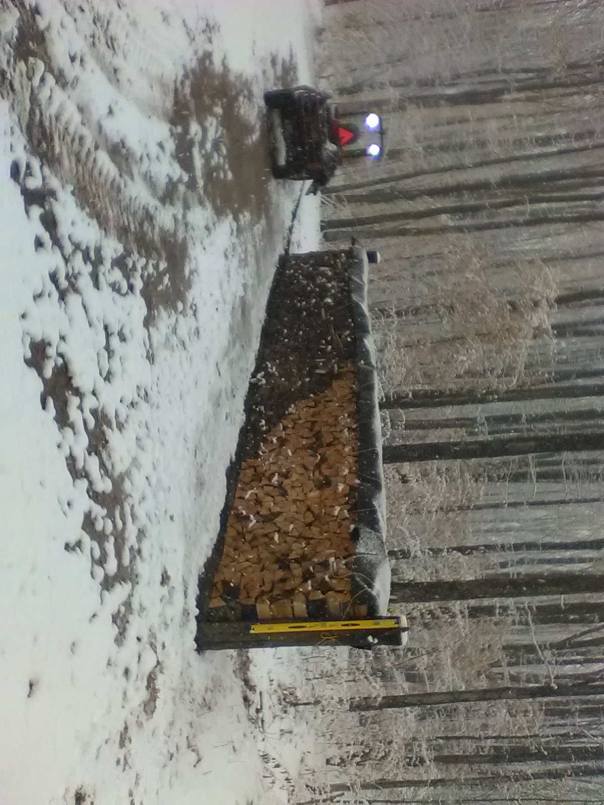

Re-mod'd my old Harbor Freight [ my stuff was bought way back when they first started making stuff in Taiwan ] splitter. Getting too old to put it vertical and horse around blocks. So now going to roll them onto my FEL, raise them up, and roll them onto the splitter table. Started doing it this way last Fall. Raised my old homemade splitter table to be the same height as the working surface. Made it so the log on the wing table will slide a little away from the log I am working on. That was a problem with the original design. And my 2020 winter wood stash out back of the property.
Good work Jerry. Work smarter, not harder!
