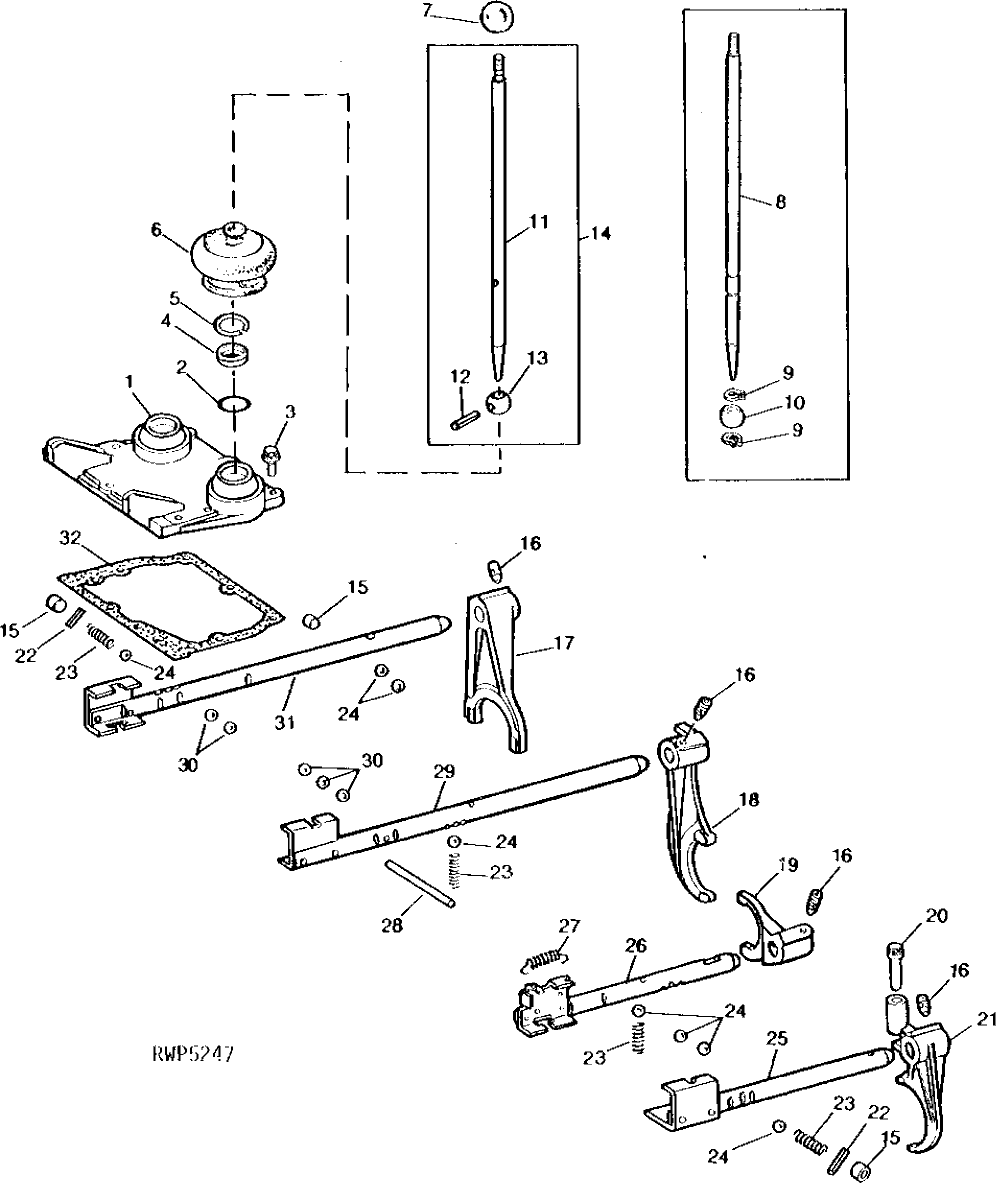

If your tractor is stuck in gear I doubt the clutch is the reason. JD utility tractors have a history of the tab gearshift lever seats into that is spot welded on shift rail cracking & breaking off the rail. FYI 1530's have no synchro's in the trans.

Not that I'm doubting you as I am stupidly new at this, but if I turn the tractor off I can still shift into a different gear. It is as if the clutch will not disengage the transmission.
If I was to look for a cracked rail, which number would it be on your diagram. Or just a name I have the parts pulled up on jdparts.

She starts fine but is stuck in gear.
Stuck in gear as you previously stated and clutch disc not releasing are 2 totally different symptoms. I'd now suggest for you to look into front inspection hole on clutch housing to see if a pressure plate bolt has broken or if throw out brg has worn the end off 1 or more PP fingers.
