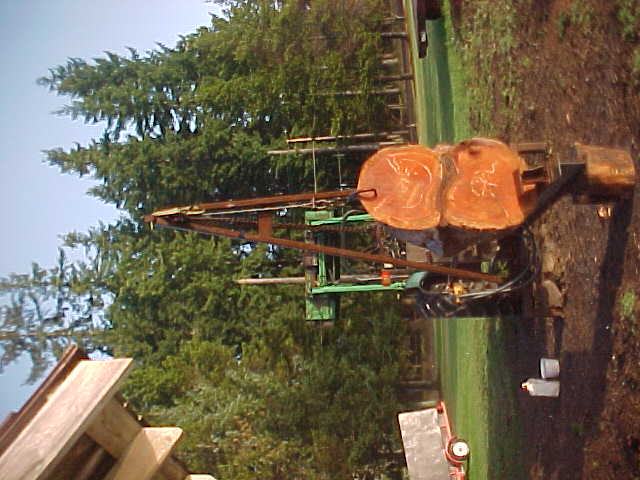

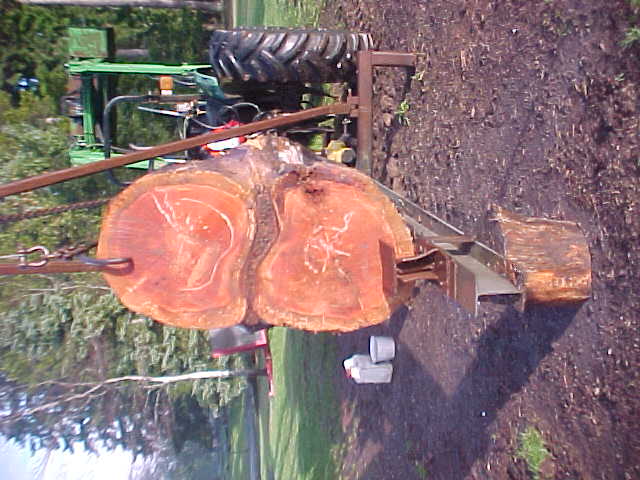

Being a bit of a scrounger I built my own. It is a three point and uses it's own pump run from the pto. It will split a 60" dia block 24" long. I seldom split anything over 48" anymore, but it sure takes the work out of it. The way I set it up is that I built a T knife so that the top of the tee is about 6 inches from the rail. By doing this I get two pieces off the bottom of the block without splitting the block as it stays in the tongs. As I eat the bottom from the block I will change the tongs and rotate the block as needed to finish it off. The best part of the system is the hyd winch and A frame that brings the block over the knife, no lifting required with this system, and I can drag the blocks right to the splitter from a reasonable distance, or pack the whole system to the log with the tractor.
Will put up some pics if anyone is interested. It is starting to get a bit rough, been splitting wood for 23yrs with it.

Ok, the following pics should show the simple design. Hope this can help someone. I built this around 1983 and has been used every year. For the most part I hook up my B5100 kubota for the pump as it has the 1000 rpm pto and has enough power to split anything I have come up against. I just set this up for pictures as you will notice that the 3pt isn't attached. As long as you don't put high sidepulls on the boom it is heavy enough to handle most wood freestanding. Just backing the tractor close enough to hook the pto makes it handier to use the tractor to bring logs to the splitter.
