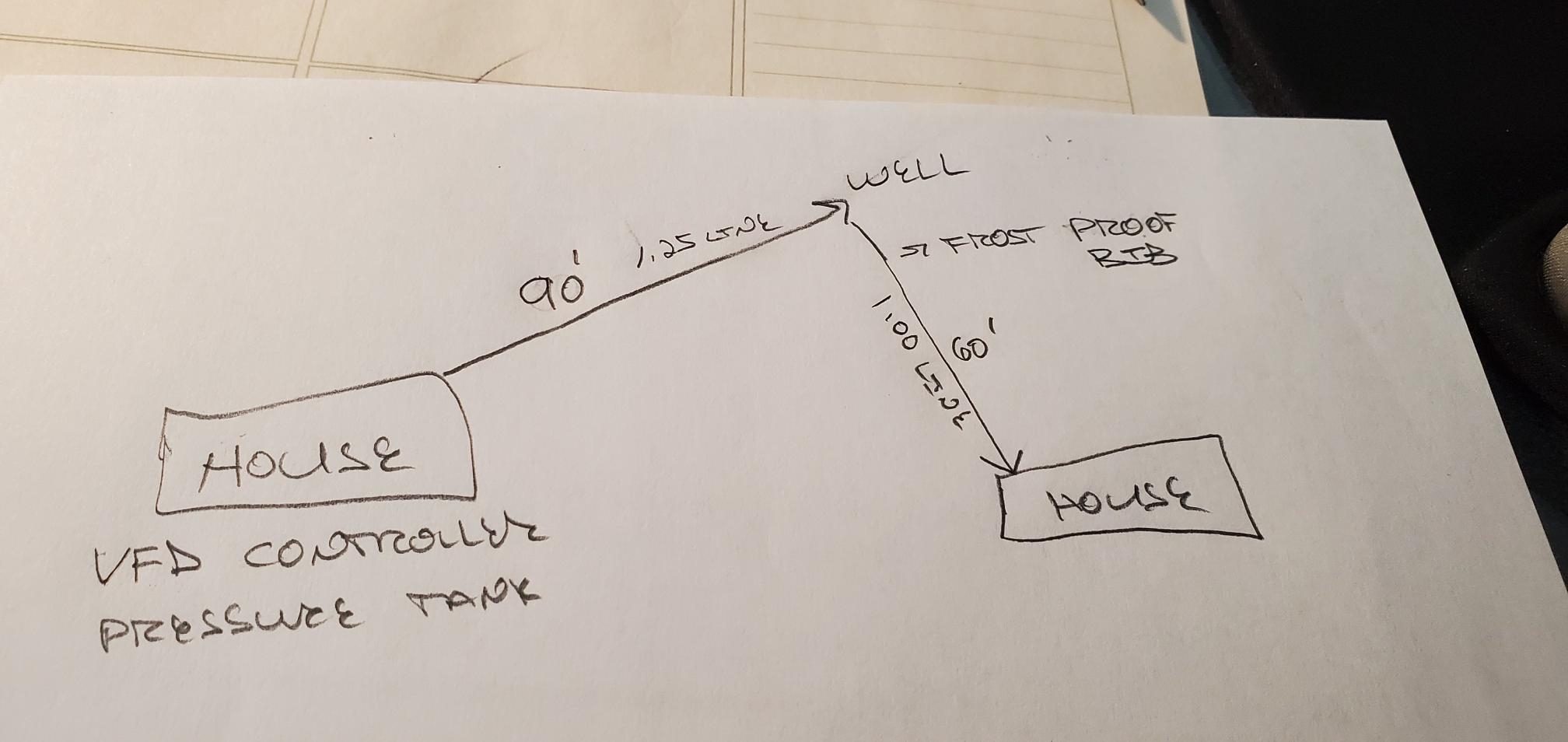

   / Splitting well line #8
I have a similar setup. One well feeds two homes. No issues that I can detect from having the pressure tank on the other house. As once any water is drawn through the frost proof bib or the other house, the line pressure drops and the well pump kicks on. The only check valves are in the well drop pipe itself.

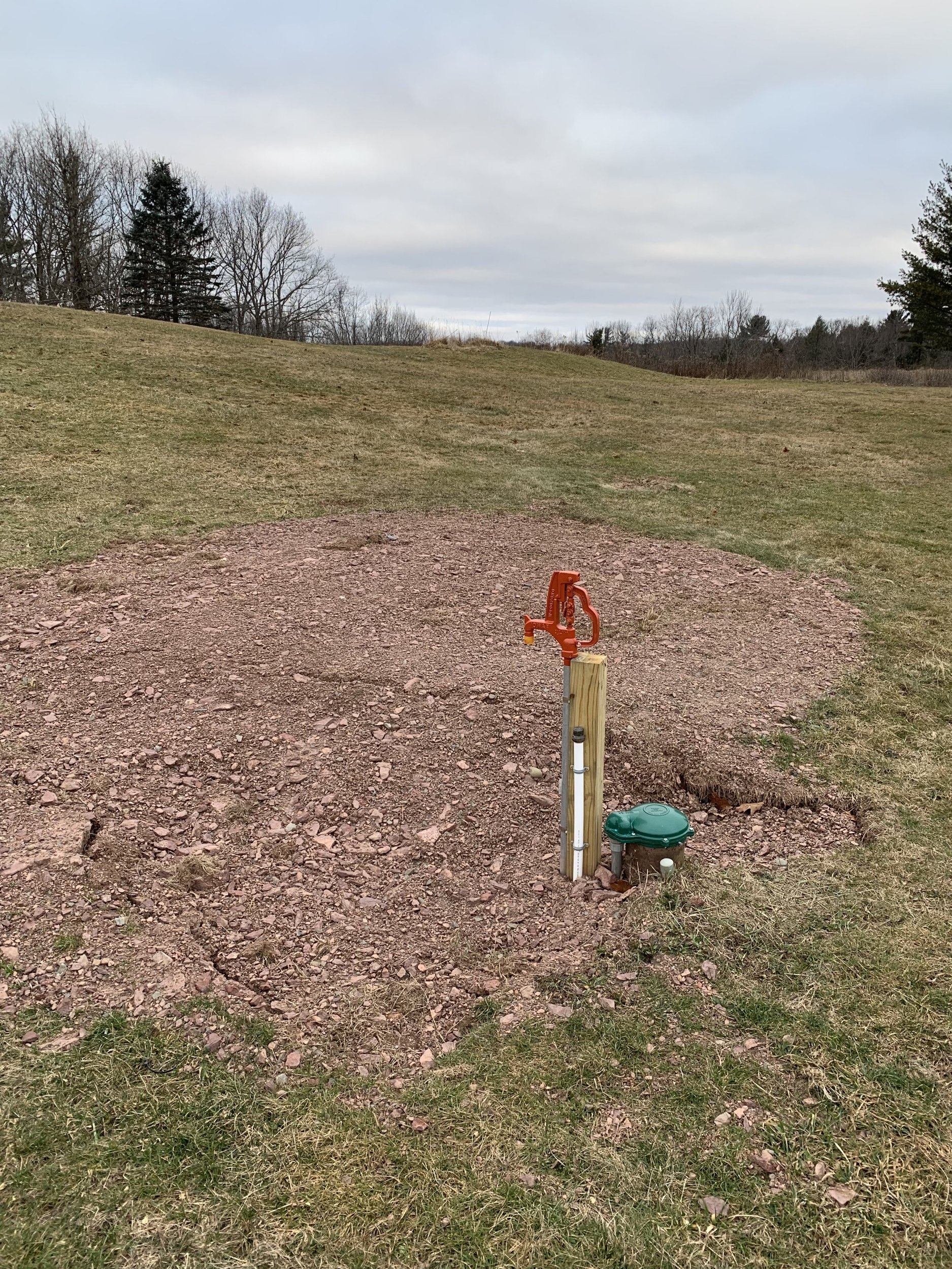

This is pretty common in my area. It's also common to have a check valve on the tank. We remove the check valve from the tank and install one under the pitless adapter.
   / Splitting well line #16
Had to dig up & replace a broken pitless adapter last year so I put a tee on the new adapter and installed a hydrant:
The tank is located in the barn about 200' away. I took off the check valve at the tank and it works like a champ.
