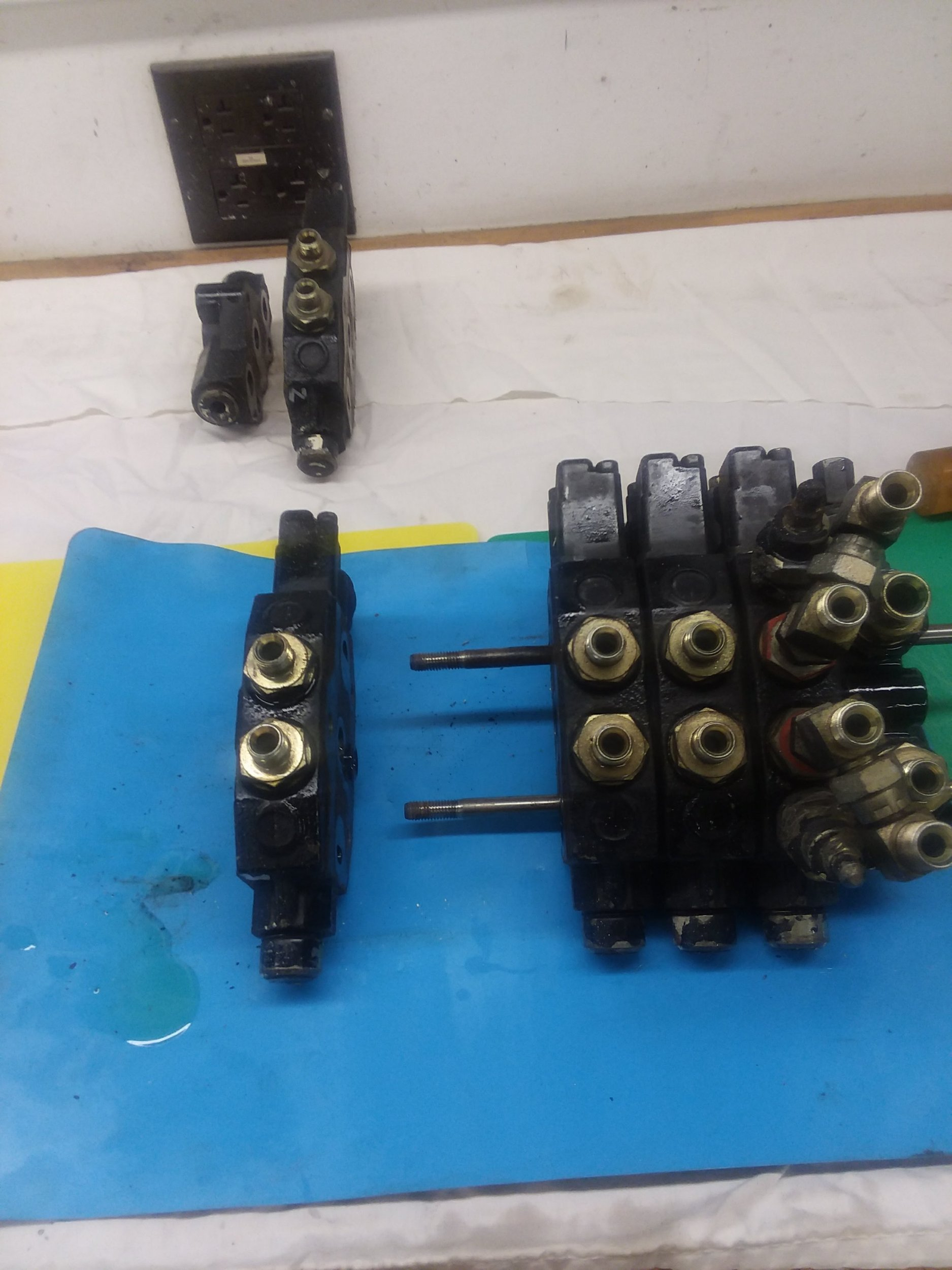

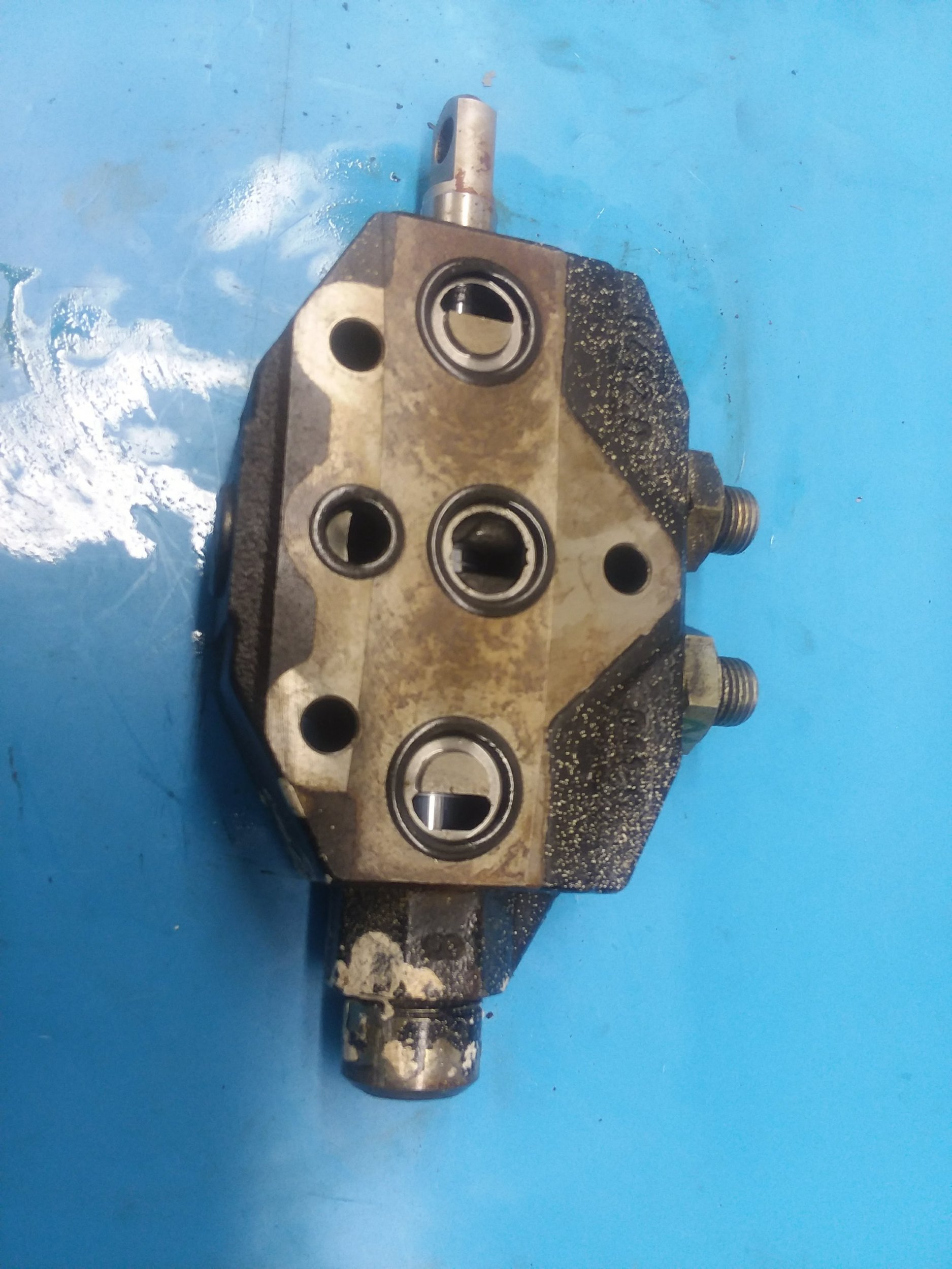

Before you spend any money, I would clean things up like LD1 said and pull that canister and confirm the oil is leaking around the spool. If you really have to replace the spool, you have to replace that valve and spool together, that's big bucks. I've attached some photos of valves I've had apart, you can see how the orings seal between stacks and they're held together with long bolts.

Thank you @LD1 & @BeezFun. The pictures help tremendously. I'm also happy to see flares on the hydraulic in/out fittings as I didn't know what was being utilized for sealing and was thinking I might need to buy more orings / crush washers.

I wouldn't try to replicate the leak, but rather get a whole seal kit for the valve and just reseal. The spool and bore most likely is fine. You can look at the leak on the tractor by removing the bonnet and trying. The bonnet is a cover, not a retainer.
Second, I would not take the valve bank apart if you can avoid it, but definetly take it off of the tractor to work on it on the bench. This will avoid disturbing the sections and having to buy the section orings.
Last, you might be able to identify the valve maker; ie: Husko, Bailey, etc. and buy the parts through an aftermarket, but this can be more daunting timewise to get the right kit.

Once out there may be some some markings to identify manufacture/series and go direct to them. A valve section for a number of "generic" valves is usually $200-$400 range.
And Tractortech is right......for what you want to replace......really shouldnt need to split the valve sections.
There seems to be several seals in that "float" section. All should be able to be accessed while leaving the assembly bolted together. Same way with the spool seals. You can pull the spool itself out without splitting the sections and replace those seals.
However, the wildcard is if the leak is actually coming from between the sections and just dripping running down and making it look like its coming from elsewhere.
