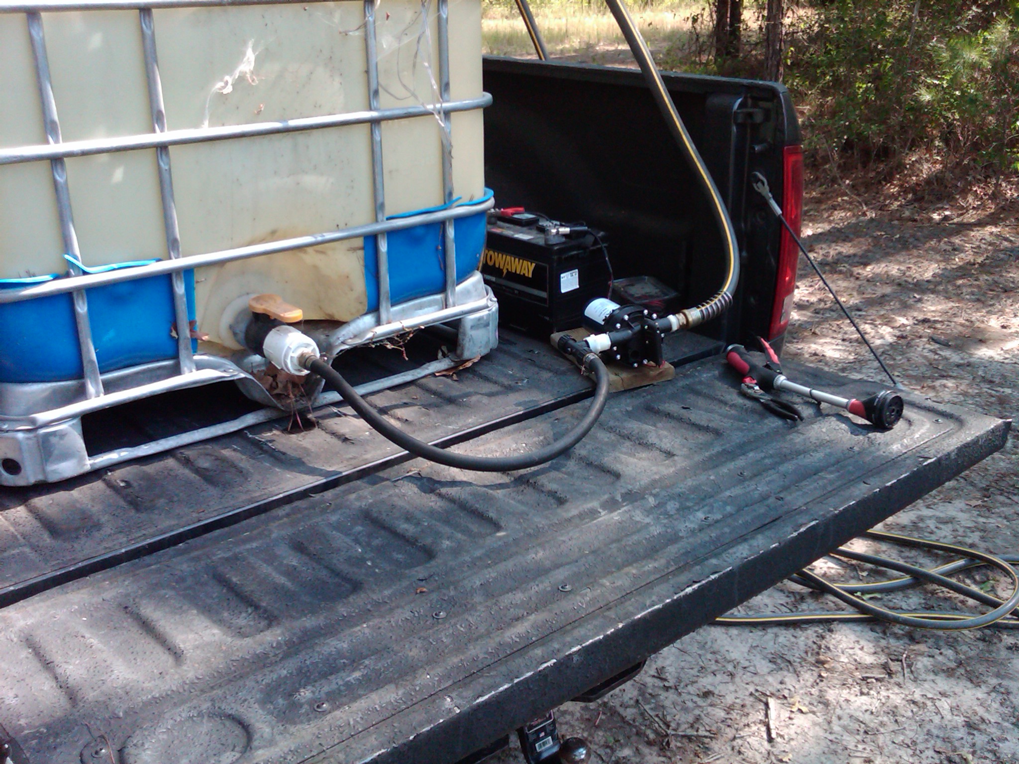

Thanks. I will check those out. How do you have your tank rigged? Is it a trailer? Where do you get a power source? Alligator clips to your battery, or a dedicated battery, or a plug? A good 12 volt pump would sure make my design easier and allow me to use either my truck or my tractor to dispense.
I put the tank in my truck bed and have a remote switch in the cab. I have a battery in the bed and use alligator clips.
I bought a 3 point fork lift frame to try this year. The battery will be tied to the top of the tank and I'll mount the pump on the back. Probably can't lift a full tank but I'll fill it as much as I can.

Several questions. Will a battey last long enough to pump 200 gallons without a charge? Boom or boomless? Got any pictures? Did youplumb it yourself? Any problem going the right speed? Thanks!!

I use a deep cycle battery and it lasts long enough to unload 2 tanks when I water my trees. I have a picture attached of the setup to water trees. I use a boomless nozzle for spraying roundup. It gives me a 16' spray that works very well. I do need a recycle line back to the tank due to my high pump rate. I put a valve in the recycle line to control the width of the spray.
It is easy for me to maintain my speed because my fields are flat and level. I think the tractor would be even easier.

Thanks for the info. I think i will copy your idea! I already have a leinbach carryall that i never use. Just need to buy a tote and pump. That fat boy looks pretty strong. Boomless also seems way to go. I also just bought a wireless fimco remote switch that should work. I need to figure out what boomless tip and what height to mount it. I guess a inline filter/strainer would also be good. Keep us posted on your progress. Thanks again

DEFINITELY use an in line filter. I found one at Wal-Mart that has hose connections and a wire screen. Look in the garden section. Zoom in on the picture to see the filter connected at the pump suction. I have cleaned it out numerous times.
You need to experiment with the height of the nozzle to get the width you want and to prevent wind drift. My nozzle came with an adjustable bar for height and a few C bolts. I don't remember where I got mine but Agri Supply should have one.
BTW, be sure to use a "deep cycle" battery. They are better designed for long use and constant discharge.
