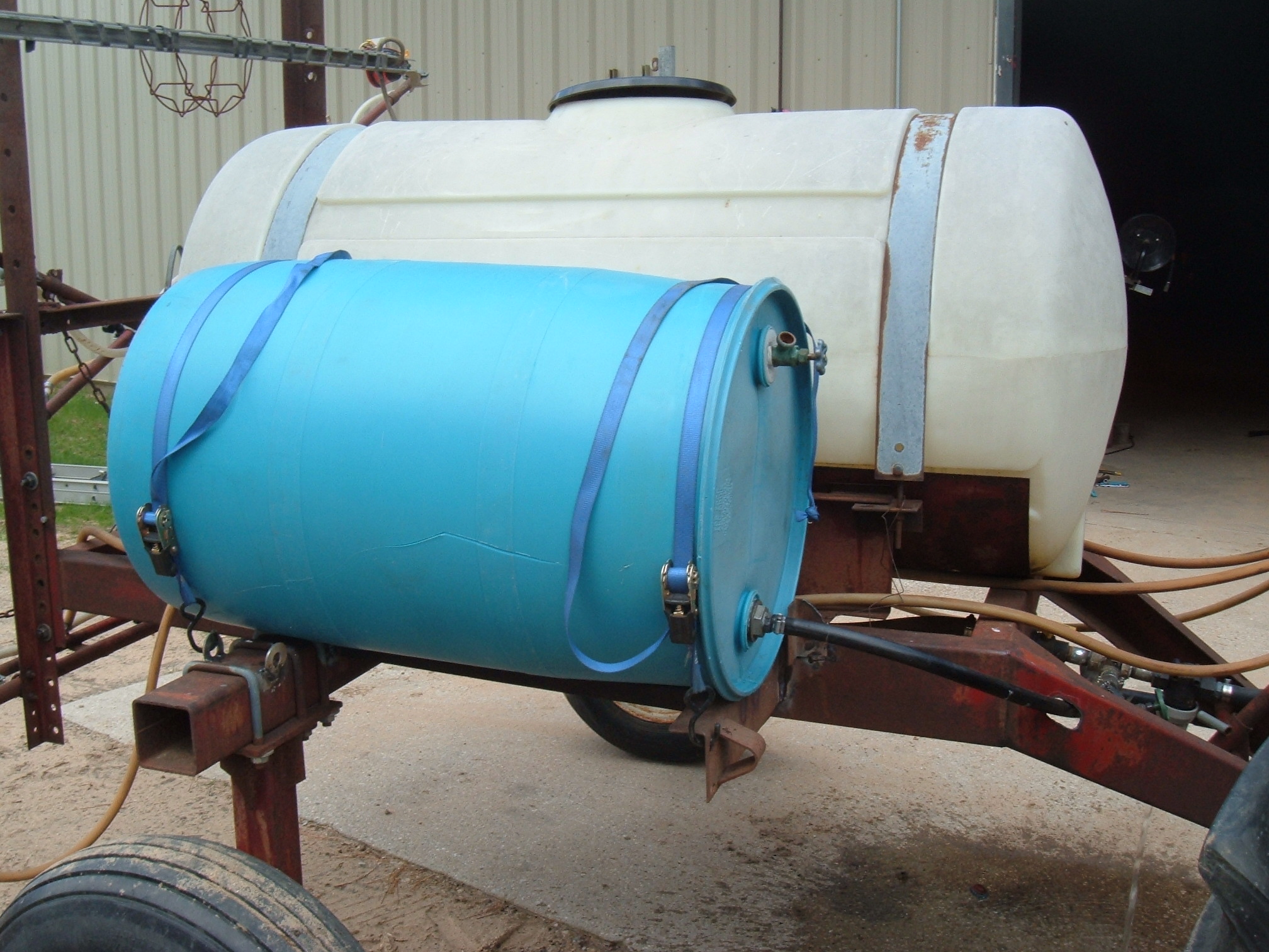

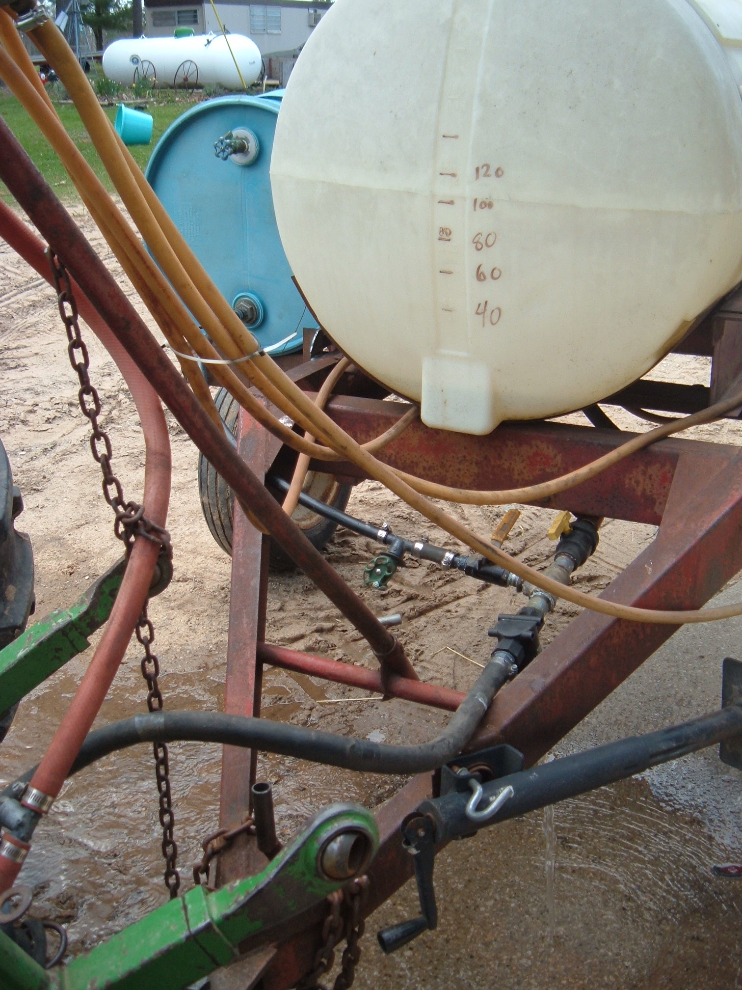

12v are dinky. Pto can have a lot of power. A pump, a larger one about 10 gpm maybe is a bit over 100$ on the shelf at a farm store and needs way less speed at low volume. Depends on how much you want to run. I added a fresh tank to this boom job, so much faster to be able to field rinse and purge fresh thru on the spot for any repair. I remove the pump and gage and air clear it for winter.

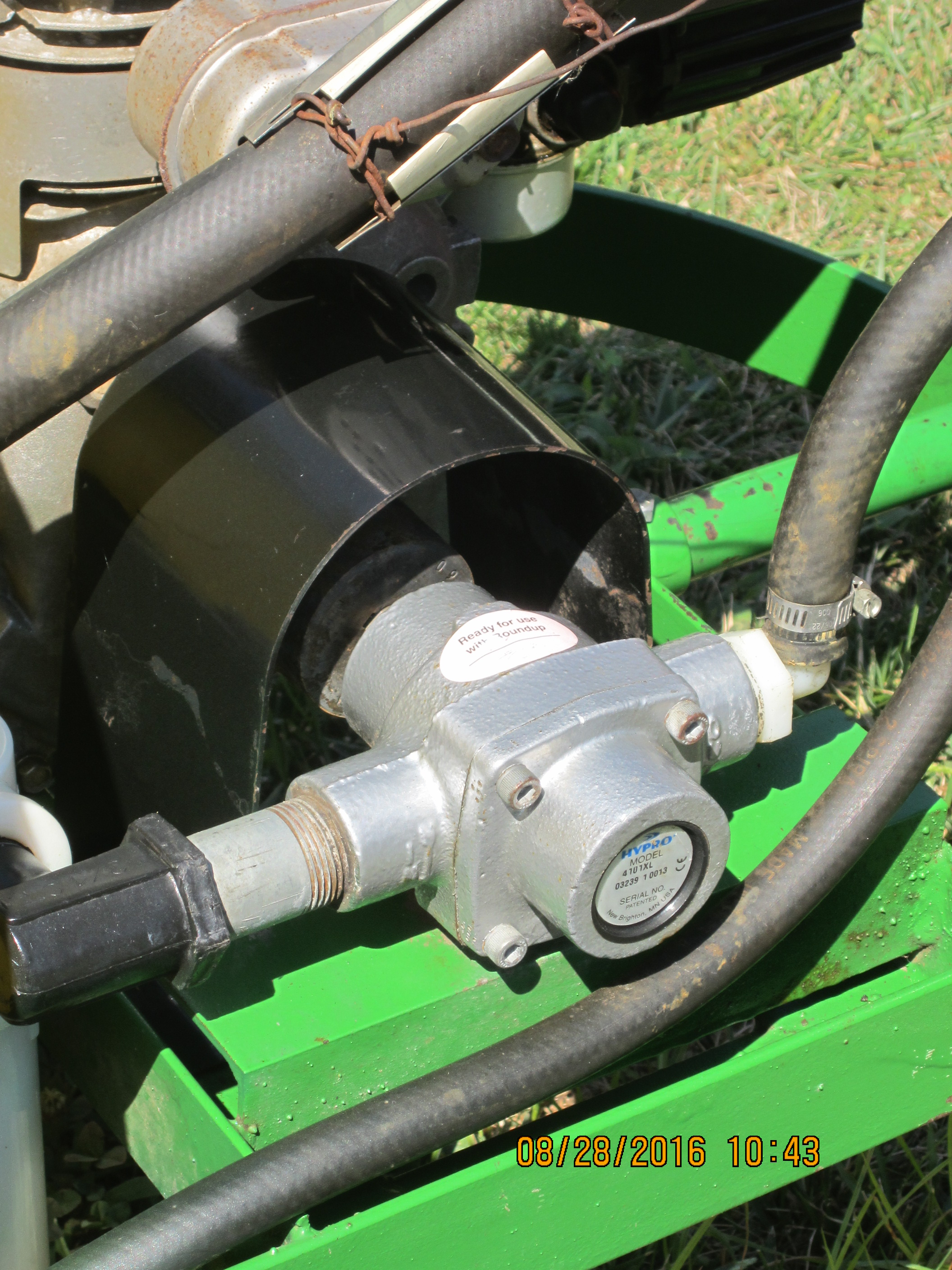

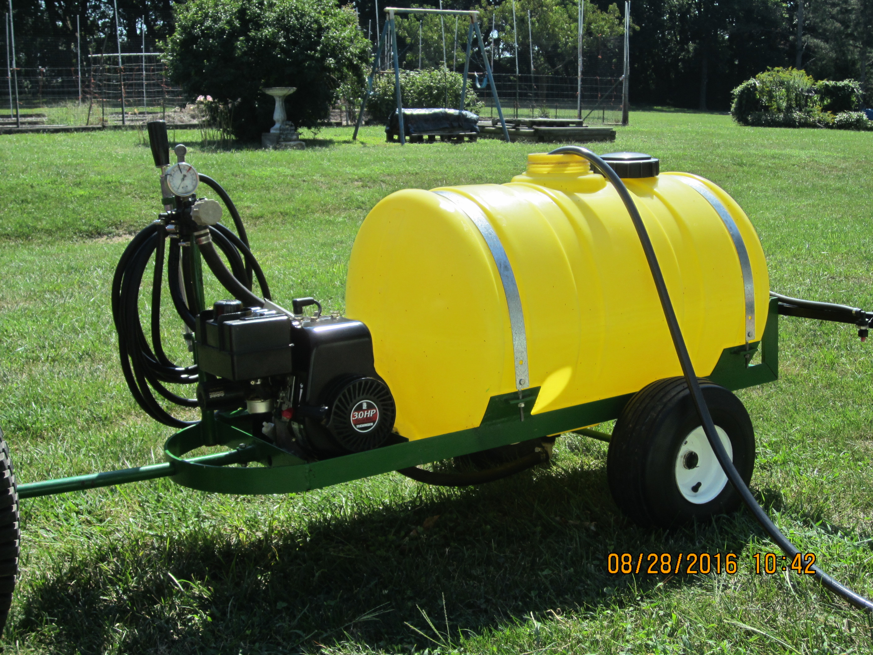

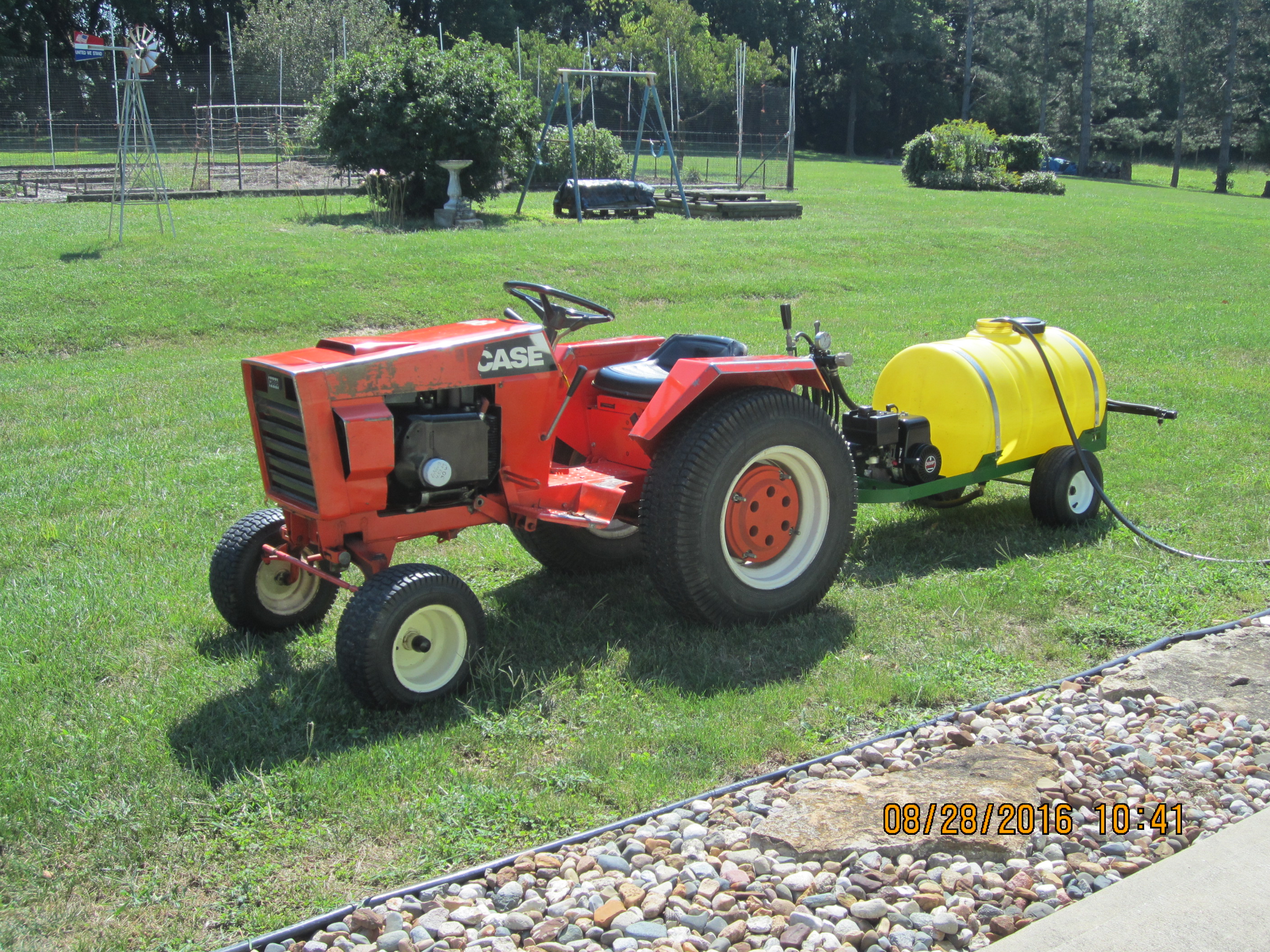

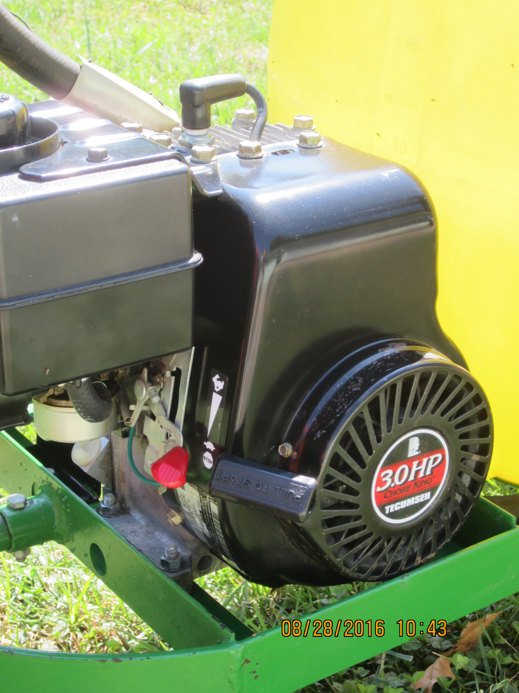

There could be some advantages to this set up.......like above.....you need not tie up your tractor PTO. At 100psi it will spray about 30 vertical feet for Cedars (Bag Worms)...and spot spraying or using the boom (about 8 feet pattern) on my three acres.1206.JPG1207.JPG1209.JPG1210.JPG. It has a 4 roller Silvercast pump and 3.0 HP gasoline engine.
Cheers,
Mike

Hi bigtiller.......I bought this as a unit in July of 1998....it was $900 thru my local Kubota dealer. It was made by a company in western Kansas that is no long in business
Cheers,
Mike
