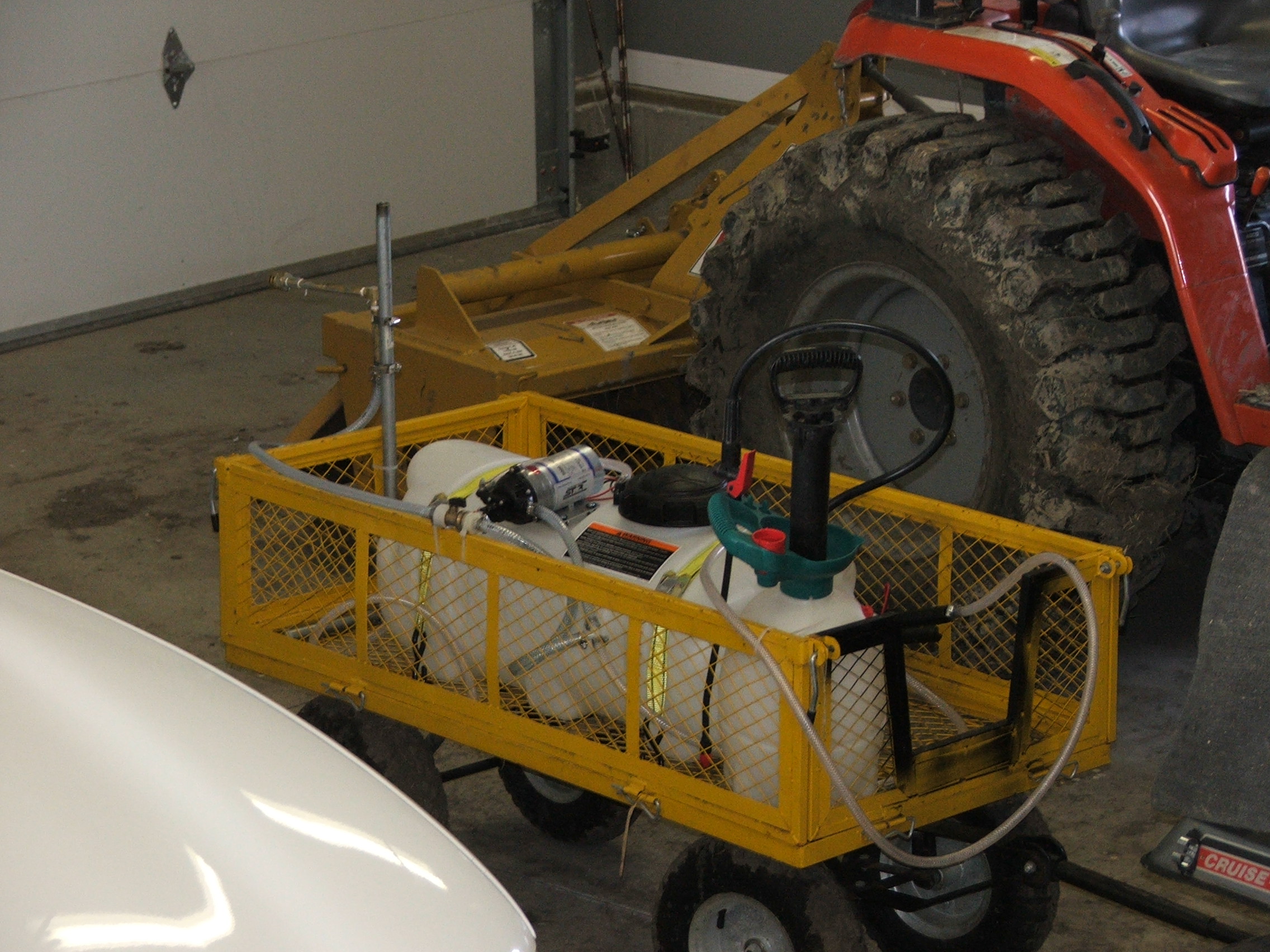

i have converted one to a boomless type, it seems to work good as long as there is no wind at all.

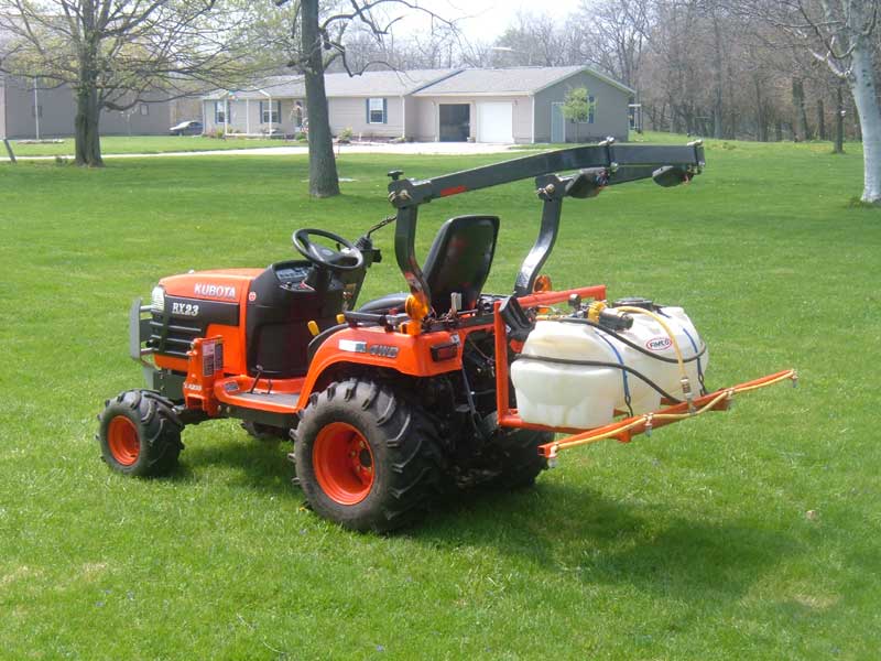

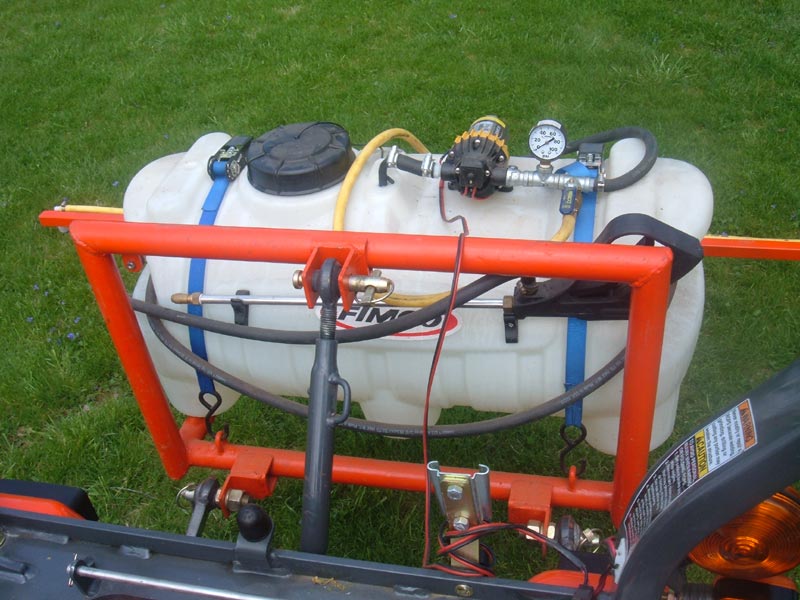

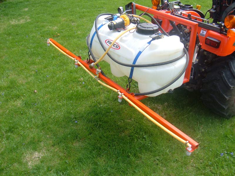

I did that exact thing I used 4 standard nozzles on about a 7 foot boom. It is on a 25 gallon wand sprayer setup with a 2gpm pump. It used to maintain about 20 psi now it's lower, the cheap guage quit on me so I don't know exactly how low but it still gets good coverage. I think I would use a couple of those boomless sprayer nozzles instead of building a long boom if i did it again. I was worried about drift and wanted to get the boom as low as possible to the ground and still cover the area. I took many trips up and down the driveway experimenting with different nozzles and boom heights.
I want to upgrade the pump to a 3gpm pump sometime but it works rfor now.
Here are somer pictures of my setup.

Most of the 25 gallon spot sprayers have a pump large enough to handle a small boom. Most of the pumps are rated in GPM at a given pressure. Most nozzels are also rated in GPM at a particular PSI so you know how fast to spray for a given coverage. If you can get pump and nozzel specs, you can put together the right combination. I think mine is 2.1 GPM at 40 PSI. I started out with a 80" coverage 2 nozzel boom and had no problem maintaining 40 PSI at the boom and was still dumping liquid back to the tank. I calculated that I could add another nozzel for 120" coverage, and still maintain 40 PSI with no excess being returned to the tank. This works great for me.
I was going to build my own originally, but after looking up all the parts, I found it pretty hard to beat the cost for a 25 gallon spot sprayer and a basic 2 nozzel boom kit($47?) from Agri-supply. The original manufacturer was Fimco, and I was able to order a matching additional nozzel and "T" from them directly when I upgraded to a three nozzel boom. I built a tow behind cart for it out of 1" box tube and two wheelbarrow wheels.
