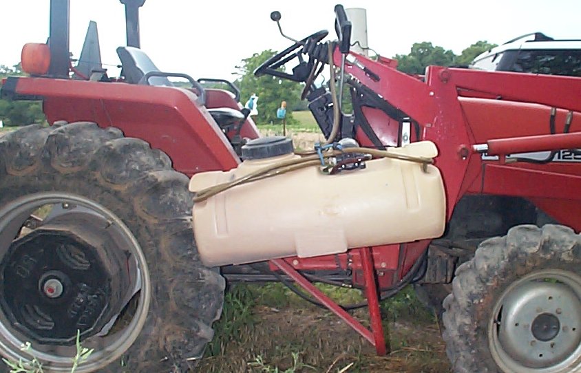

Well, after ingesting more chemicals than one probably should due to having the sprayer in front of you, i went out yesterday and bought a 3pt carry all and set the sprayer up like this:
MUCH BETTER!

Mathey,
That looks much better too. I had a feeling that you wouldn't like that sprayer up front, for just that reason. It's easier to see what's going on but harder on the body tissues.
How do you like your new sprayer? Will it spray to the tops of 12 foot tall trees? I have a few tall trees that need a couple of applications each year. I'm debating on whether to get the 12 volt model you have or to get a PTO driven pump version.

</font><font color="blue" class="small">( Will it spray to the tops of 12 foot tall trees? )</font>
Not the way i have it set up in the photo. I would imagine you could modify the boom and its mounting to be up that high. Which is something i'll need to address next year when my trees are bigger.
The sprayer works really well for what i need it to do. As of now, we only need to spray once or twice in June for bagworms and the trees are only about 2 feet tall.

Mathey, for what it's worth, this is the way I do it as well... I grew up on an apple orchard and knowing that the sprayer always follows the tractor (for reasons you have experienced), I decided to use the sprayer on a carry all.
Nice looking set up

oh yea, one more note... experience with this set up has demonstrated that having lateral rails (sp?) set up is a wise move. I have a 65 gallon tank that slid off my carry all... I went back and set up a more permanent solution to ensure that this would not re-occur.... /forums/images/graemlins/shocked.gif the fun part was waiting for the 65 gallons of water (luckily it wasn't insecticide) to drain.... /forums/images/graemlins/blush.gif

This is the same setup I'm using now while my atv is out of commission, only I have a 25 gallon sprayer and home-made 6 foot boom. I use it to spray a 3.5 acre lawn for weeds, and for burndown before planting food plots.
mathey, you've probably already discovered this, but for others that have not, with the boom riding almost 4 feet behind the rear tires you have to watch the boom. When the front tires start up a bank the rear of the carryall (the boom) can dig into the ground unless you lift the 3ph.
