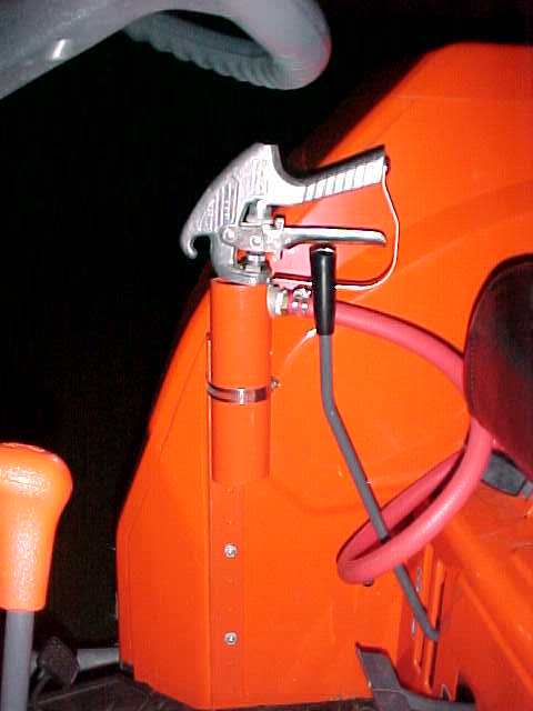

Here is a photo of my spray gun, at my finger tips in a quick-draw holster made of PVC.

I like that holster,I use our BX to spray with,put the FEL to offset the weight and it handles it just fine.Doubt if the weight would be a problem for Mike either.
