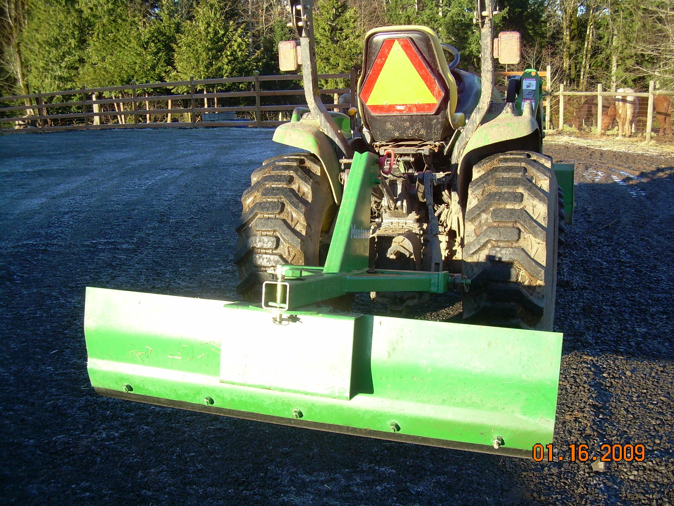

what i do is dump the bucket all the way out and drag back the gravel. If you get a pile up of gravel at the end on the spreading area, use the grader blade and put it at an angle to the left of right backwards. loose gravel slides under the blade leaving a nice finish.
Dragging your bucket in the full dump position, will eventually bend or break one of your cylinders. The correct way it to have the bucket tilted forward no more than 15 degrees.
The correct way is to have the bucket tilted forward no more than 15 degrees.
He didn't say anything about the bucket he was referring to the Back Blade,
Read his post above again.
