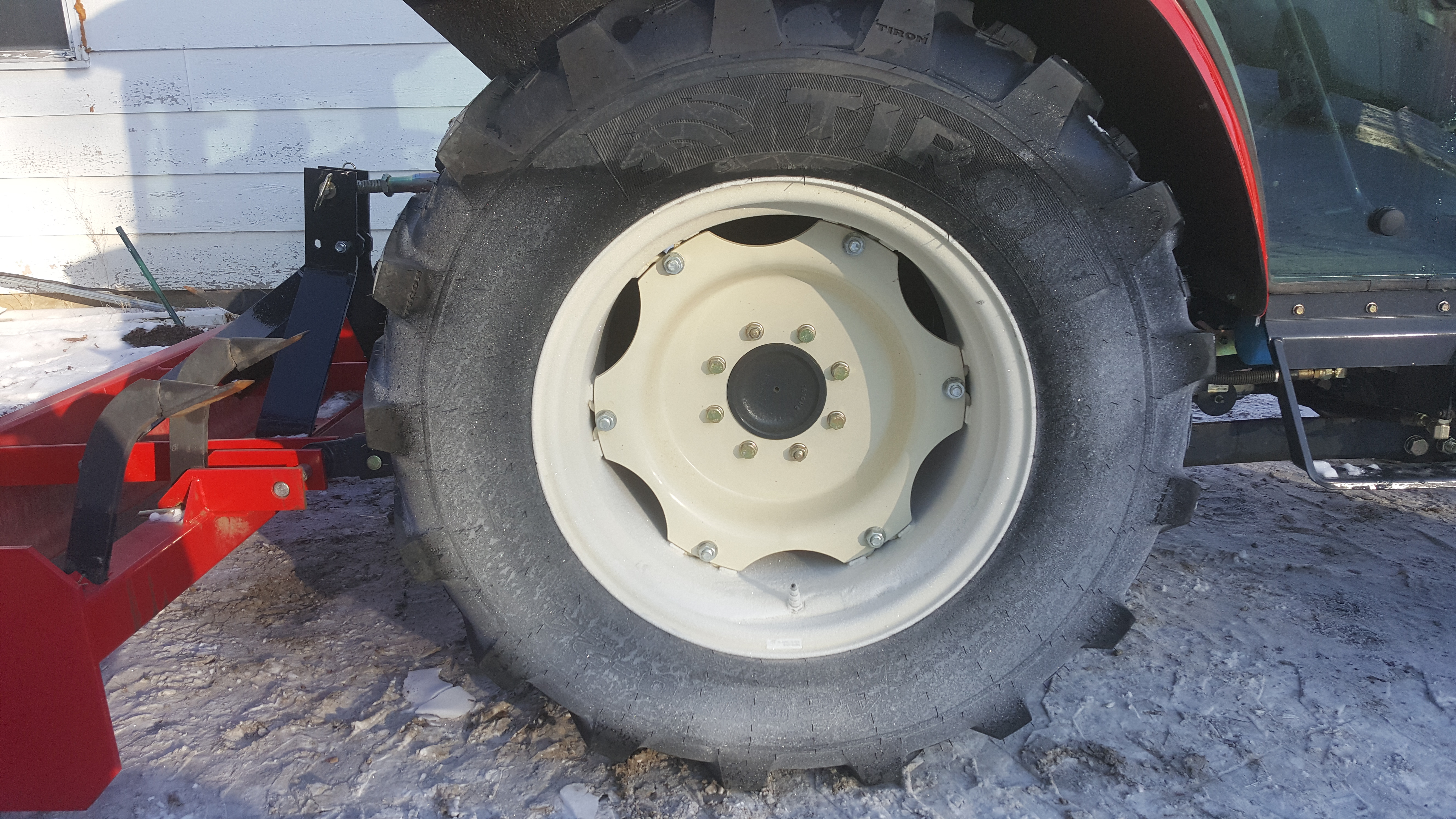

That being said, I believe my wheels are set up in the second to widest position. The centers are flipped from ptsg's configuration, but I believe my rims can go "out" to the outer setting. With my R4's, I am hovering right around 70"s right now, from outside side wall to outside side wall.
Here is a pic to show you what my rim is set at now:

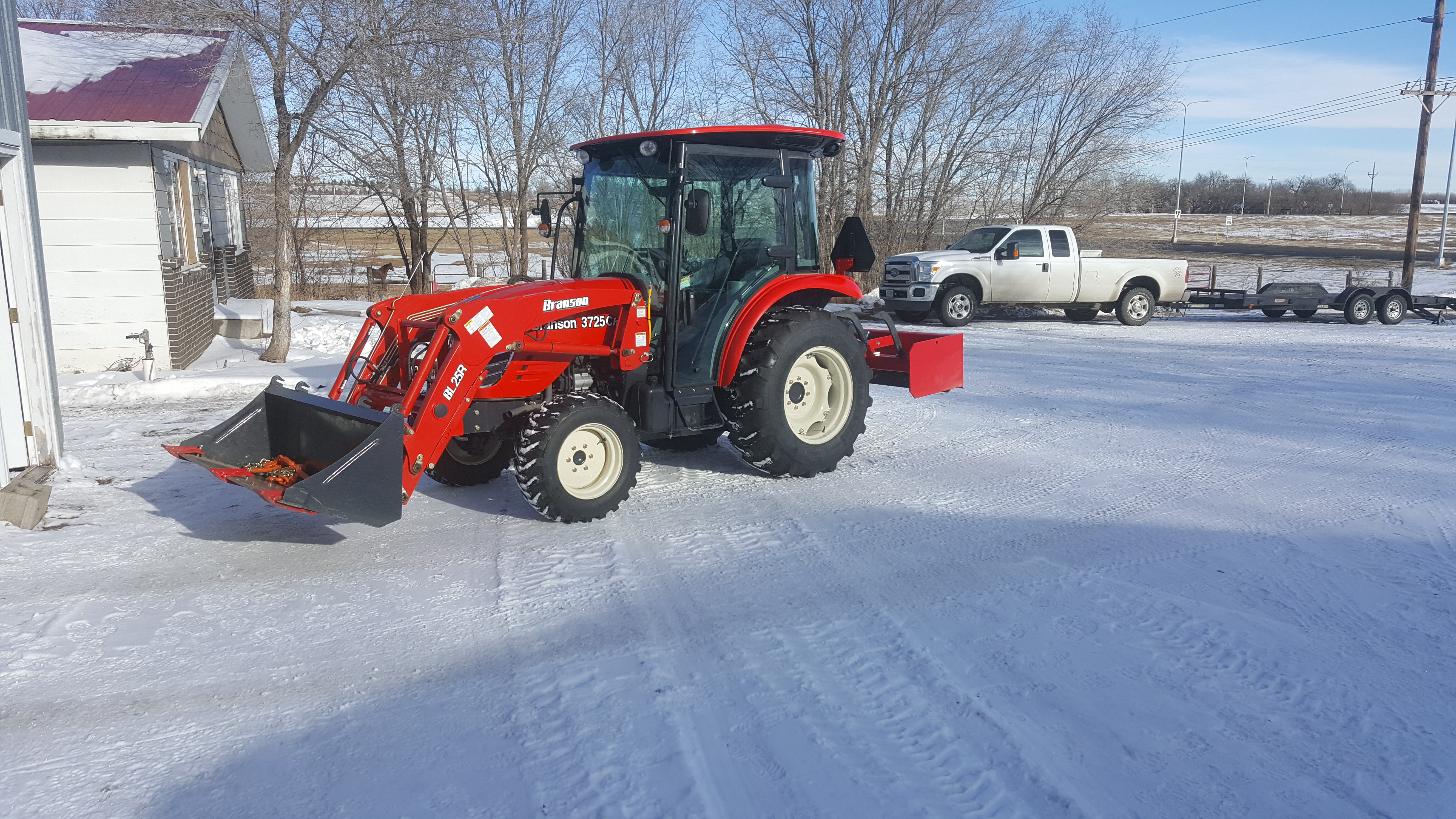

Also, the front rims can be set with either centers "in" or centers "out", but there is no additional adjustment between the rim and center. If you look at my fronts in this pic, and compare it to ptsg's picture, you can see the center dish on the front rim is "out" on mine vs. ptsg's.
With my wheels set this way, the front and rears track in the same wheel tracks as far as width goes. Bearing in mind that my rears are filled, I have been on side hills of 20 degrees, but only when the ground is dry and firm. It is all I would attempt, and there is much "pucker factor". That is also keeping my FEL as low to the ground as possible, and not raising my brush hog off the ground. I try to avoid this much side hill whenever I can.
If your slope angle is much less than 20 degrees, I don't think I would be too concerned. Just make sure any implements you have on are at there lowest position, and make sure the ground is fairly stable and dry. And of course, go slow, and avoid "bouncing" at all times.

That first pic of the rear tire is interesting,
looks like the rim guard got below freezing and froze some frost to the rubber up to the air point.
Yes, I thought it was a cool pic when I took it. If I recall correctly, it was around -30 F when I took that picture (it was last winter actually). I think maybe the Rimguard in the tires was colder than the tire itself, because the sun had come out and was shining on the surface of the tire's sidewall, and had warmed up the tire above the temp of the Rimguard. I recall using the tractor that day, and the Rimguard fluid was not frozen, as I would have felt that once I started moving the tractor.
I think the coldest the air temp has gotten in the last couple of winters has been once it hit -42 or -45 F. And the Rimguard still wasn't frozen. There was probably slush in the tires, but it's not frozen solid yet. Not sure we'll see anything lower than -45 F (not counting windchill that is) here, so hopefully they don't ever freeze solid on me.
