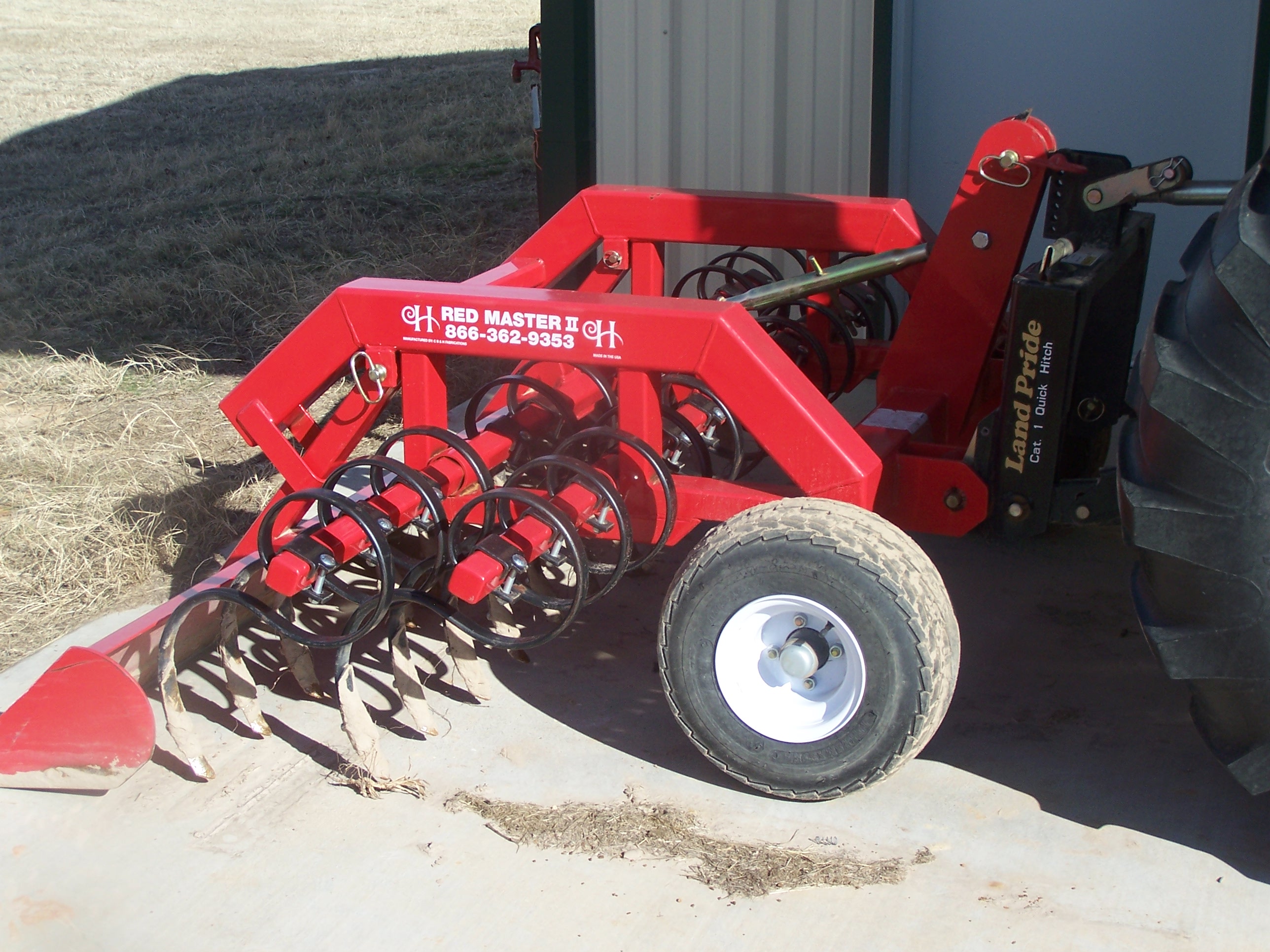

Footing is everything in an arena. Bad footing is the easiest way to get a permanently lame horse. The footing varies greatly depending on the discipline, English vs Western, dressage vs jumping, roping vs running barrels, etc. Like Sailfast said 1 1/2 inches isn't much and it does move around. You need to drag it to level it and you can get in the base material quickly with that little of depth. I use a Red Master II harrow with adjustable tines to drag our dressage arena and it would be difficult to not get into the base.
I think you have the right idea on equipment to move it in to the arena. A 4'X4' drag harrow with short tines would work good in that small of a space for final leveling. TSC has them but the tines are 5" long. A small section piece of chain link fence works pretty good as well.
