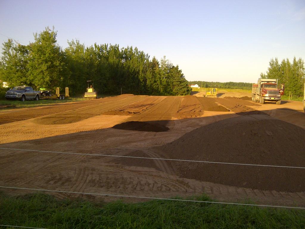

might see how much it cost for a slinger truck to deliver. might be a couple more hundred but all you have to do is sit back and watch as the material is spread for you. then just a couple of passes with the arena drag and your done.

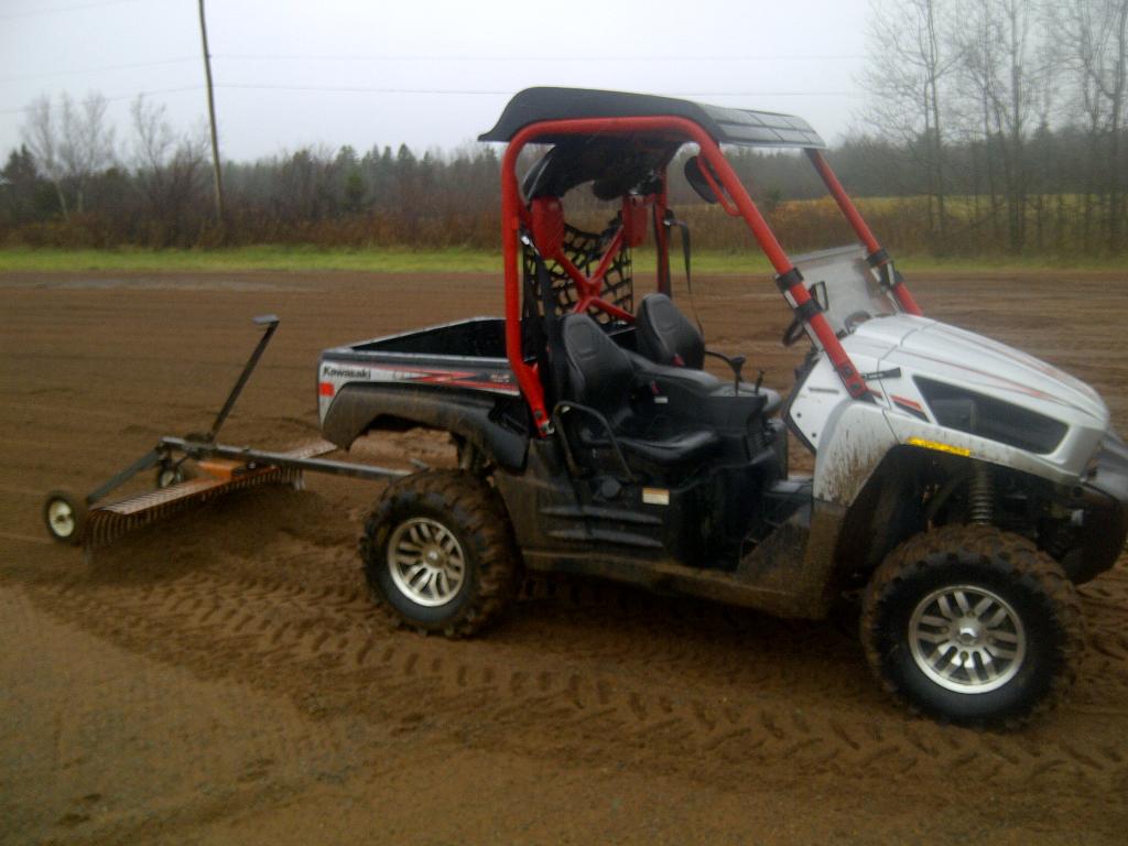

18 yards is only 60 trips with your FEL or so? If they are dropping it on a pad just outside the arena door then just get in your seat and get er done! It will take multiple passes with the york rake, but it will flatten out soon enough. Just be careful not to dig down too deep with the rake.
I don't have a 3PH rake, so this is how I keep my outdoor in shape.

I presume you have already checked and the truck will not fit in the door of your arena? If you can get the truck in, get the driver to put the chain on his dump door and move forward as he dumps. That will give a good even spread and give you a head start on spreading it out. They did that when I had my outdoor put in.

If your existing base is fairley level and bump free use 2x4's laid flat for screeds for your box blade. 2 long 2x4's on each side of your piles of sand you bring in to your arena. Screed it with the box blade lightly scimming across the 2x4's.
Excellent idea. Thanks.
Good idea about spreading with the truck but the truck wont fit in the arena.
I think I'll just bucket it in with the Kubota and spread it around. I'll try the screeding idea and also try the york rake.
