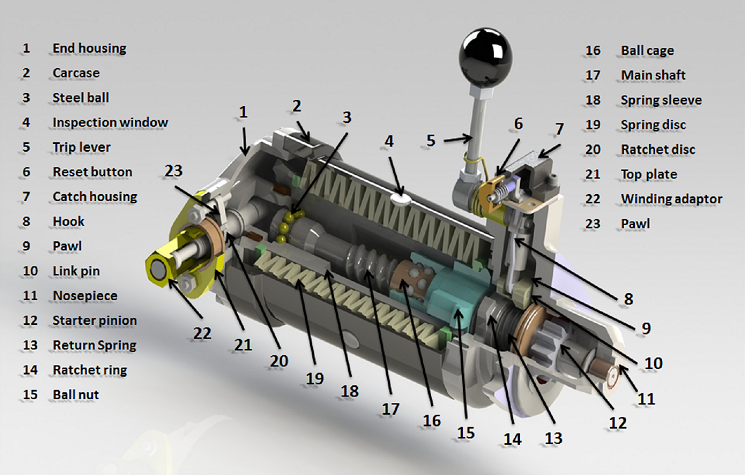

Never heard of it, Google showed me what it is. Spring starters Simms, Lucas, CAV mechanical starter motors from Kineteco Home Page

Does your tractor actually have one or are you just curious?
These starters exist in the poorer parts of the world where people cannot afford batteries.
You crank for a while to build up energy in the compressed spring which you release to turn over the engine.
It is an upgrade in technical terms from the hand crank.
The other alternative is a heavy flywheel which you use a crank to spin up to speed and then there is a mechanism to connect the spinning flywheel to the engine crankshaft.
