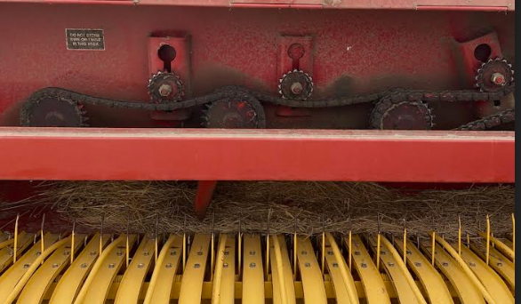

So you are admitting that your model 575 that you sold does had several chains. I'm very familiar with a right angle gearbox to power plungerhead & other functions on a small sq baler as JD sq balers have a similiar PH drive box.
I'm not that familiar with NH sq balers but I think a chain powers knotter via frt drive chain in 1st photo below.
I failed to locate in a 575 NH parts catalog a knotter drive "gearcase" although I located 2 knotter drive gears that operate in the "dust" not a gearbox. I noticed NH is very proud of that sheave/gear combo(item 45) @ $4,115.83 in 2nd photo & to think folks bash JD about the price of their parts.
Last 2 photos were taken of my neighbors NH 575 chains

Second picture is the hydraulic pump drive. Your neighbors NH is filthy as well. I'd never let mine collect that much filth.
   / square baler trouble shooting #45
At least my neighbor knows his 575 has several drive chains. You should have noticed your 575 had several drive chains when you cleaned your baler up!!! FYI 1st photo is of sprocket & chain to transfer power from hypoid right angle gearbox driving an actuator arm to remainder of baler
