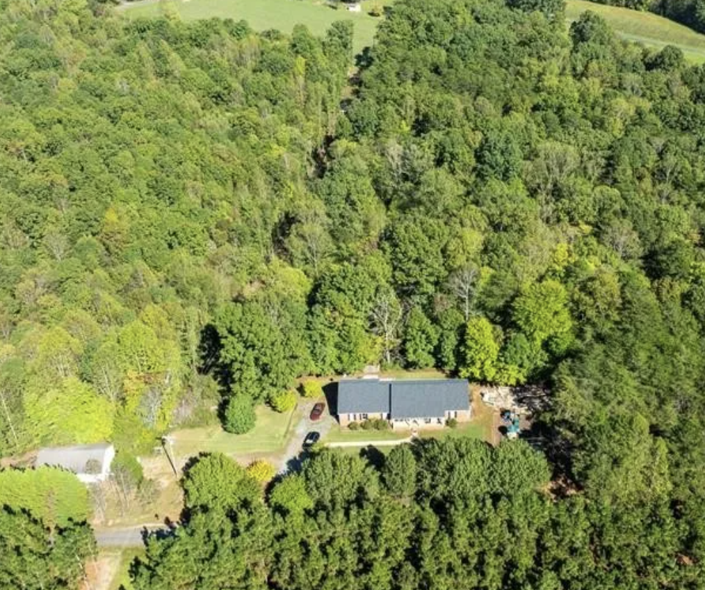

After looking at that 1,900 sq ft house Sunday and walking it in person, I do think we can get by easily with 1,500 sq ft home for my wife and I and MIL, along with a guest.
As others have said and what we noticed Sunday, is that layout of the space is key.
The house we looked at also had 7 acres, but the land wasn't laid out very good in our opinion for use with a very small lawn. Did have a detached garage along with a 2 car garage which we did like though.
