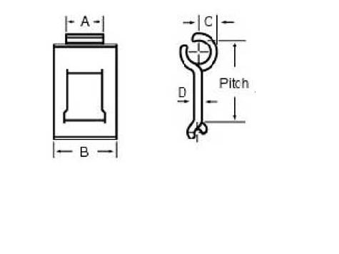

I've bought some new drive chain(#52) for my model B John Deere grain drill and I seem to have forgotten how to separate it to make it the proper length. I've tried driving the links sideways lining up the slot and the more broad way lining up the slot. It seems like there used to be a trick I'm missing, but it's been so many years I can't figure it out. Any ideas out there?:confused2:

These links don't have pins and side-links like roller chains have. Each link is one square piece with one side a cylindrical housing of sorts with a slot and the other side a flat side with a rounded edge made onto it for wear. Then each side of the link is just a flat leg. Each link is identical and made in one piece.
They're so hard and springy I can't get my vise tight enough to hold for as hard as I have to hit to drive the rounded edge down into the slot. I can remember doing this many years ago to shorten a worn chain, but I don't remember ever tackling a new one that won't slide down into the slot.
And even if I master this part of it, (I'm trying to make two chains of 38 links each from a new 100 link piece), I must wrap each around the drill sprockets first before reconnecting the two links of each new chain, so this must be done on the grain drill and not at my vise!
I'm really staring to look more and more over at my blow torch !!!!:confused2:

The tool has a flat side, so stand that flat side on a firm surface with the slots facing up.
Slide a link down into the smallest/narrowest slot it will fit in. Then turn the next link 45 deg so the opening is lined up that has to slide apart. Hammer that next link to slide the two apart.
Here is a pic of the link.

At that site, can also see the various types of links that each slide together to make the chain. They should help to see their individual parts and openings.
