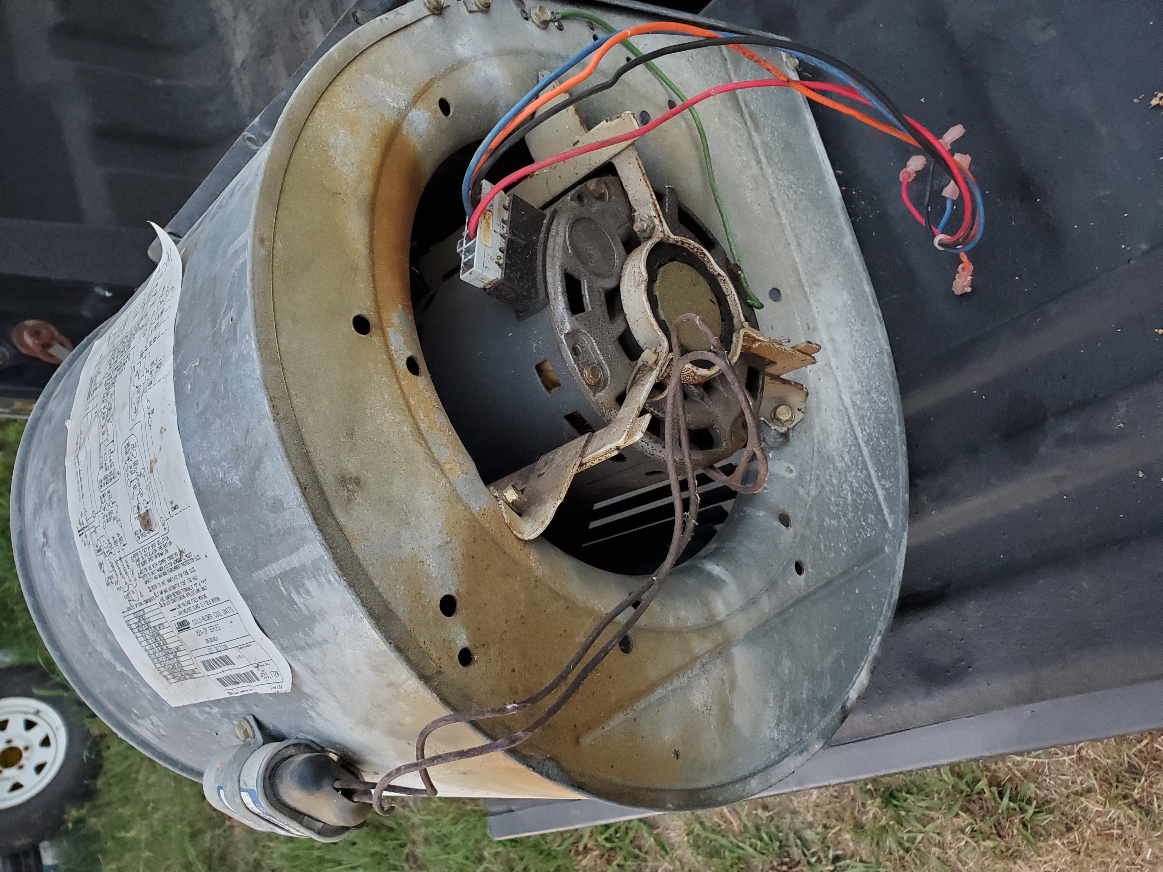

Trying to get me a better fan for my shop. I need some help on the wiring.
I am assuming the Black is hot, the other colors are for the speed, and the green is the ground.
I have an extension cord I am using to wire it up and its colors are white, black, and green
Here are some pics.
Thanks 20190526_201907.jpg20190526_201911.jpg20190526_201916.jpg20190526_201907.jpg20190526_201911.jpg20190526_201916.jpg
   / Squirrel cage fan wiring
#2
I have the orange to white. Black to black. Green to green. Is that right?

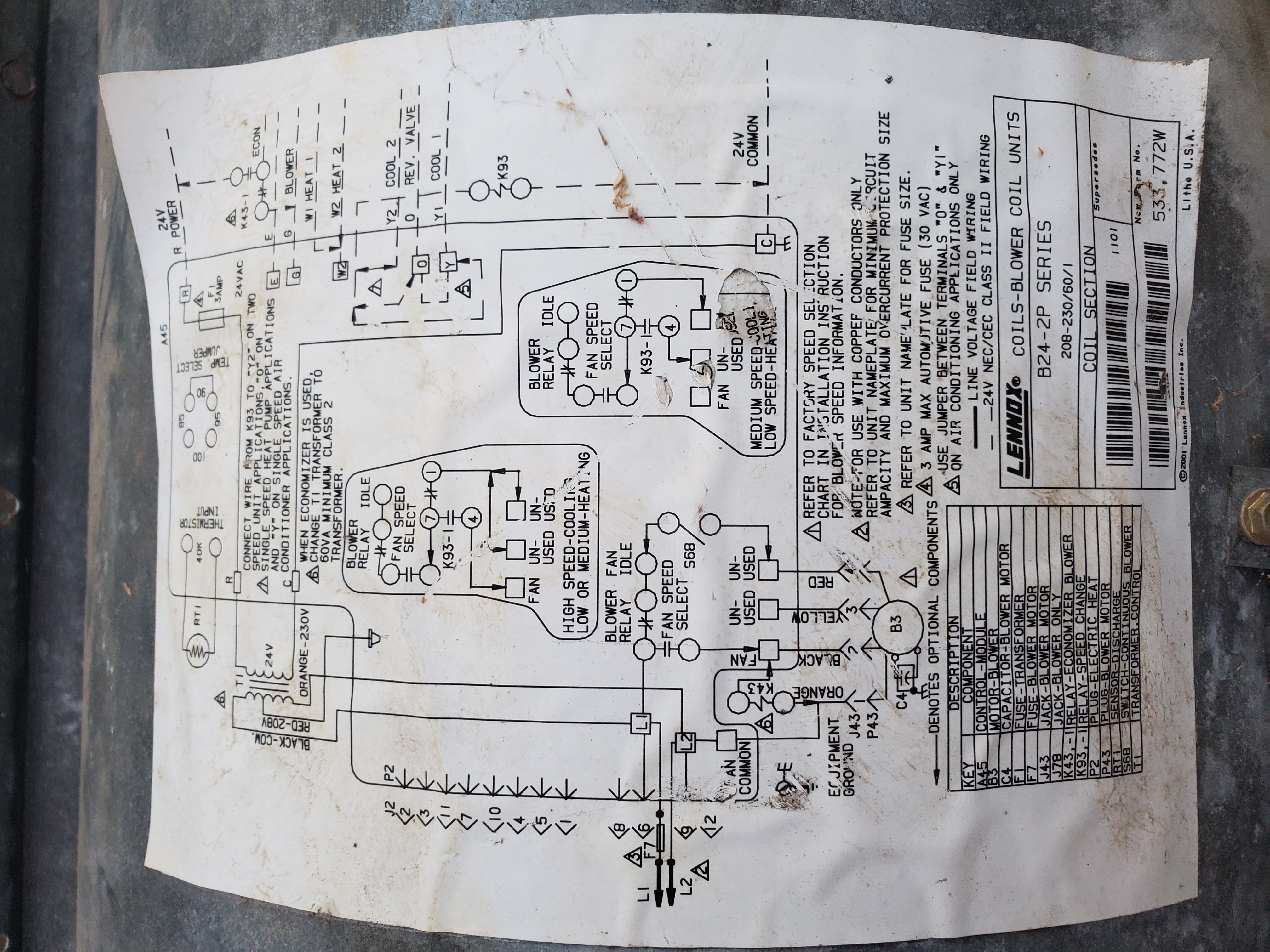

I'm no electrician but according tho the wiring diagram I would hook up
White on the cord to orange on the fan
Black on the cord to - black on the fan for high
- yellow on the fan for medium
- red on the fan for low
Green on the cord to any metal component on the motor housing. Not on the fan housing as it could insulated from the motor.

Ok sounds like how I got it. Here I go! If I dont respond back..you know I got fried!
It works. But looks like I may just get a big shop fan. Doesnt throw out like I would want it.
