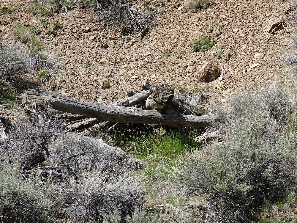

This is a collapsed dugout in a known Chinese woodcutters camp in central Nevada:

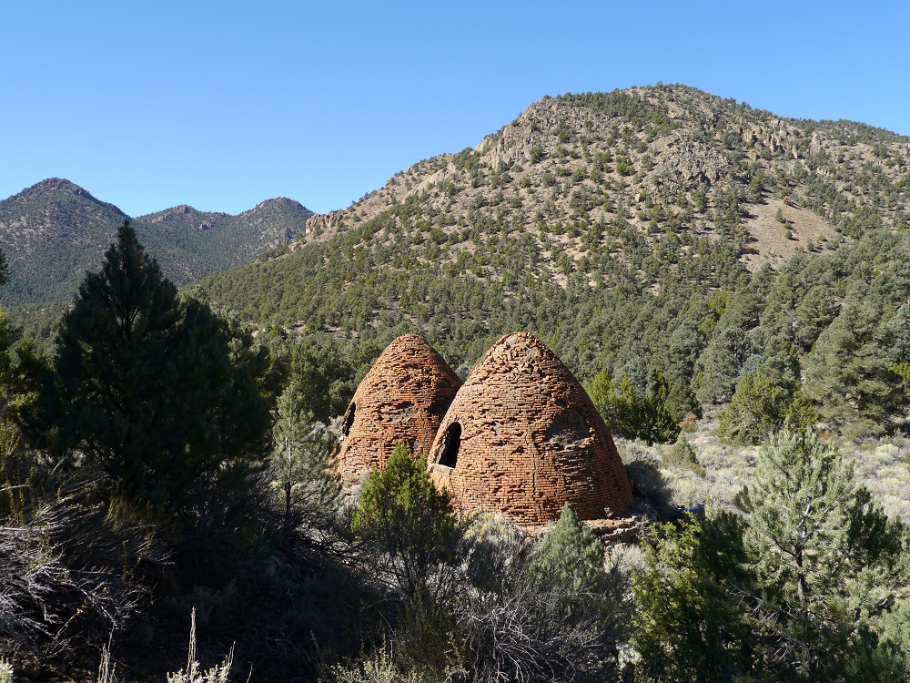

A couple ancient charcoal kilns in the central Nevada mountains where juniper was turned into charcoal for smelters:

deserteagle71--Absolutely fascinating.
   / Squirt extra bar oil on chain when cutting? #10
Those are nuclear silos
