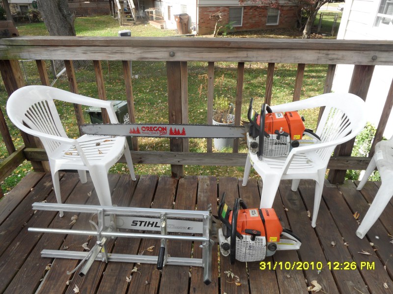

My Stihl MS460 has a adjustable oiler but it still wasn't enough oil for big-dead-dry oak. The 460 full wrap model came with a higher output oil pump so I bought one and installed it. Then, the standard 460 pump was installed in the 361 to up the output with that saw.
   / Squirt extra bar oil on chain when cutting? #16
For decades, I squirt extra bar oil on my chain and bar when the saw's working hard on bigger wood. I have an oil can with me and squirt some on every now and then. It's not that I cut a lot of wood it's just that I that I thought it helps the chain.
Is adding oil a good idea or am I wasting my time?
Stihl attempted to be environmentally prudent and, at least on their larger saws sold in the US, started installing oilers that put out less. They also redesigned their chains to use oil more efficiently.
I've 2 660's and an 088.
They all ran fine with a Stihl size recommended bar, but on the 660's that's only up to 32" with Stihl chains. When I started CSM with a 42" bar the oiler couldn't keep up. If I used a non-Stihl chain with a 30" or 32" bar. again, not enough oil. And at that time I had trouble getting Stihl chain for milling.
But Stihl 660 saws in other parts of the world had a higher output oiler. So I bought and installed those and can now splatter oil off a 42" bar when the oilers are turned up.
So to answer sixdogs - you may not be wasting your time, depends on your saw. But you may be saving your saw.
