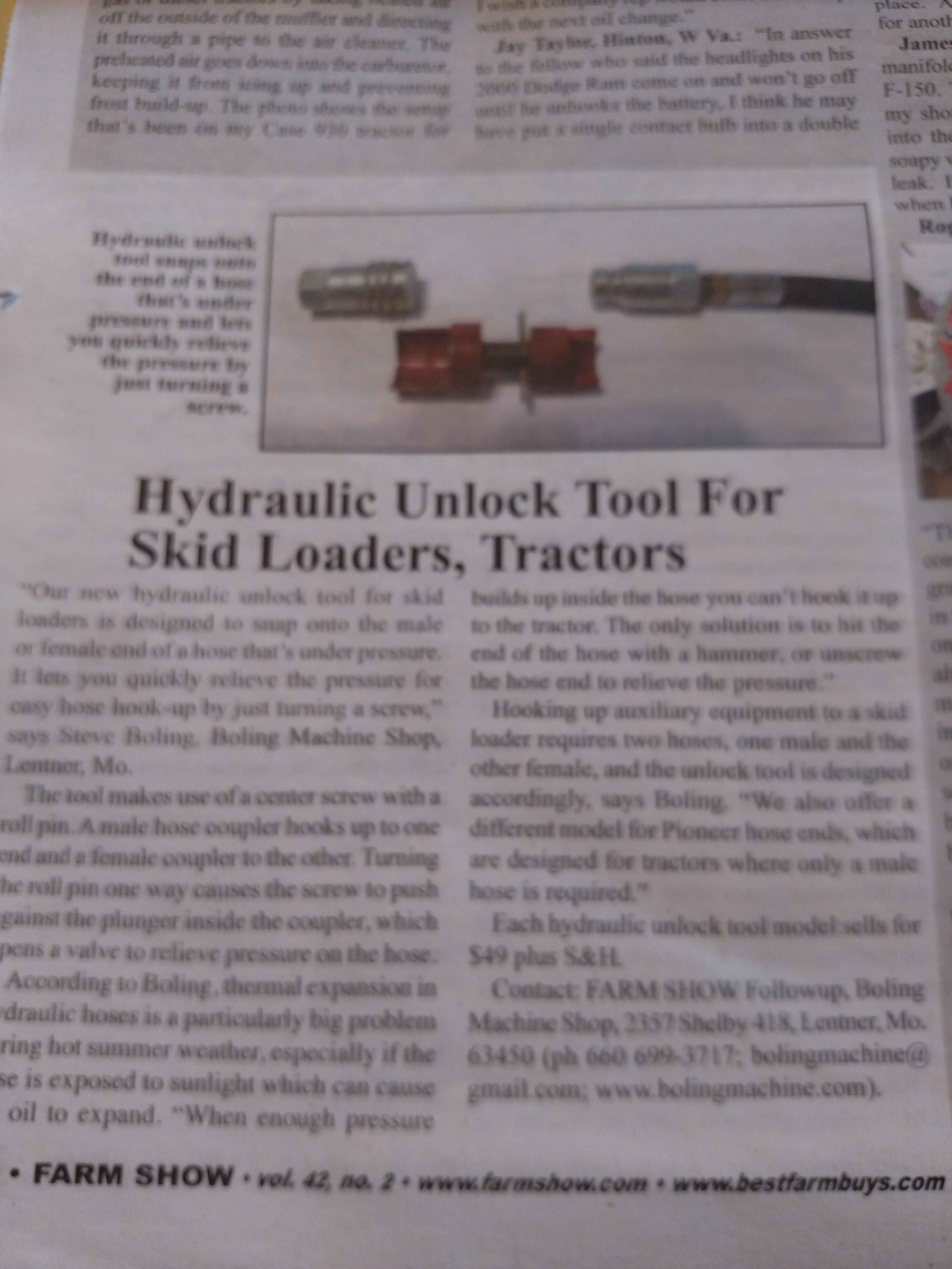

I just received my current issue of Farm Show and it had this article in it on hydraulic connectors and a tool to relieve the pressure on them;
It looks like it may be hard to read here is a link to the tool;
Boling Machine

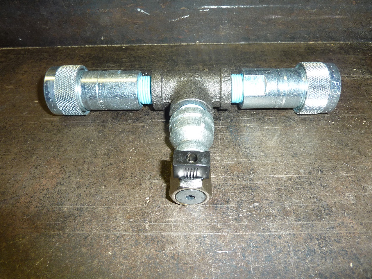

I've had this issue for many years. I've tried all the remedies suggested in this thread with little or no result. For me, the problem is always with the implement connectors since the tractor side is easily depressurized using the methods previously described.
The first thing I did was dump the SS flat faced couplers and replace them with the Pioneer Ag style. I use female connectors on the tractors and the cheaper male on the implements. If necessary, the pressure can be relieved by tapping the ball in the connector end on a clean hard surface and releasing some oil.
For implements that are prone to pressure binding from cylinder creep, I use a simple manifold and keep the hose ends connected to it while in storage:
The simplest, cheapest but less glamorous way to prevent implement pressure binding is to use the open ended male Pioneer style Ag connectors without the ball check valve. When not in use, put the connector end in a heavy duty zip top sandwich bag and hold it in place with a rubber band. First, hold the bag open under the connector when breaking the connection to catch the leaking oil. When reconnecting, remove the bag, zip it closed with the leaked oil inside and toss it in the trash or burn barrel.
