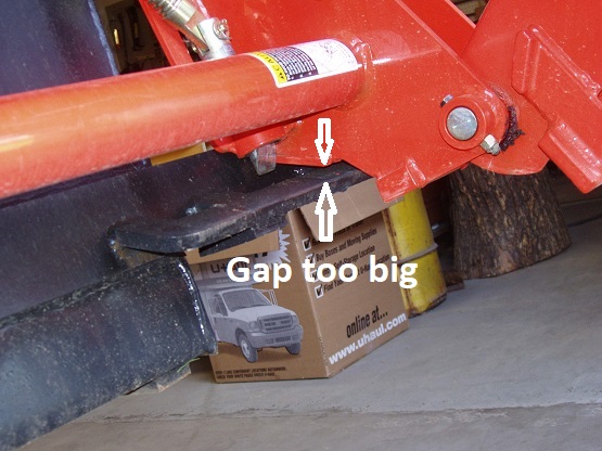

Actually the cause is just starting to be discussed. Vertical slack.
   / SSQ Bucket falls off #103
This is the vertical slack or gap at the bottom that the guys are talking about:

There are actually two questions in play,
First, how to keep the bucket on. My vote is for what another member said, put a bolt through the bucket and ssqa plate. Done.
Second, what changed to cause the problem. That requires a diagnostic sequence that we are really just getting started on.

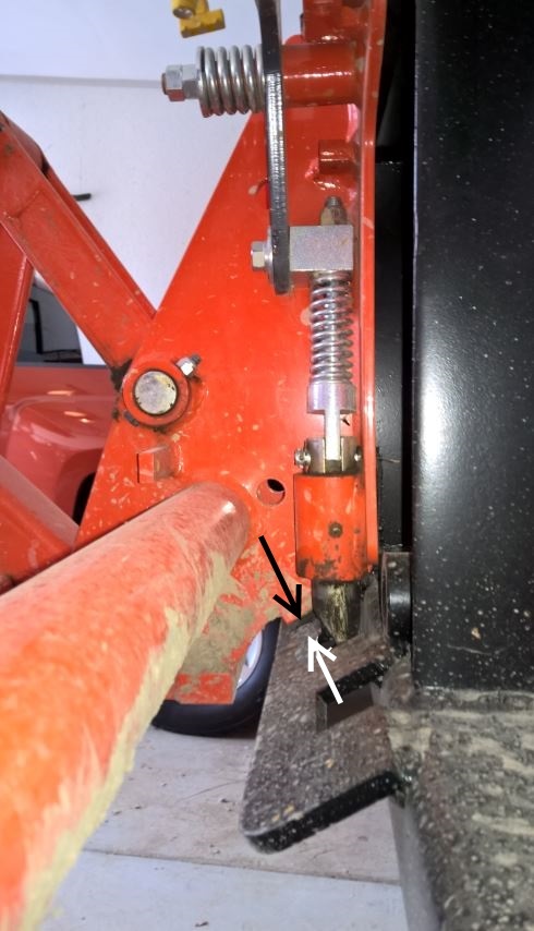

I agree Pat.
X clearly pointed out the problem with his last pics.

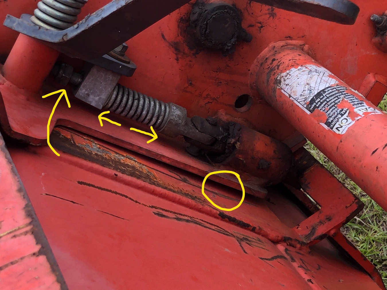

Looks like you have a couple issues going on that need to be addressed. In this pic the first thing you need to do is lift the bucket up and roll it back to were the buck weight is hanging on the upper lip and not the pins, then see if the pads BOTH seat against the back of the bucket or one or both have a gap. Like you have circled in this pic. IMG_1052.jpg
Then once both pads are seating flat, then you can focus on the lower flange gap we’re the pin notch is. You more than likely will need some new material added to fill the gap. After that is fitting tightly you can work on the locking pin engagement.

The gap shown between the back of the bucket and the ssqa plate is a problem that needs to be diagnosed and understood.
If this side has a gap, and the other side is tight, that suggests xfaxman is correct and the connecting tube is twisted.
If both sides show the same gap, that suggests the upper angled part of the ssqa is not fitting correctly into the angled part of the bucket. One or the other could be bent.
Or, you need to juggle the bucket on the ssqa before inserting the pins to make sure the back of the bucket and the ssqa plate are tight on both sides.
Maybe borrow a bucket or other ssqa attachment from a neighbor and see if the problem stays the same or goes away.
After as many accidental disconnects as described there is virtually not way the connecting timing rod can not be out of line, making one connecting plates not meet up to the connecting pin hole. It's been mentioned many times. Those plates have to be against each other with no space between them for the pin to fully seat.
You can weld all the plate you can imagine, but without proper alignment the problem will continue, because the pin is only partially engaged in the hole it belong in.
